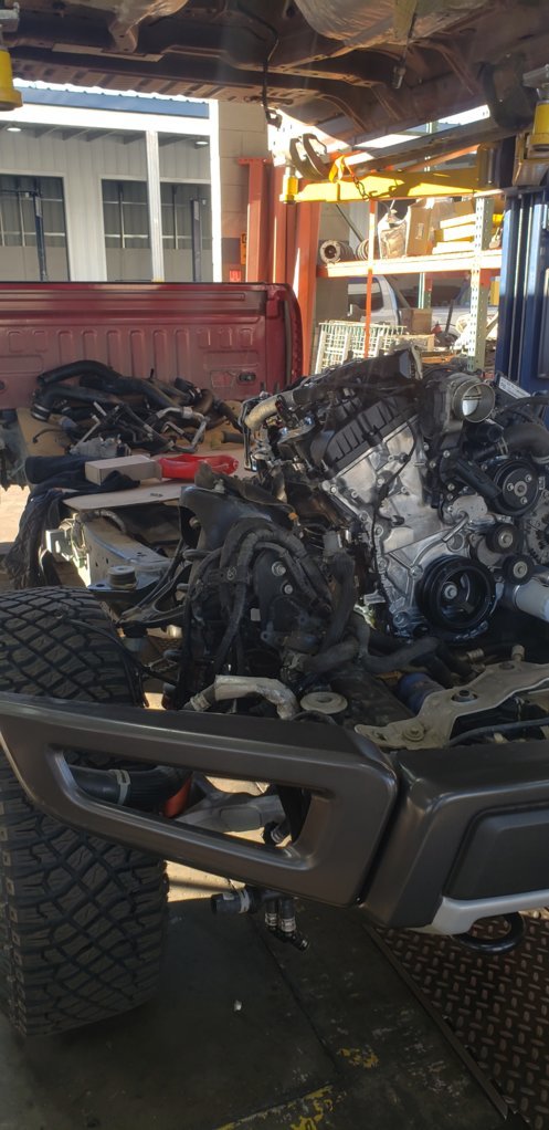

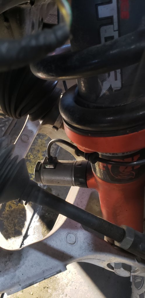

    I wonder if using the Ford Diagnostic Software if I'm able to get in there and change some stuff around.. its just abunch of 01010101's and servos that make up the system right?
    Currently putting in a fresh new long block and this one happens to have the Live System..

    theres a ton of differences (and possibilities) in the software side especially, but the valve itself is basically the same. As I understand it, and from what I have seen, there are some shocks out there running a valve on each external bypass, meaning multiple valves per shock and multiple possible settings for each bypass at basically any point in time. idk if this is an R&D thing from Fox or a private setup.
    the OEM application includes internal bypasses (twin-tube type which I think Fox has the patent on still?) and its really more like a spool valve in the place of a traditional clicker secondary valving set, and this basically acts as an adjustable needle style internal bypass as it can rapidly change the secondary valving during a heave event, not just changing the overall curve for the session like a traditional clicker. And while I don't have a raptor, I understand the OEM software side of things typically sets the valve to behave according to their specific terrain setting, not as aggressively trying to emulate a true external bypass shock like the SDI software does (or thats my take at east)
    my own setup at this point is just 3.1 live valve shocks + the SDI controller. I did build my own circuit initially, before the SDI unit was available, but that really only let me run full soft or full stiff, and unreliably ???? in between, more like an electronic clicker. The SDI unit uses an accelerometer to make corrections, but also has the terrain pre-set behaviors, but allows more user configurations than I guess ford does

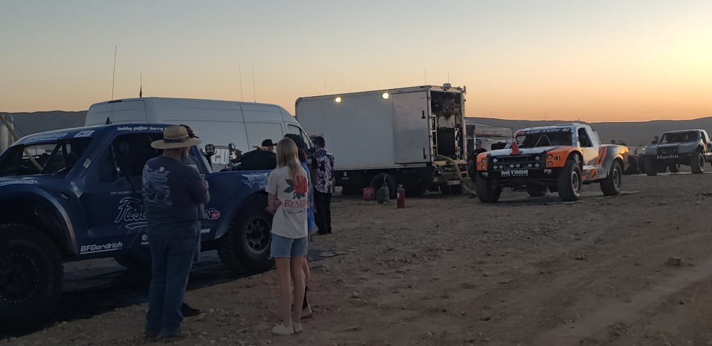

    The Jimco AWD TT that Robmac was driving for a short little bit..had the Fox Live System and Lofton's Mason AWD TT behind the Jimco. Both are AWD but have completely different handling characteristics.
