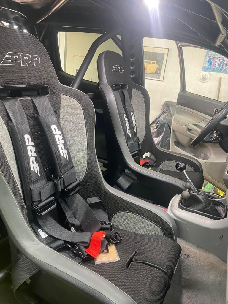

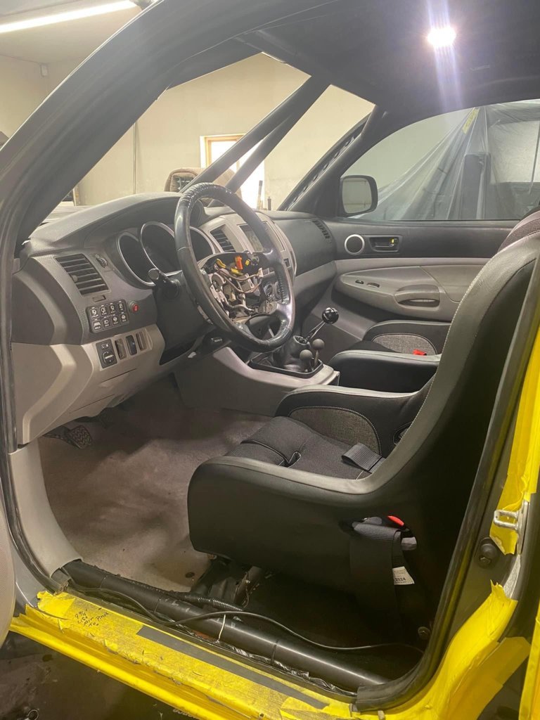

    Solid mounted to the cage. Too much potential of a slider failing in a bad situation for my liking. I spent many hours sitting in different positions before finding one I like. They are as low as you can possibly put a seat and I have zero regrets as it made head clearance a “zero concern”.

    Perfect. Thats the direction i was leaning. I actually really like the lower seating position of the stock seats. Never understood these seat raisers everyone is using. The upper portion of my cage is going on the outside of the truck, so i wont have the head-meet-tube concern, but i do have some abnormally tall friends who will appreciate it staying low.
    Do you recall roughly how much higher your front mounts are than your rear? Or do they get the mounting points pretty well leveled for a good starting position? Did you use their fixed position side mounts and tab to those or did you just make tour own brackets completely? Family life is a bit busy at the moment, so im trying to expedite my "figuring thigs out" time where possible by getting a good baseline position to start from.

    Pretty close to if not level with the floor. At this height you’re sitting lower than a factory seat which I find to be far more comfortable than a tall seat that pressure points your hamstrings on longer drives. Wife and I both can handle being in my truck longer than her off-road with stock seats. The comfort difference is incomprehensible.

    Thanks for the photos, they look like a great fit. Am i looking at building a new center console as well, or were you jus not done reassembling in those photos?

    I cut my console for 3rd seat passenger leg room.
