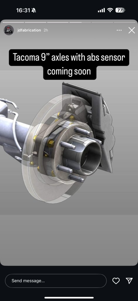

    Neat!
    Naveronski, YotaFAB and TWTaco like this.
  11. Dec 4, 2024 at 3:36 PM
    TWTaco
    TWTaco Well-Known Member
    Dec 19, 2015
    #172601
    5,970
    Dave
    :drool:
    Next! :spending:
