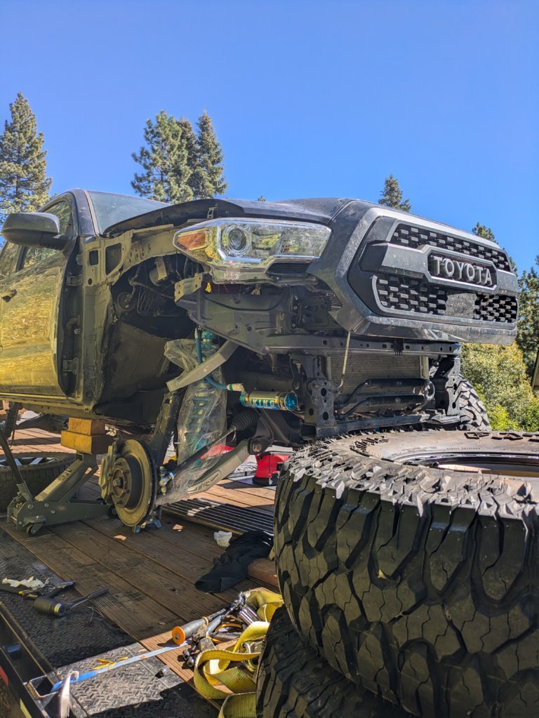

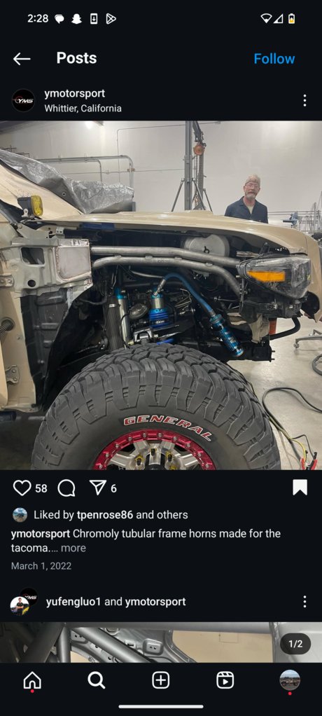

    Picture dropped in original post. Keep in mind I have an engine cage. But it wouldn’t take much to tube from the cab forward.
    My actual core support portion comes in at 8lbs. Which is about 1/3 the weight of factory but has 10x the strength.

    My core support is 1x.050 4130.
    core support is where all issues will originate in the sheet metal. Personally I would do something like JD fab inners or similar and tie in a tubular support

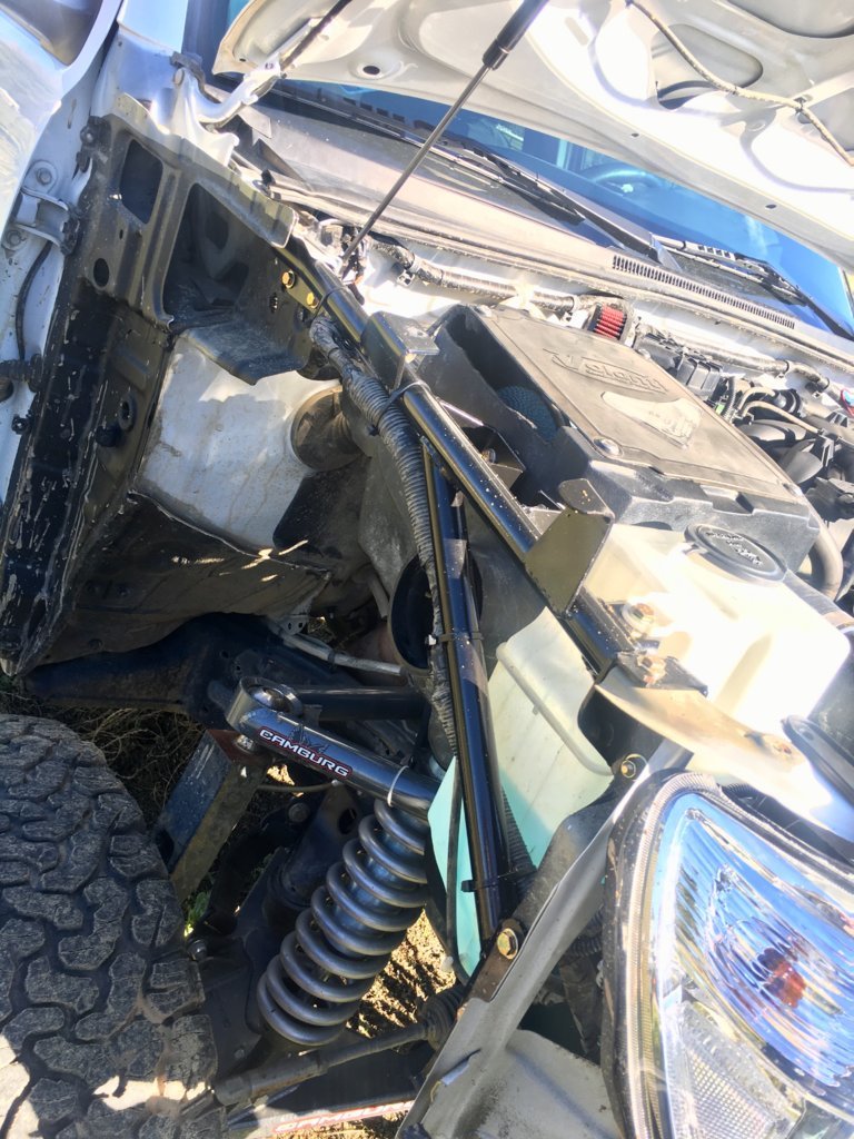

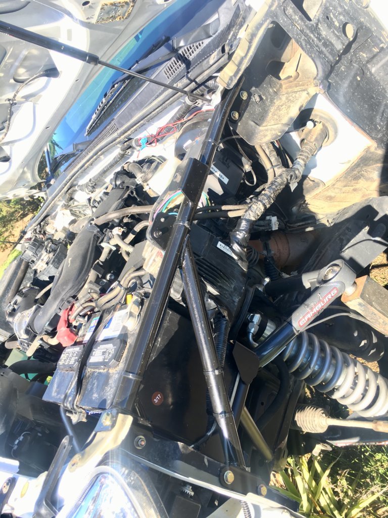

    this is what I have. I’d like to fully re-do it when I cab cage and engine cage eventually, but this has worked for about 5 years good.
  5. Dec 9, 2024 at 10:07 PM
    SoonToBeOn39s
    SoonToBeOn39s Well-Known Member
    Mar 20, 2022
    #393038
    1,832
    I finally got bigger tires 2020 Long Travel Tacoma 1997 MAGNUM
    That's what I want! Any issues with the fuse box being "exposed"

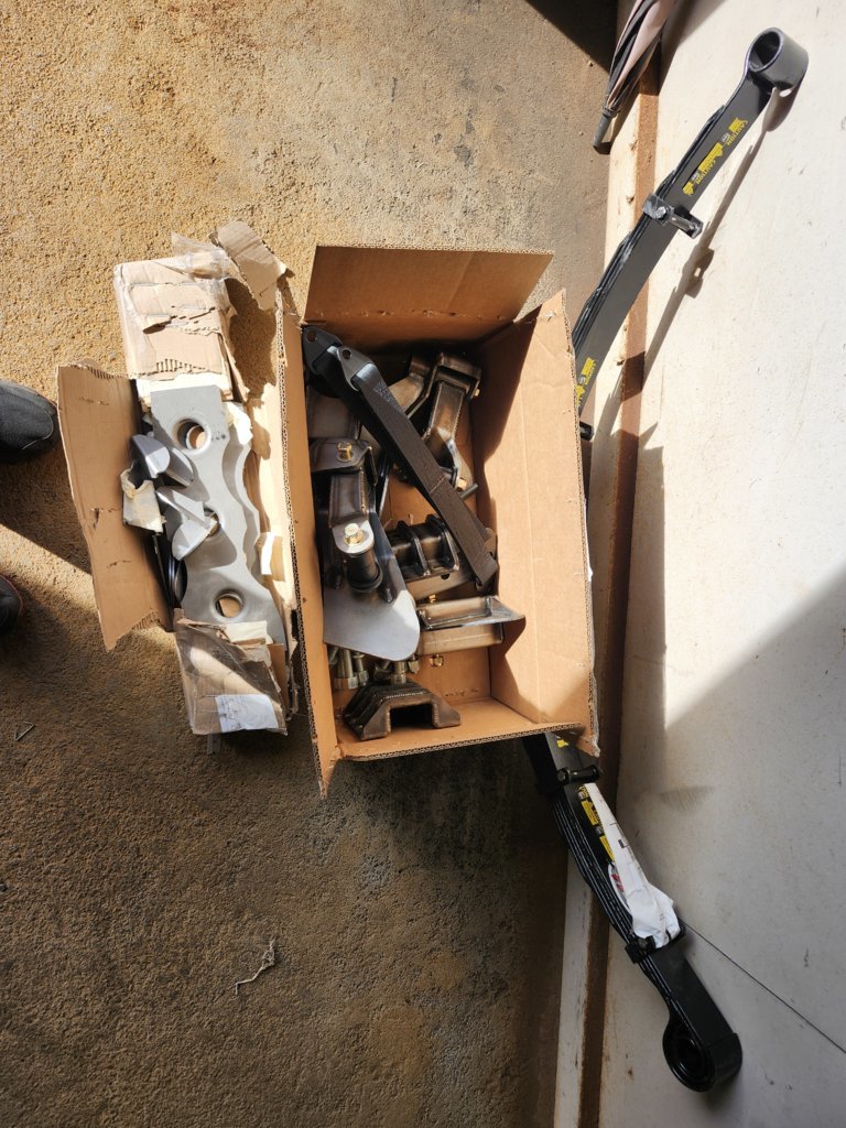

  20. Dec 10, 2024 at 11:18 AM
    TWTaco
    TWTaco Well-Known Member
    Dec 19, 2015
    #172601
    5,970
    Dave
    Joe posted this teaser on another thread. I seen it in person and it looks great much much stronger then that OEM thin sheet metal core support. Once it's ready for production I will be adding it.
