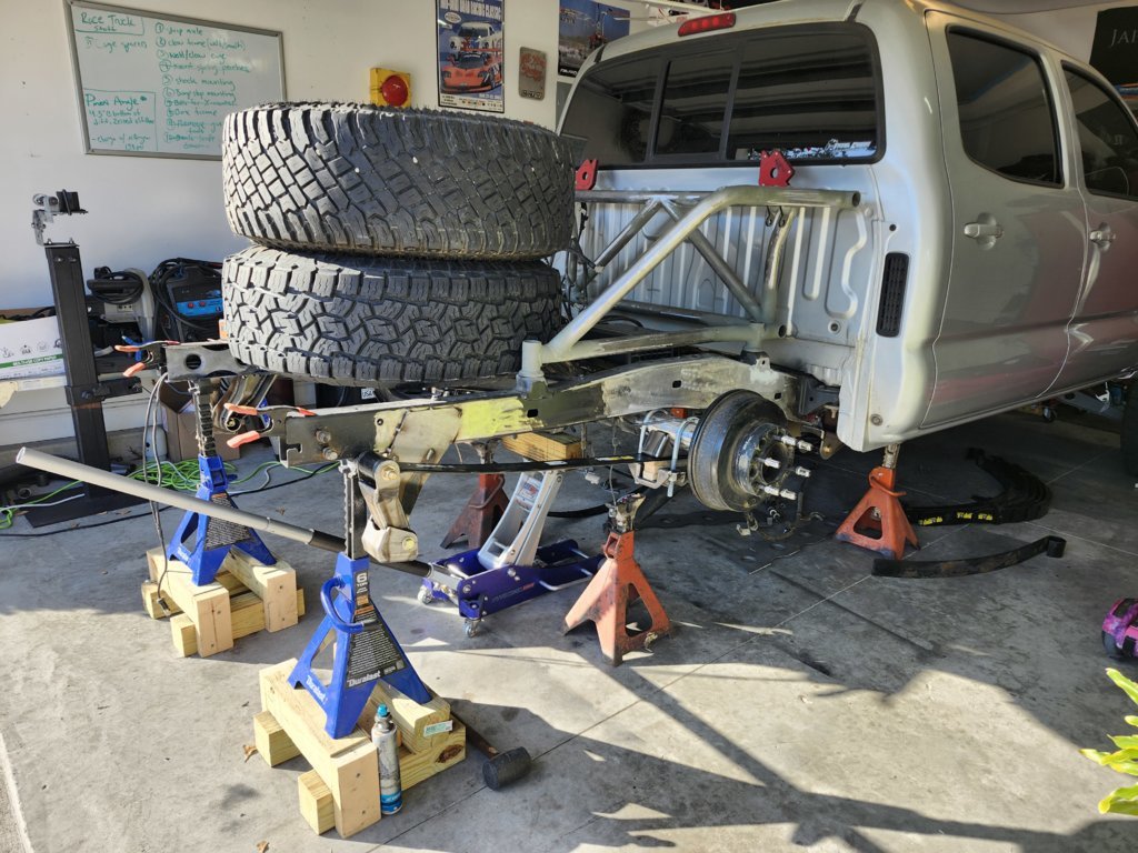

    Let's talk pinion angles. What did you guys measure at ride height?
    I took ride height measurements before tearing everything apart but cannot for the life of me find the paper I wrote them down on. Installing a JD SUA kit with the frame brace. Currently have the leafs torn apart to cycle.

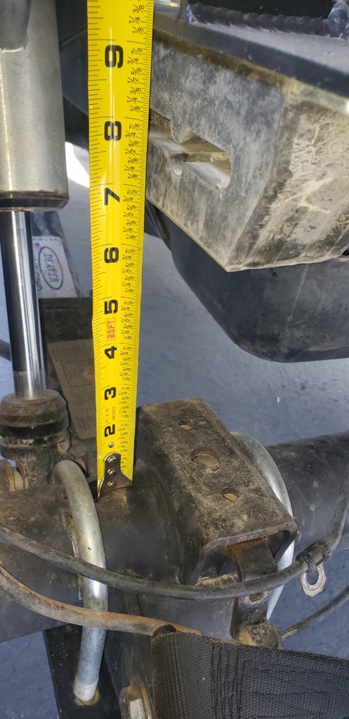

    What did you use? I’m guessing something consistent so I can measure on my truck.
    Top of axle housing to bottom of frame?

    The degree is relative to the front section of the driveshaft (and or transmission output) at ride height. So unfortunately it depends on exactly the height your truck is gonna sit at with your leaf pack and your setup. The before measurement actually doesn't even matter anymore. It's good to know for reference but the measurement with your current setup is the one you need. If you wanna get it right, weight and setup variances will be too much to copy someone else even with the same leafs. On the other hand the pinion angle can be set after cycling and checking clearance. If it all fits and cycles correctly, it's still going to fit with the pinion a few degrees up or down. Just leave the perches and everything tacked but not fully welded until you can set it down at full weight with leafs assembled - then come back and adjust the perches and fully weld them. Might take a couple tries to rotate it the correct amount but it's not much extra work to do this and weld it all last. Since it will affect the shock perch's location if you do it this way, you'll need to get your measurement for it's location relative to another part on the truck so that you can adjust it the correct amount when rotating the axle. IE: know where your shock mount hole is at 12in droop to the frame rail when it's set correctly so your shock doesn't hit and then you'll be able to jack the axle back to that height to make sure it still has proper clearance after you've assembled the leafs and rotated the axle and perches to get the pinion angle right. Also know where they land horizontally relative to the brake drum backing or something so they don't accidentally get pushed left or right too much when adjusting the pinion angle

    Top of axle to bottom of frame is 7.5 inches

    Is that measurement with your dmz kit?

    This is with 2 full size spares and pair of spare spindles bolted down to the back side of the tire carrier. The rear shackle hanger is all the way forward and set at the lower hole.
