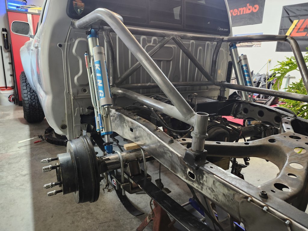

    This sound right?

    So i got 14.5 inches of shock shaft showing (including black bumper) at full droop, and left an inch at full bump. Is this a good scenario?
    Got 7.5 inches of shaft at ride height, which puts it right in the middle

    Correct me if im wrong, but I stopped by a race prep shop and they told me they like to set it where both the bump stop, and the shock bottoms out at the same time to spread out the stress of impact. Just relaying the message :D

    I get that, but with my motion ratio I'm at now the spring hangers mechanically are maxed out/or axles touching frame before the shock is in danger either way

    Bypass piston fully past the last tube on compression ?
    Having an inch at bump isn’t bad, as that leaves room for the bump pad to wear and frame flex or even if the pad sheared off.

    Yeah piston is in the bump zone full compression and past rebound tube full droop

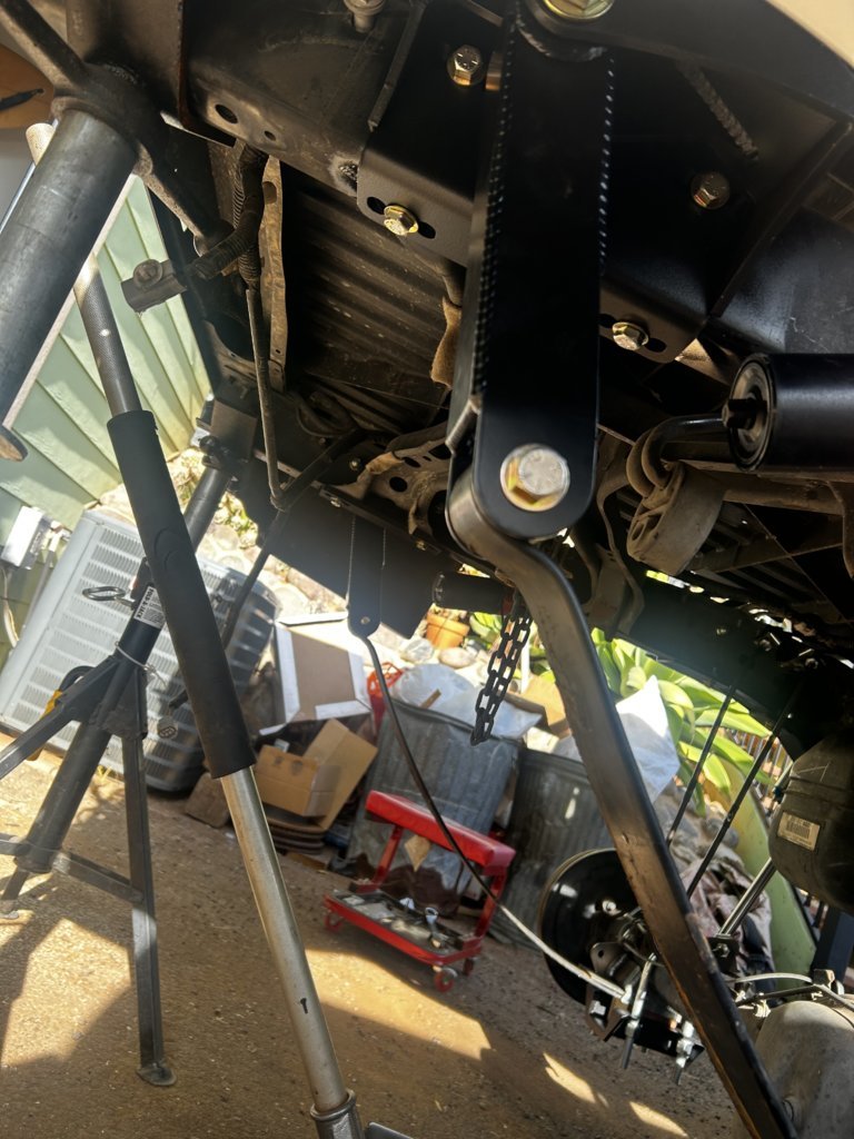

    So here’s where I’m at with my install.
    Using a 3.0x14” with the under the bed shock towers. I’m showing 13” of shock travel from full bump to droop. The shock currently bottoms out before the bumps but there’s a little wiggle room with the towers. Not a lot though.
    The shackles are beyond 90° at full droop, but not sure if this is a concern being the kit moves away from inverted shackles.
    IvanhoeTaco and Sterling_vH111 like this.
  16. Dec 26, 2024 at 5:07 PM
    MonkeyProof
    MonkeyProof Power Top
    Oct 7, 2008
    #9774
    12,822
    SoCal- SGV
    You have more total shock shaft showing than my setup, that will be addressed after when the front gets dialed.. The shackle angle is pretty much identical to mine. Watch the Drive Shaft Slip Yoke plunge length, it decrease as it droops. I have my Limit Straps set just for that.
    Edit: you have the Hanger in the Middle Position whereas mine is all the way forward.
  17. Dec 26, 2024 at 5:34 PM
    desertjunkie760
    desertjunkie760 @DesertJunkie760 (IG)
    Apr 11, 2016
    #183963
    9,144
    Shane
    2011 MGM DCSB TRD Sport 4x4
    Check My Sig.
    That is correct. Is there a specific reason you went with the forward most position?
  18. Dec 26, 2024 at 6:05 PM
    MonkeyProof
    Oct 7, 2008
    #9774
    12,822
    SoCal- SGV
    Mostly for the "Softer" Spring Rate Ratio and some for the ride height.
    Sidenote: My Ride Height is setup for when I have all of my crap loaded up for a trip because I carry a lot of it. There's a few adjustments with the design of the JD SUA that can be made to accommodate Leaf Spring Rate and Ride Height. That was one of the leading reasons why I chose the JD Kit.
    Theres two 5 Gallon Fuel Cans and a 6 Gallon Water Jug all the forward in the bed plus everything else. Not too tall or too low which keeps the Shafts in the right zones
  19. Dec 26, 2024 at 6:16 PM
    not_nick
    not_nick Well-Known Member
    Sep 20, 2017
    #230574
    1,889
    keeping jersey dirty
    Is there slack in the brake lines? They look really tight in the pic
  20. Dec 26, 2024 at 6:22 PM
    desertjunkie760
    Apr 11, 2016
    #183963
    9,144
    Shane
    Check My Sig.
    there is but not a lot.
