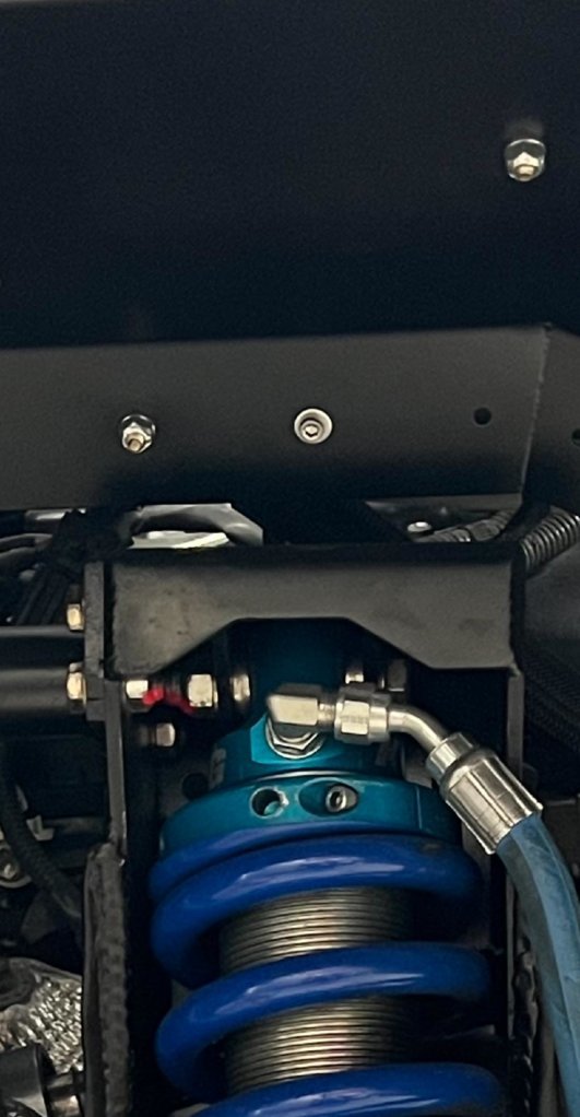

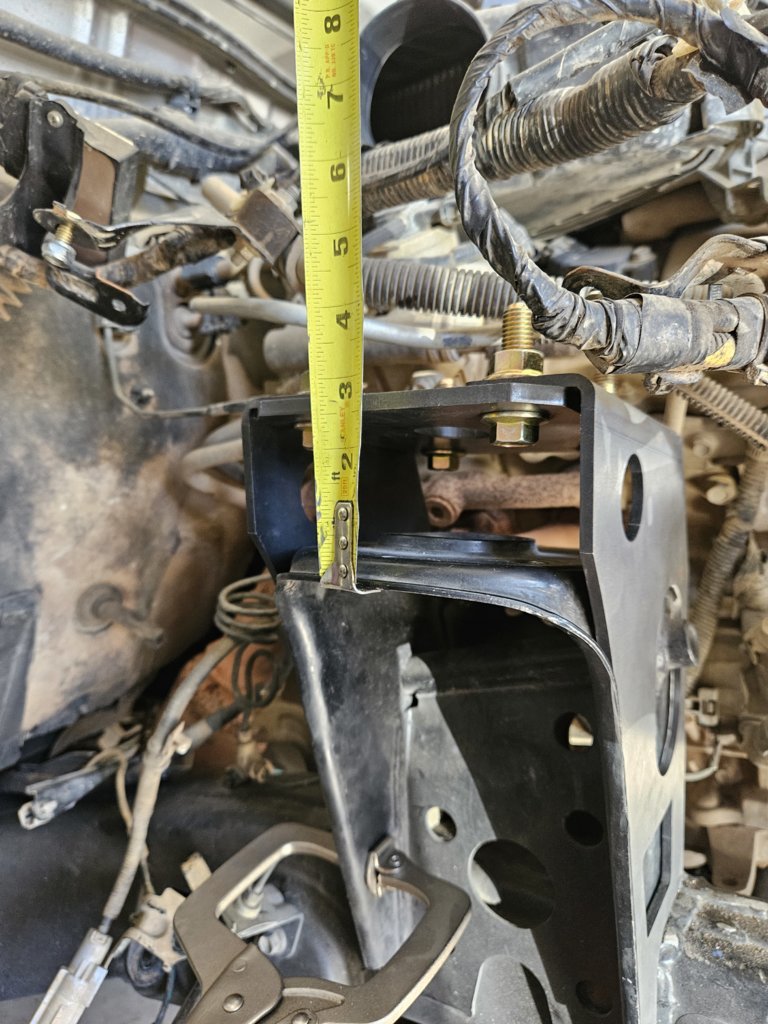

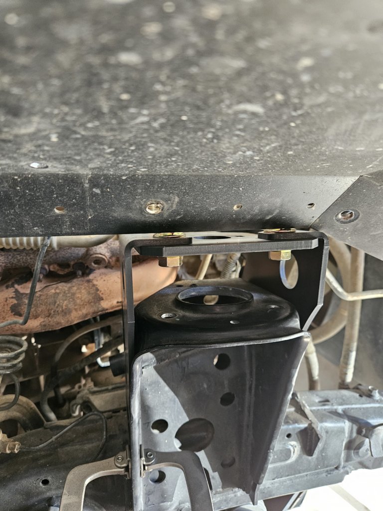

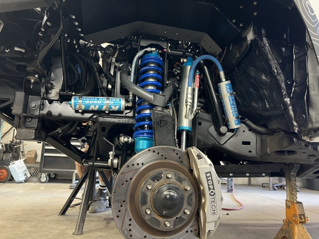

    Are those JD towers? Mine are JD and installed by JD it could be an illusion but i look like i have little more room in the fender gap. Maybe a 2nd gen to 3rd gen difference.

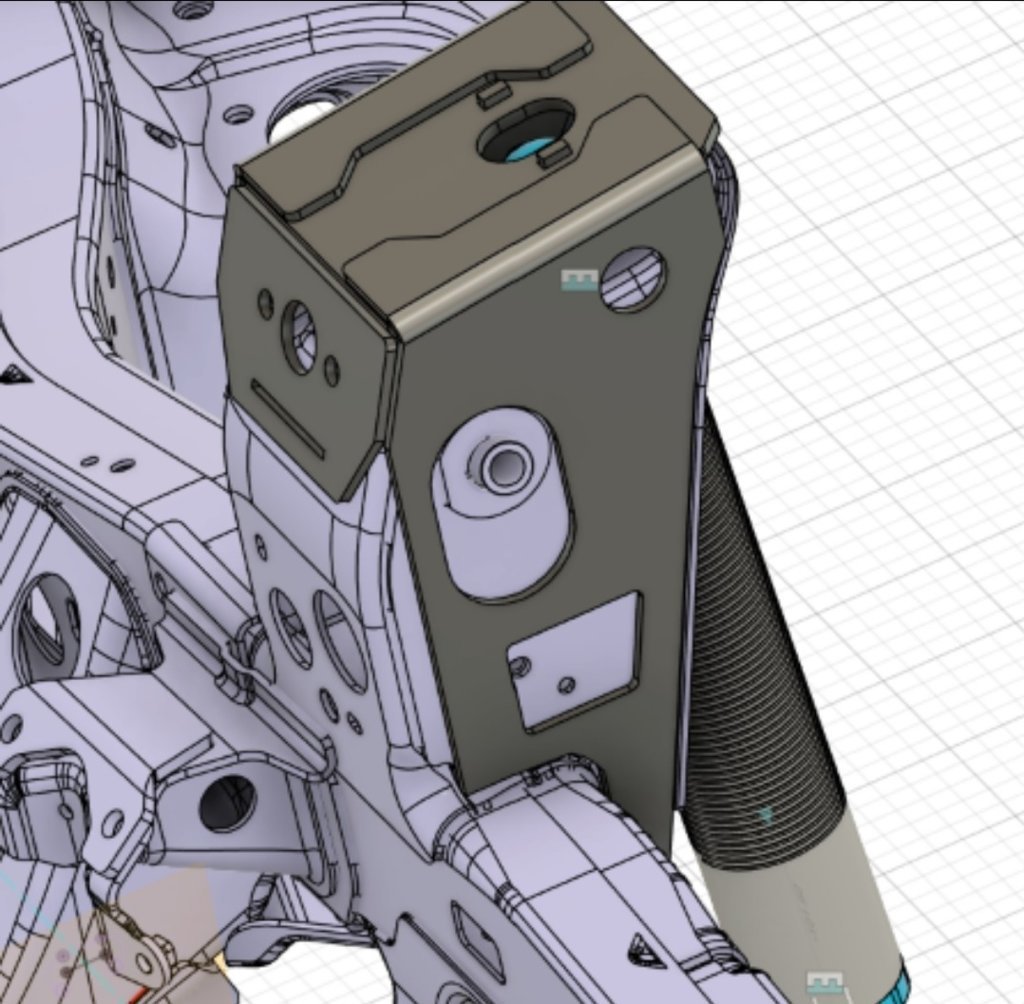

    No, I designed these for my setup.

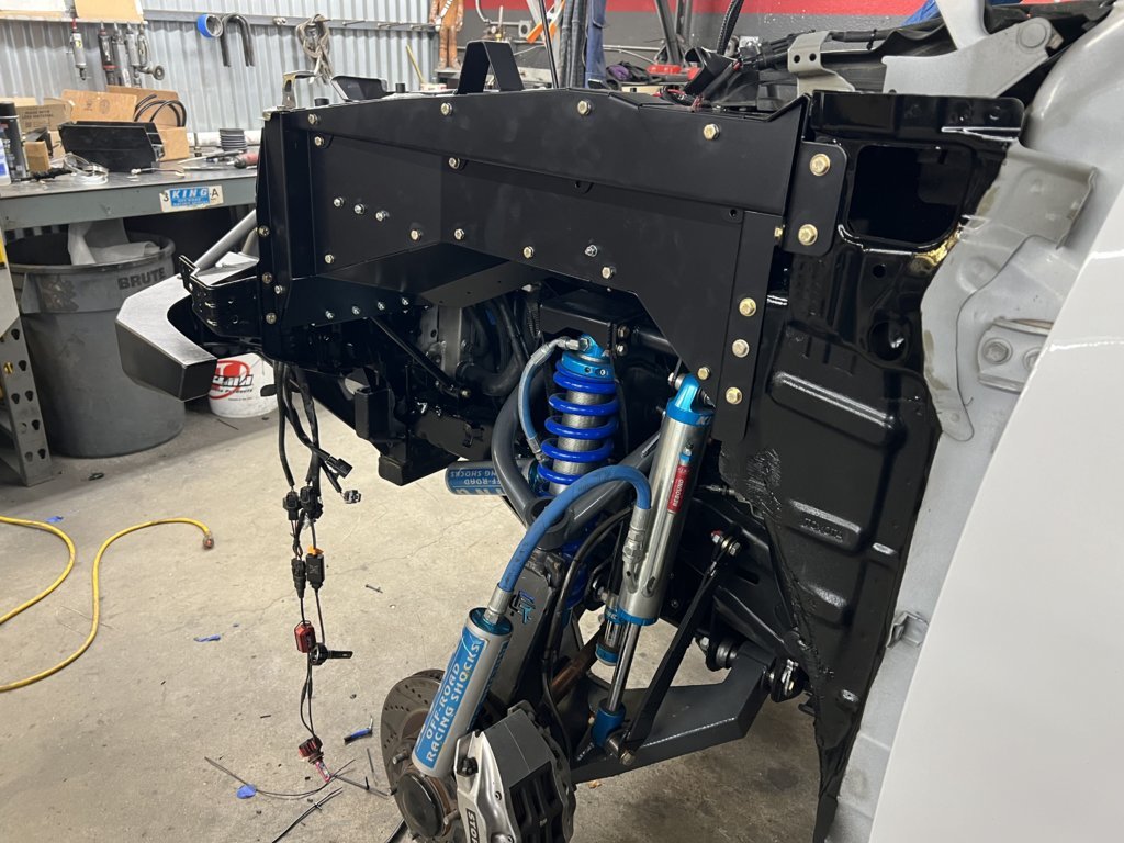

    This is JD's design here.

    I wanted to add this but it won't fit with the Magnuson SC.

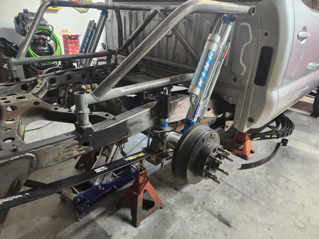

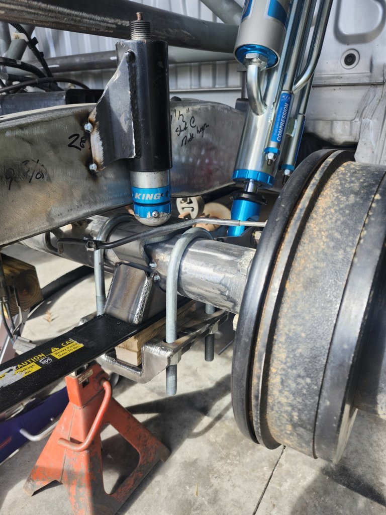

    16.5 inches of travel, moved bumps up higher.
    13° shock angle at full droop.
    14.5 inches of shock shaft showing full droop.
    I have no idea what's good and what's not other than I know it cycles appropriately.
    First time I've ever fabbed a suspension, let alone something that's going to get driven hard and fast and requires lots of travel to have that fun.

    to me it looks like that inner fender would be bashing on that tower all day long with body movement.

    Yep, that's why I'll be trimming ;) Goal was to maximize travel. I'll be trimming more for jounce as well.

    Go higher if you can. You got that rubber bump on the shaft that’s the same thickness as the plastic puck on the bump. So if that plastic grenades itself then you’re still safe. 1/4” gap at the u bolt is more than enough.
