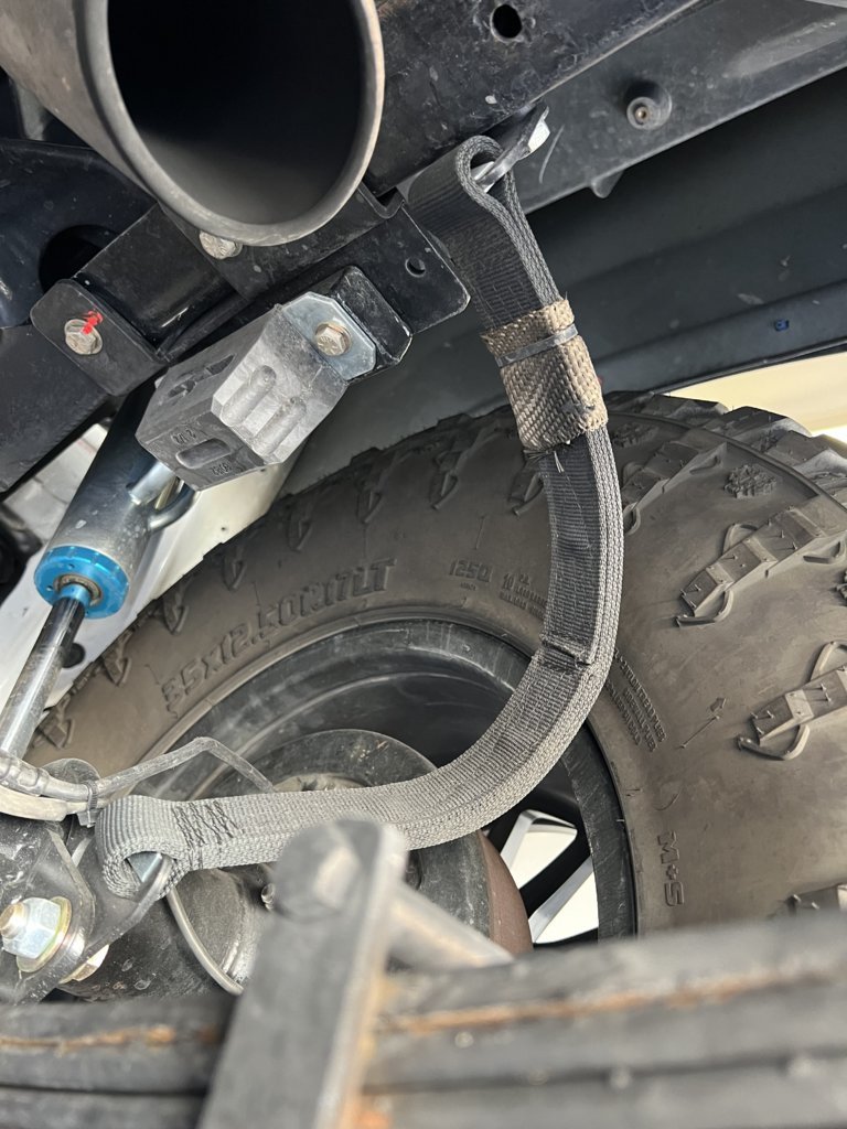

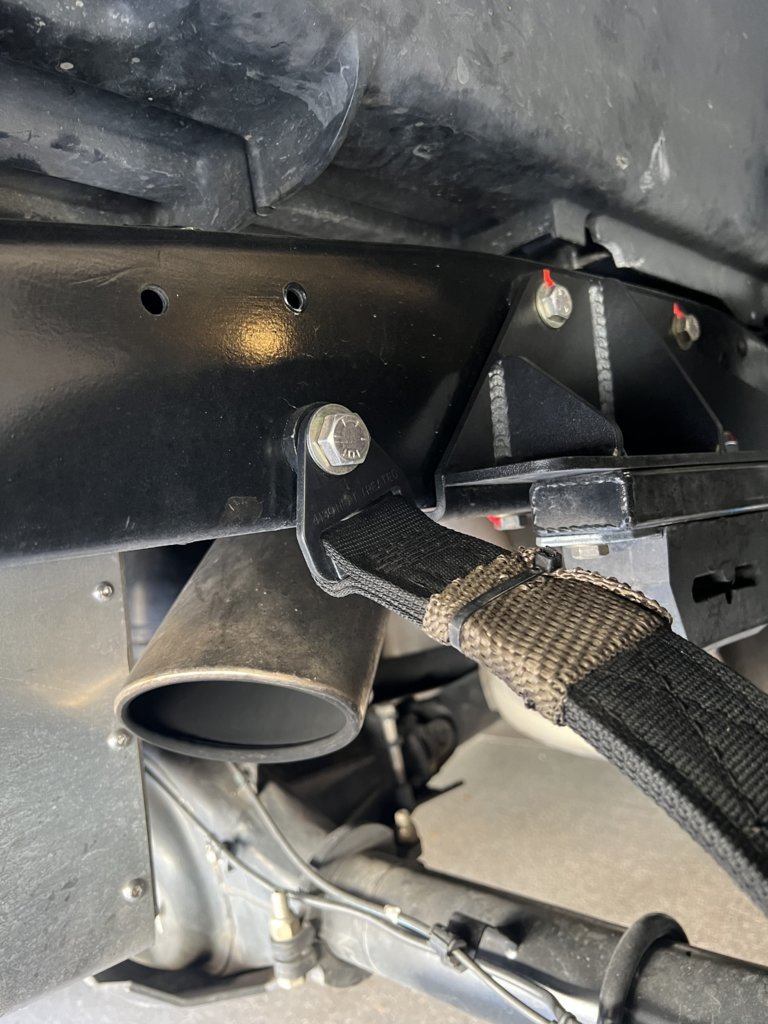

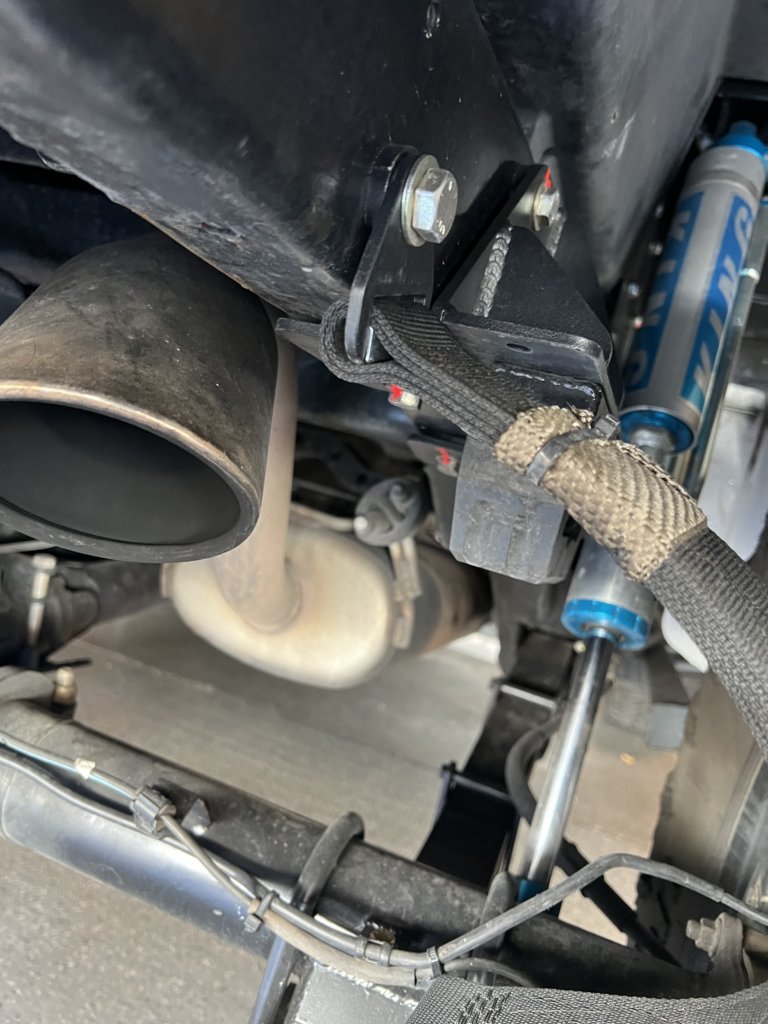

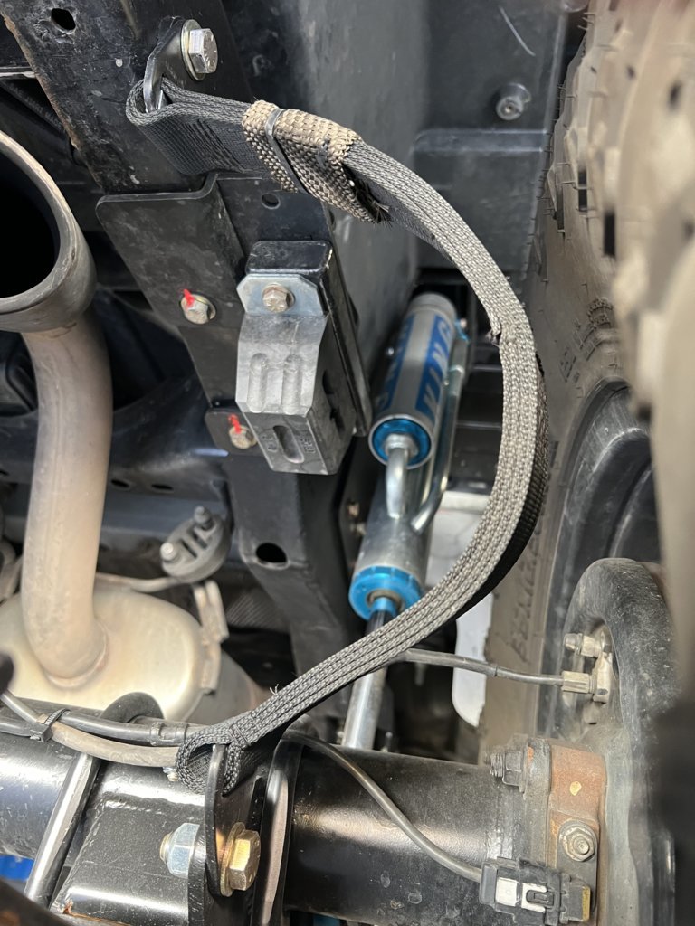

    Who’s mounted the limit straps on the JD kit? I see where the lower mount is integrated into the spring perch but where does the upper mount?
    Not seeing any mention of it in the instructions. Although the kit does offer a weld washer.

    Here’s some pics of mine JD installed.

    this is perfect, thank you
