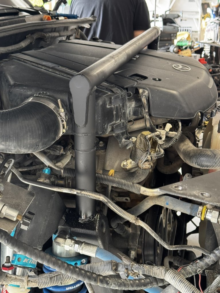

    Smart and strong method to attach tube at a 90°. Kudos. I would've never thought of the little end cap pieces.
    Also are your motor mounts solid lol?

  3. Jan 3, 2025 at 6:17 PM
    Airdog
    Airdog did your Mom
    Dec 26, 2012
    #93790
    4,889
    Tom
    SoCal
    https://www.tacomaworld.com/threads/airdogs-2012-prerunner-access-cab-slow-build.264263/
    yup solid motor and tranny mounts
    IvanhoeTaco[QUOTED] likes this.
  4. Jan 3, 2025 at 6:20 PM
    IvanhoeTaco
    IvanhoeTaco Well-Known Member
    Aug 4, 2019
    #301199
    2,942
    Eastern NC
    2005 Supercharged Converted Prerunner
    Total Chaos 3.5 LT, King Coilovers, 35x11.5r17 on Falcon T2, ADV 4 inch fiberglass, 4.88 gears, FJ cruiser transfer case, 4 runner front diff, Cab mount relocate, archive hangers, shackles, king 2.5x14 rear shocks, icon rxt leaf springs, king hydro bumps
    I guess being fully caged it makes no difference in vibes/noise...
  5. Jan 3, 2025 at 7:07 PM
    Airdog
    Airdog did your Mom
    Dec 26, 2012
    #93790
    4,889
    Tom
    SoCal
    I actually didnt notice any real change even before it was caged.
  6. Jan 4, 2025 at 5:10 AM
    906taco
    906taco Well-Known Member
    Jun 22, 2021
    #369289
    3,903
    Cory
    08 Taco
    That’s because they aren’t solid lol. I didn’t notice big NVH changes with mine either. Solid is a big time different game though.

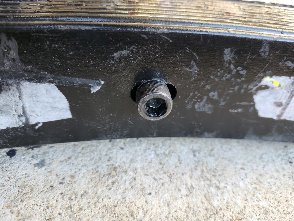

    One side of my axle appears to be 1/4 of an inch off front to back, is it worth elongating the hole in spring perch to get that back?
    Obviously if that hole is bigger than leaf pack pin there is a chance of shifting, although I would say not high once it's bolted up tight.
  8. Jan 4, 2025 at 5:40 AM
    906taco
    Jun 22, 2021
    #369289
    3,903
    Cory
    08 Taco
    Oh it’ll move. I constantly check the torque on mine and when I re built my setup I found my center holes were egged and center pins bent. There really is an incredible amount of force at that location. 10/10 wouldn’t recommend opening them up.

  9. Jan 4, 2025 at 5:48 AM
    IvanhoeTaco
    Aug 4, 2019
    #301199
    2,942
    Eastern NC
    20250104_084645.jpgfigured it out, pin was not centered/same as other side, top leaf is leaf with bushing eyelet so loosened pin and shifted it back.
  10. Jan 4, 2025 at 5:50 AM
    906taco
    Jun 22, 2021
    #369289
    3,903
    Cory
    08 Taco
    Interesting to see them flip to an Allen key bolt. That wasn’t the typical for Deaver. How snug is the fit in the perch?
  11. Jan 4, 2025 at 5:52 AM
    IvanhoeTaco
    Aug 4, 2019
    #301199
    2,942
    Eastern NC
    Slips on easily but no wiggle room

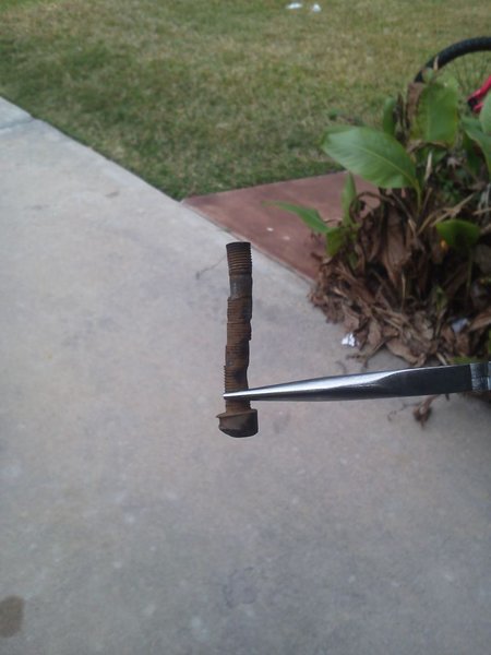

    colinb17
    colinb17 If at first you don't succeed, don't try skydiving
    Jan 6, 2008
    #4127
    20,162
    Colin
    Charleston, SC
    '07 TRD Sport 4x4
    Build thread in sig... 4-link long travel
    Learned a long time ago that even with proper torque and continual checking, leaf springs move. treat your center pins as a consumable item.
    Custom stepped pins like this are also difficult to remove from leaf packs, especially with dual wrapped ends.

    906taco
    Jun 22, 2021
    #369289
    3,903
    Cory
    08 Taco
    You will want to retorque several times during the first few hundred miles. It will all settle in. But make it a habit to check torque often.
    Yep. Pretty close to how mine looked as well. Dual pins wouldn’t do this. Singles, I don’t think it can be stopped.
