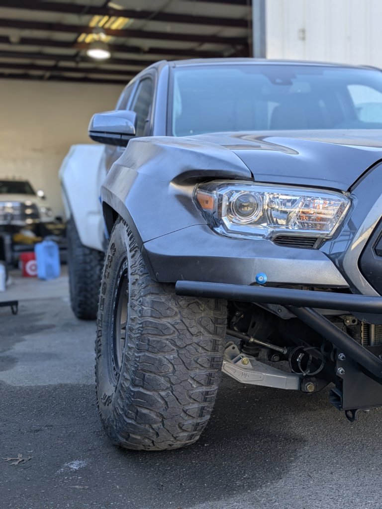

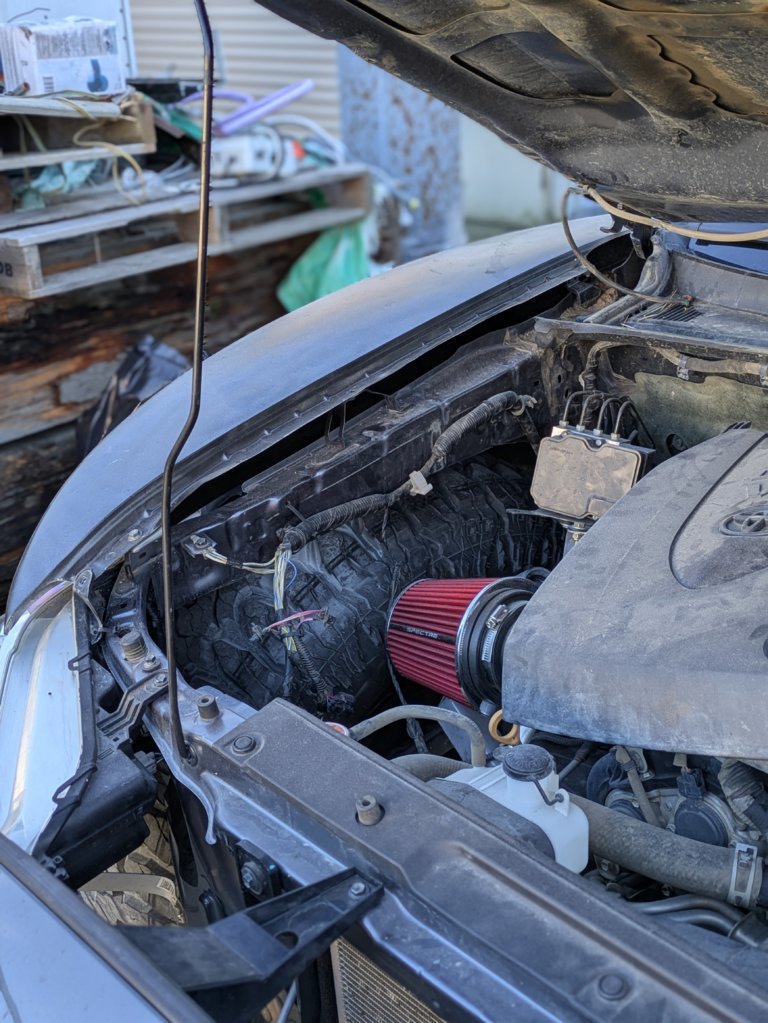

    I finally got bigger tires 2020 Long Travel Tacoma 1997 MAGNUM
    I'm going to have to trim a lot of my core support underneath the headlight area. Which I'm worried that it'll start tearing and crumpling over time. What did you do?

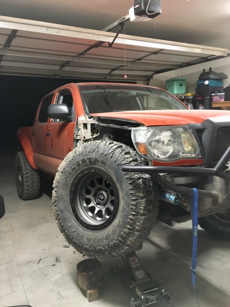

    Wont happen. You’re going to have to trim a lot either way, unless you limit up travel which is unacceptable IMO. Especially with a 38”.
    I had to trim my core support with a 35” and the JD pivots set forward two spacers.

    I already hit the front core support with 35’s and stock LCA mounts and 2wd spindles.

    I completely removed the inner fender and rebuild out of tube to tie into the core support. Only thing left is radiator and headlight support structure. And then rubbed into the firewall as far as I could before hitting wiring.
