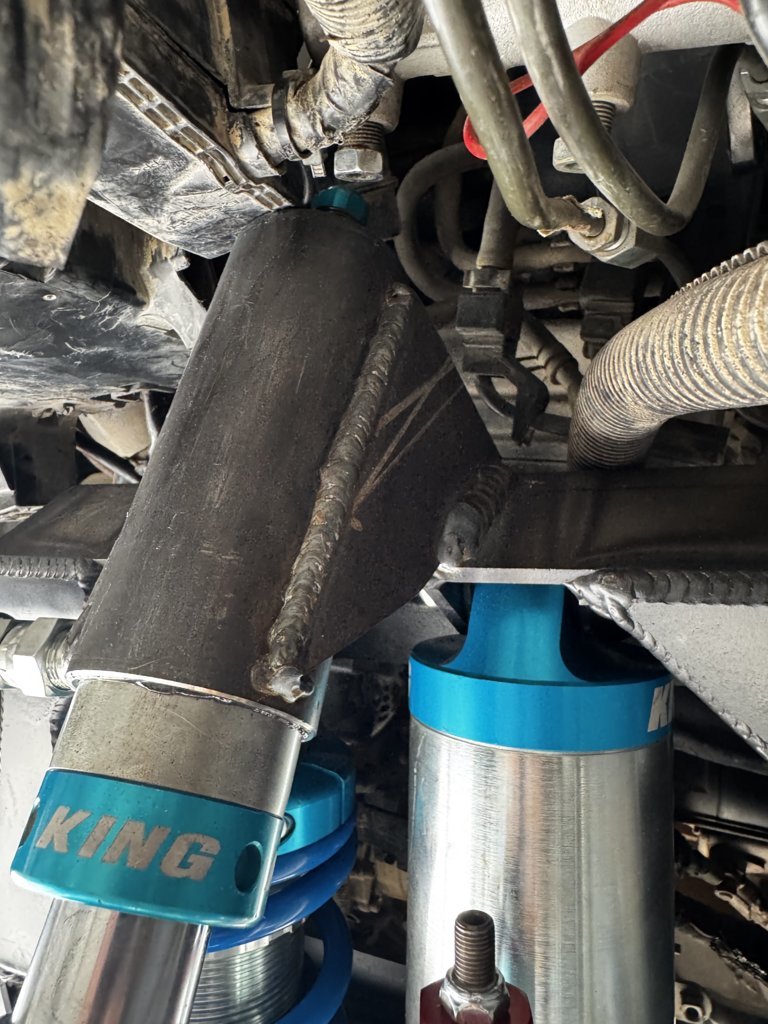

    Hey guys I got a question for anyone with 3 gen, BTF long travel. Just bought the kit and I’m waiting for it to come in. I wanted to know how many guys are running aftermarket bump stops. I got king 2.0 bump stops with just a regular can setup. I can’t seem to find how close I should weld that setup to the bump stop pad from the frame. Kinda looking for a cheat sheet. I’ve looked at a lot of pages on this thread but don’t have time to go through almost 5000 pages and won’t have a lot of time to do the full setup as it will be a daily driver. TIA.

    First you’re going to have to cut the stock bump pad shit off the frame if you plan to run a coil over/bypass shock with 2.0 bumps. Location will be based on where the LCA bump pad ends up when you cycle the suspension to full bump. Most likely you will have to fab up some plates to hold the bump can to the frame. On My setup those plates on the side of the bump cans were handmade for my install. IMG_0716.jpg
