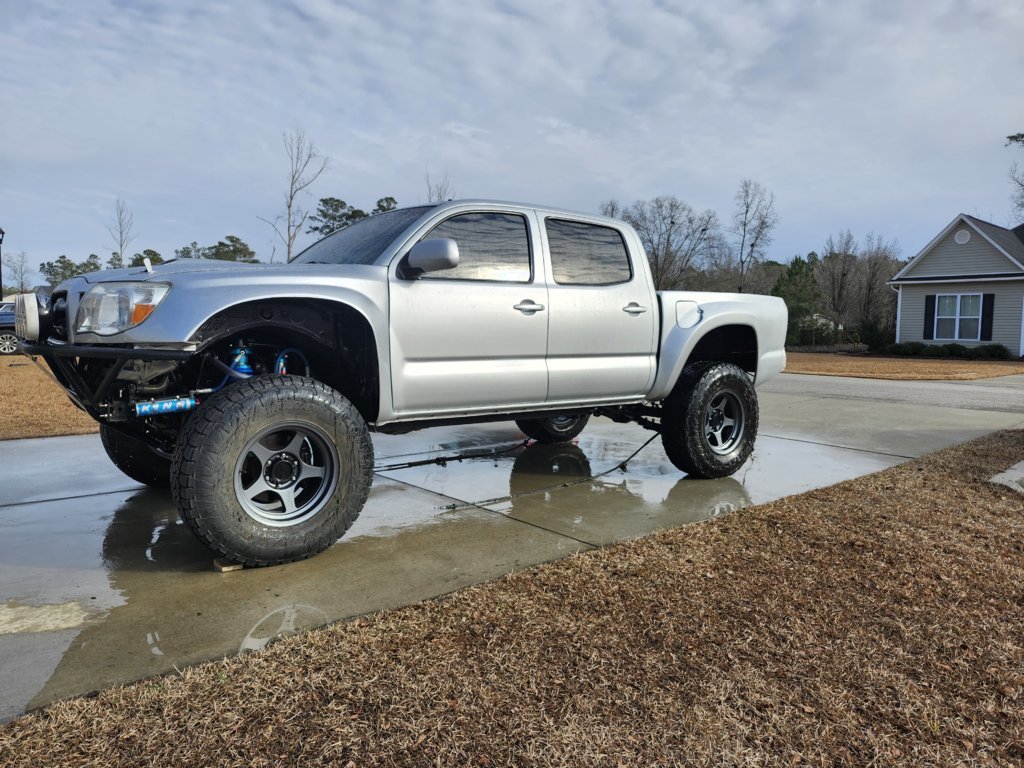

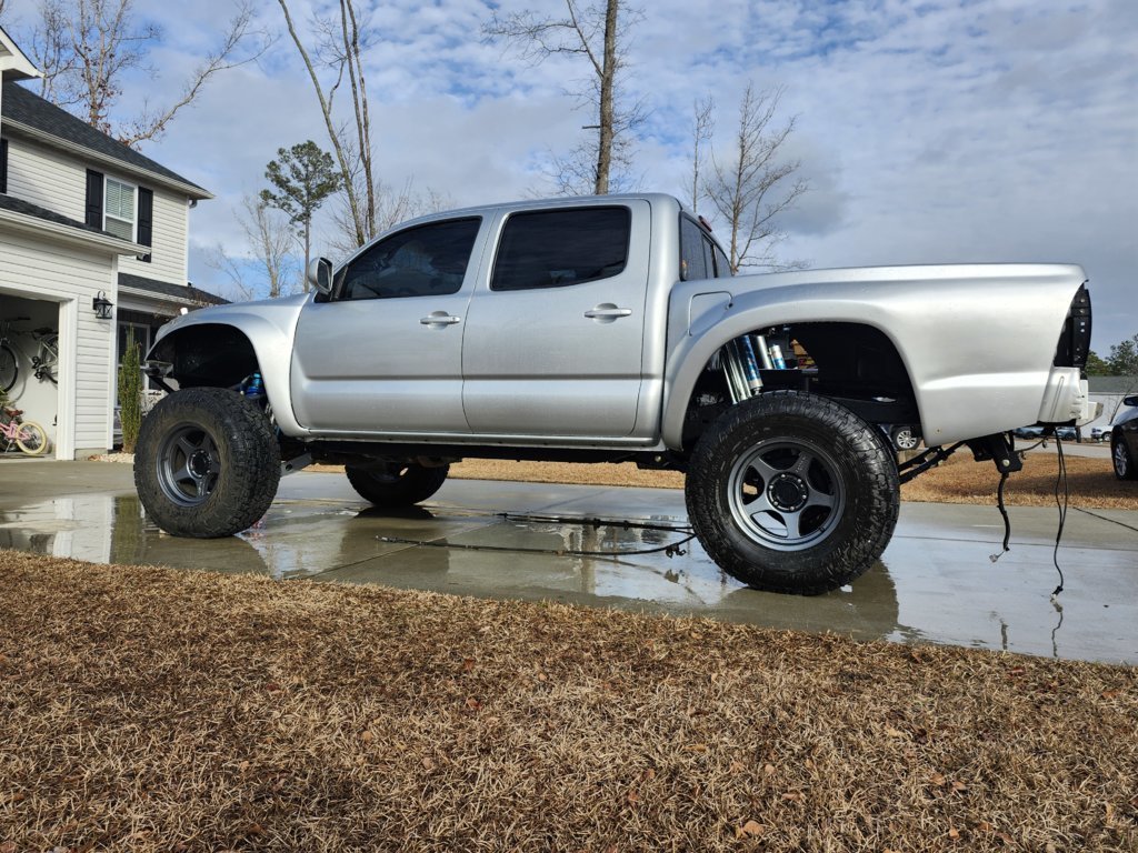

    I need new wheels. Thinking of bombing these wheels black

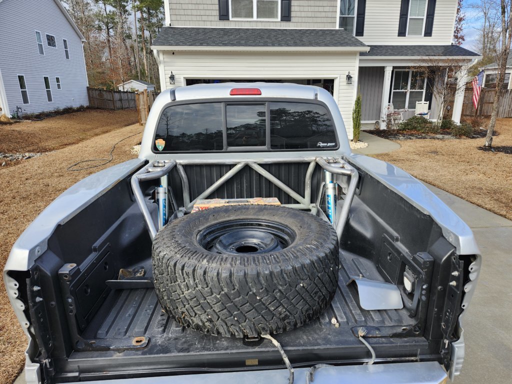

    Bed cage turned out good

    Yes I'm very happy with it

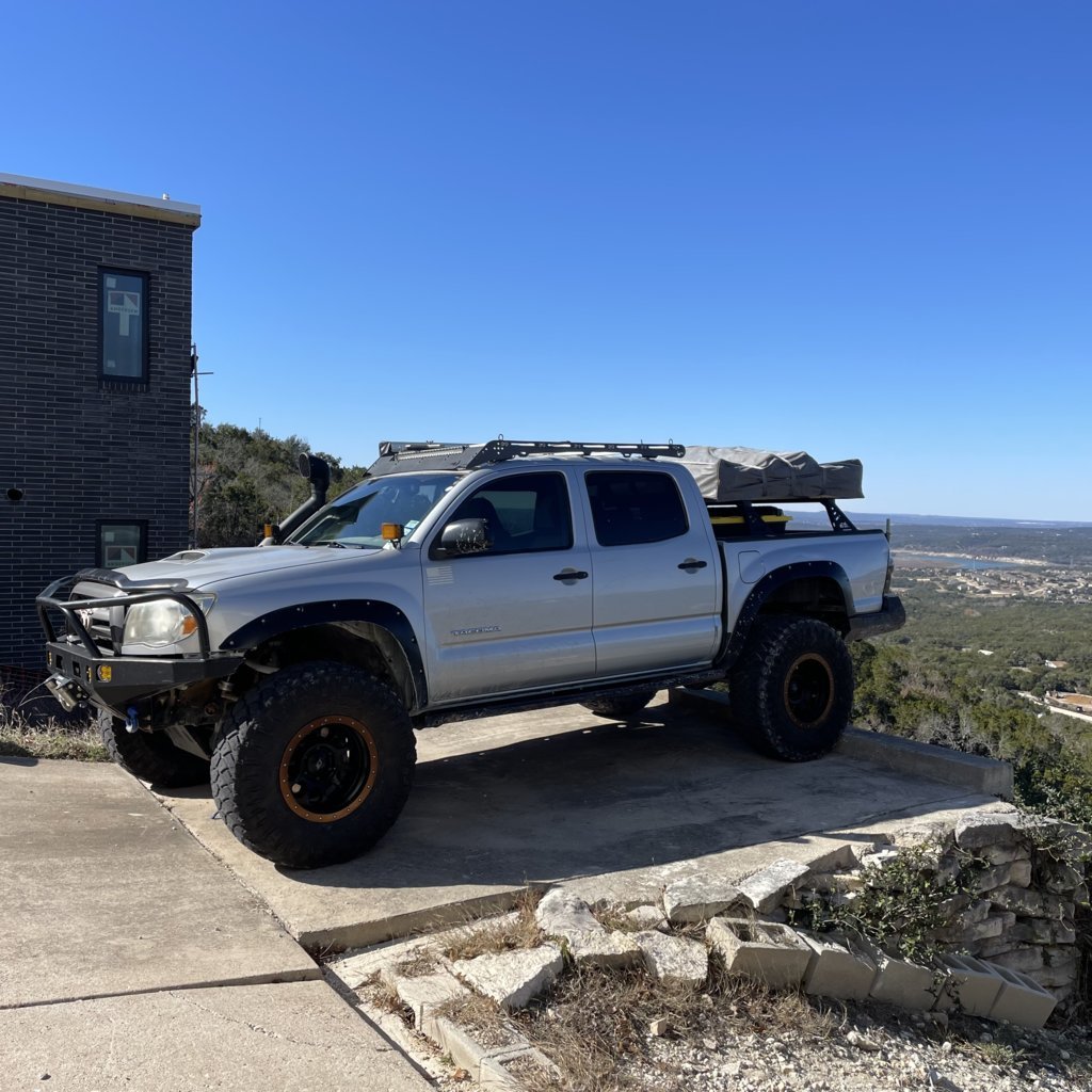

    Dirty 7’s are on the shit box now

    Idk those gunmetal/blued wheels look pretty sick with the silver

    Looks good! Did you get it running/engine swap?

    I did, got it fired up in June. She bangs off the rev limiter like a champ.

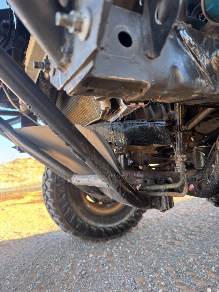

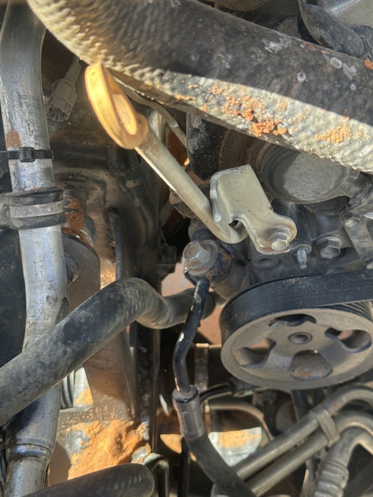

    Can I unbolt this power steering line and reinstall it in order to remove some coolant lines? If I remove that power steering line for a couple minutes will it allow air to get unit the system forcing be to bleeed it?

    Just add what's lost and it will be ok. Might whine until the air gets out. It's low pressure when the engine is off.

    Yea I’ll just turn the wheel a couple times and add in a bit if needed right? Here what happened. Overshot a short takeoff that bucked me and landed right on my sid plates that caved in the condenser/radiotar fan and coolant lines flattened. Motor mounts fine they were tig welded. Just gotta get new lines in and radiator back in business, who needs AC lol

    Damn almost had a yard sale....yeah power steering is pretty resilient, you can crank it up with 0 fluid in it and just add some until your full and it won't care.

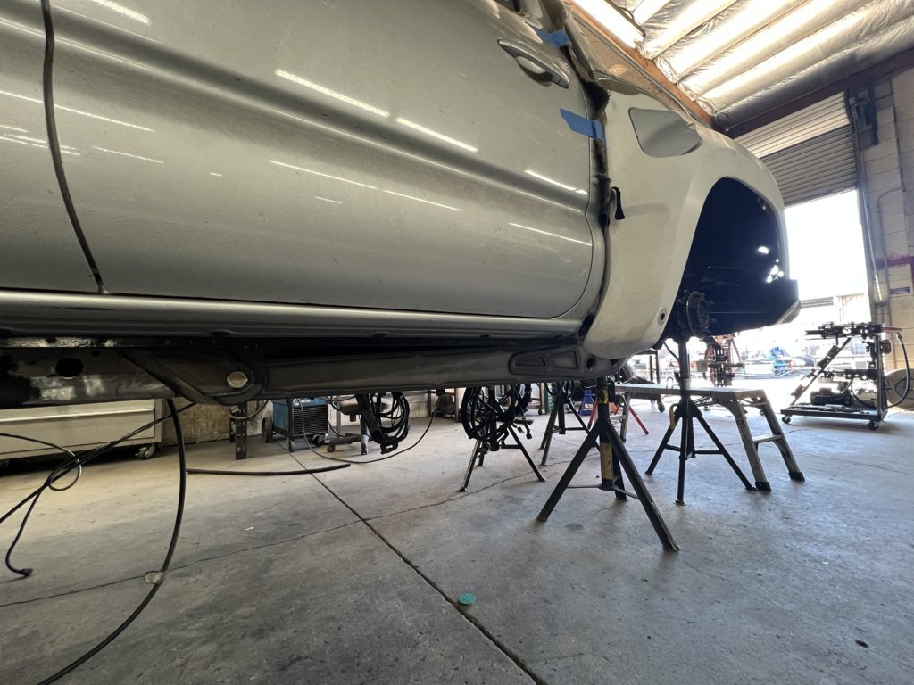

    06' DCSB 4x4
    Yes
    these fancy new rock sliders are sweet :bananadance:
