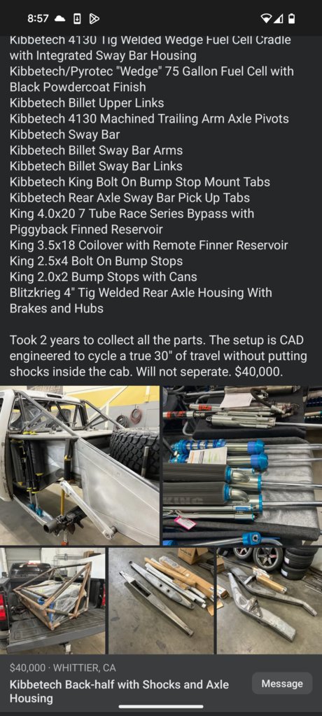

    Was really looking forward to seeing this go together on a 3rd gen... Too bad it's going up for sale
    It was for @yufengluo1 taco

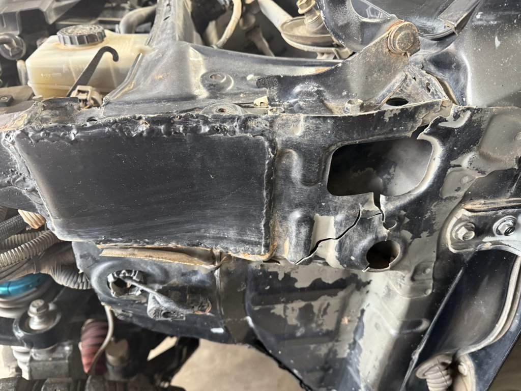

    So this is fucked, the core is completely separated from the cab. I’m planning on cutting all the cracked shit off and adding a bushing between the firewall and core to allow some flex between the two. Body and core are all on poly bushings as well.
    Anyone see any issues with this approach?

    Tube it

    A cage? I know that is the best way to fix it, but not happening right now.

    Looks like more and more of us are needing a solution released. :spending:

    What do you think about my bushing idea? It will at least allow a little flex. I will be pulling back the curtains this weekend to see what I am working with on the firewall.
