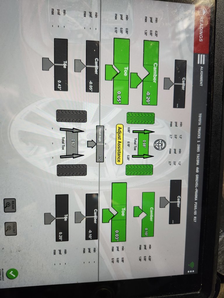

    Bent housing. I chased poor handling for years until I looked at the rear numbers and saw the thrust angle and toe was off. Replaced the housing and it's 100% better.

    I've seen much worse thrust angles just looking at other people's alignment sheets on TW

    It's likely not a big deal. My baseline is that if it causes feathering on the rear tires, fix it. That such a small amount, that you could very quickly fix that by heat cycling a strategic point or two with a torch.

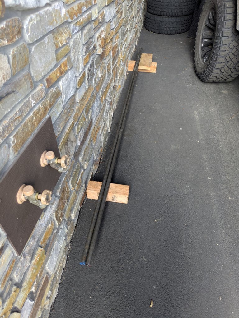

    If the only con is some wrap I'm good. This truck is fricken plush and plants well in the turns. No loss of confidence and it took a 3 foot drainage ditch like a champ today. I get why people run a HD leaf pack though. I can't imagine this thing hauling any weight.
    7.5 inches to bump stop pad to axle at ride height. So...9.5 inches of uptravel vs my previous setup of 5.
    Still has the same amount of droop as before which will be nice.
