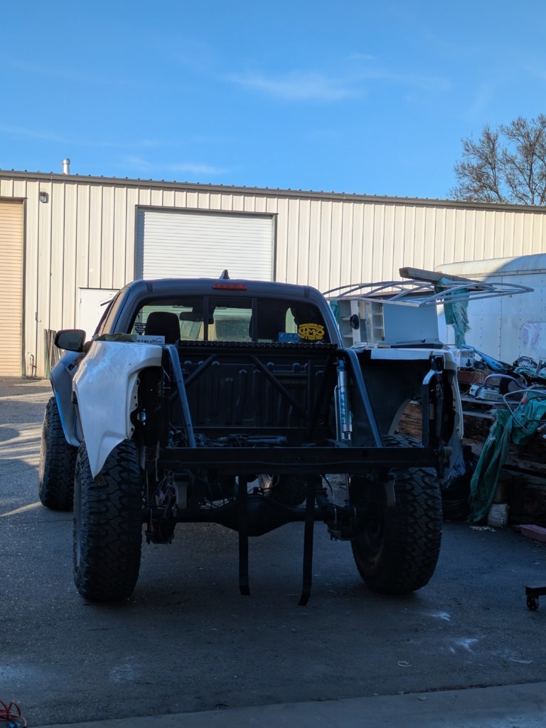

    What thickness of metal would you guys recommend to plate this part of the cab for a tube inner fender?

    I am retarded and can not read the post

    was gonna say they say they used 1/8 though in that application i don't believe your gonna gain anything from chromoly plate vs mild

    You're going to gain more from a solid welding procedure than you will from a thicker or stronger material. Cracking/tearing at the weld is your biggest concern, just like with the stock inner fenders.
    -make sure your fitup is nice and tight, and clamped well
    -preheat the pieces
    -short welds, hopping around on the piece. Normally this is done to minimize warping. You really don't have to worry about that, but what you want to do is minimize the total amount of heat put into it.
    -slow the cooling of the pieces post weld as much as possible.

    that and tying into multiple planes will help tons as well

    Would you recommend doing a cross brace from each inner fender?

    it's not a Honda Civic...if you tie your inner fenders together with a cross brace you will rip them off the truck the first time you hit dirt. the frame has a crazy amount of torsional flex
