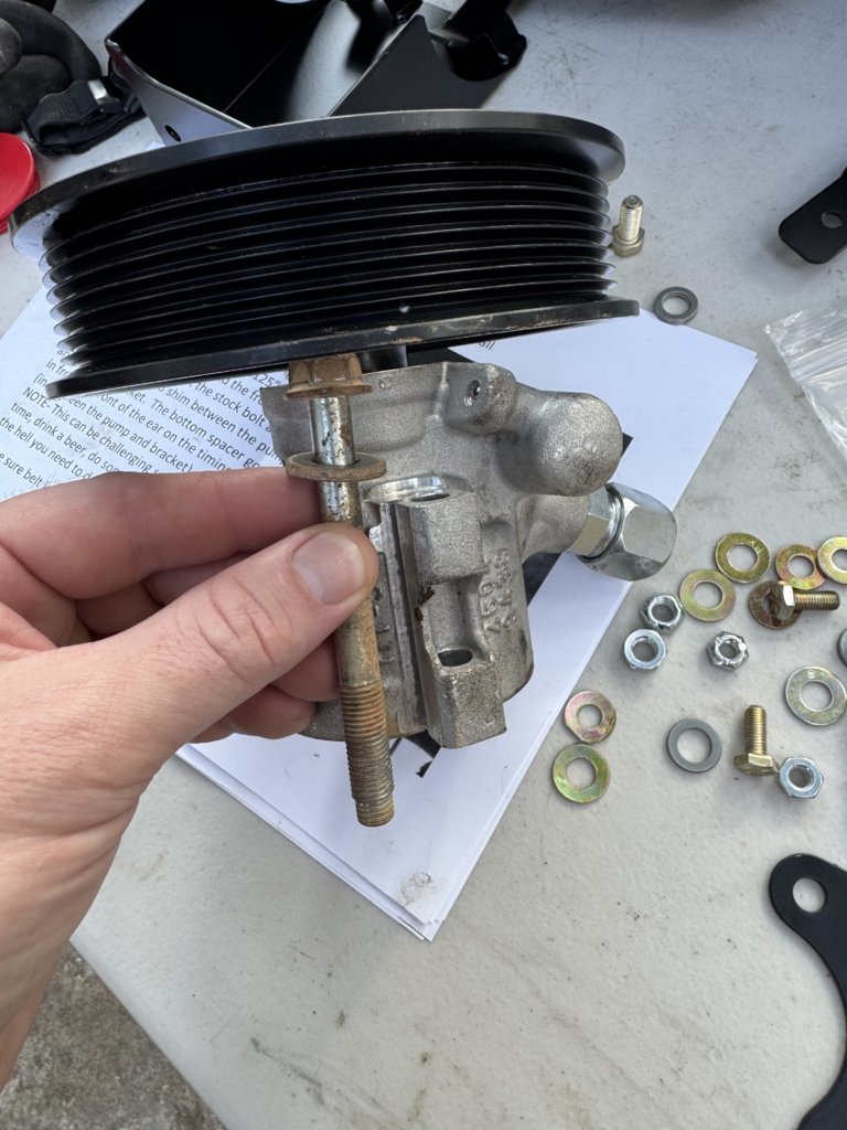

    Is this where the stock bolt is supposed to go?
    Hole dia is too small.
    edit: Yes. Called and spoke to them. Guess the $2k doesn’t include drilling?

    Their directions say to reuse the stock bolt. I was trying to figure out why it wouldn't bolt up.
    I called JD fab, and they didn't machine the housing as required, so I had to do it.

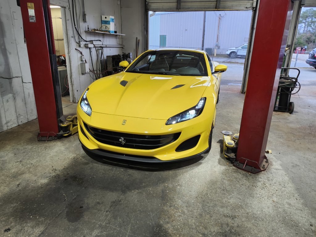

    20250205_153527.jpgDid some minor work on this 3000 mile rarri last week. Popped the hood and immediately saw rat pee streaks and poop/acorns on the air boxes, showed the owner and he was taken aback.
    He lives in a million dollar home lol. Rodents don't care
