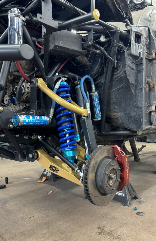

    We do have a “never been done” pump setup and a steering “fix kit” in the works right now. The truck this is being done on is getting 37’s in the spring.
    The pump kicks the shit out of a TC. The rack fix kit is my only “questionable” piece of the puzzle. But so far the rack has held up to heavy abuse with 33’s.

    Crazy. Considering I’m at true zero for bump steer and my “uppy downy bits” are not the same.
    Oh if only it were so simple. Maybe it wouldn’t have taken 4.5 months to build.
    If it weren’t a 15k$ undertaking, I would have this swingset released to you guys. But there are requirements that most do not fit. Main one being an engine cage.
