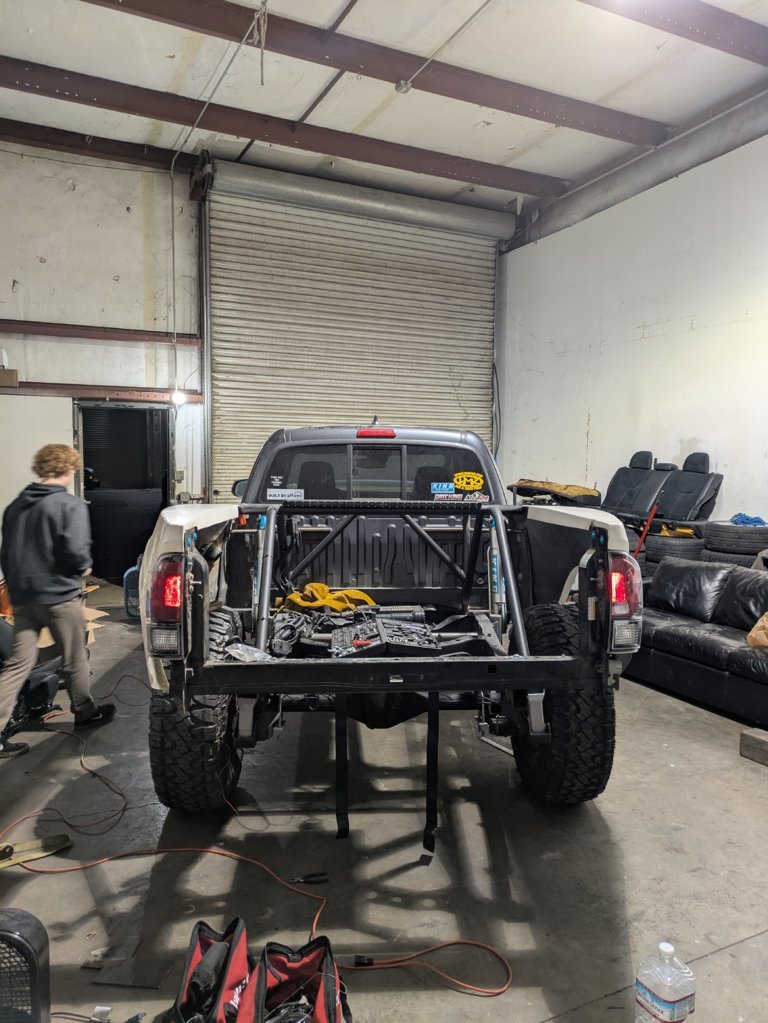

    Took a break from tubbing and finally mounted the bedsides to the bed cage

    I'm sorry to say, but this will still rub, pretty much guaranteed. Not sure if you did this, but you need to remove the bumps and cycle as far as you can until it physically can't go any more, then tub around 1.5" further than that, because that's how much the frame flexes.

    The correct bump stops that I needed are about 1.5" longer than what I cycled with. On the steering stops and everything. Basically cut as close as I wanna get to the door hinges. Time will tell but I think they fit. Idk just with my measurements haha

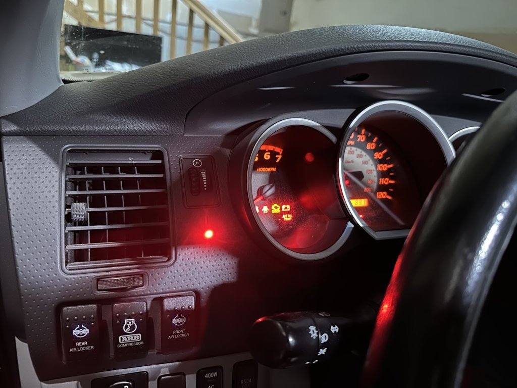

    ABS Eliminatus. I finally took the ABS actuator out of my truck using two-T fittings to connect the lines. I haven't had abs in years and the abs and brake light in the dash have been on. I'm tired of looking at it. But I would like the parking brake light to come on when the parking brake is engaged. Has anyone connected the parking brake switch (pbs) at the parking brake directly to the brake light in the combo meter? The pbs is just a grounding switch and the light in the dash should come on with power. I have the ewd and the brake light is a B-W wire coming out of the combo meter. On another note, we thought the plug on the ABS actuator would have to be connected to something to have functions working, turns out the plug unplugged many, many miles ago. I have my speedo connected directly to a speed sensor I installed in the transfer case.

    I connected a standalone LED I mounted on the dash to my parking brake plug. IIRC the parking brake completes a ground circuit so I believe I pulled 12v+ just from an add a fuse.

    This was thought #2 and just tape over the brake light in the combo meter. It's a simple circuit and should be able to send 12v to the B-W wire from the grounded pbs.

    You should also be able ground the signal wire for the light as well to shut it all off.
