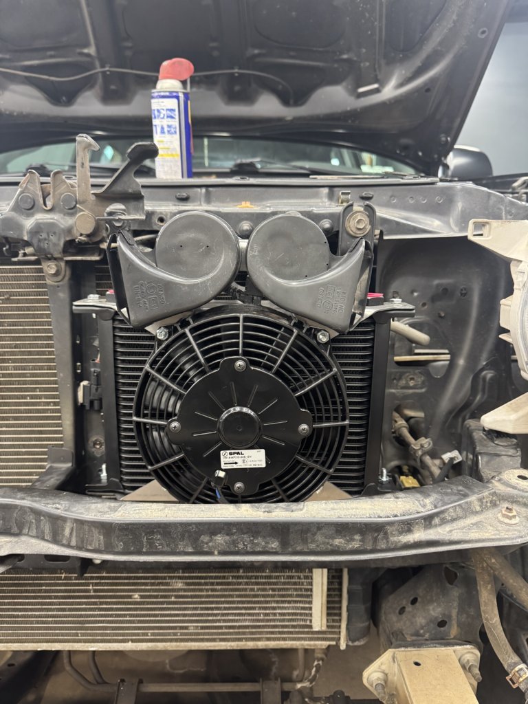

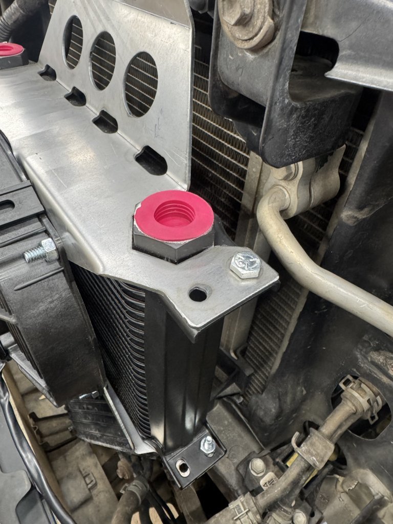

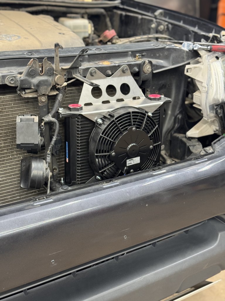

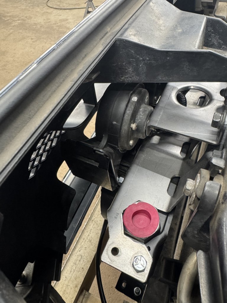

    Alright, final revision. This should fit anything and everything. Fittings arrive tomorrow and it will be all wrapped up by end of the weekend.

    I was all in until I saw you have to relocate the horns. Getting beyond my abilities at that point.

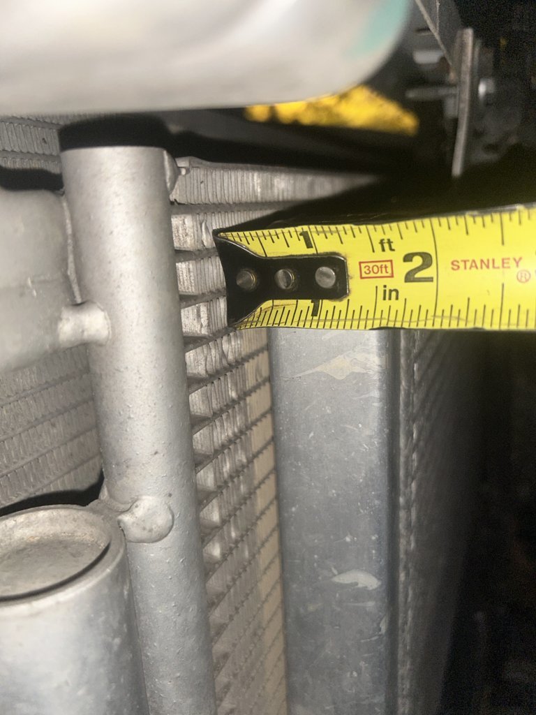

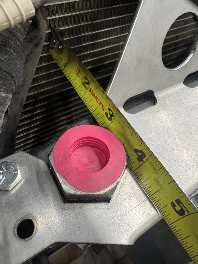

    Sorry if I’m late on this!
    1.75” from face of condenser to outside of heat exchanger. About 0.25” from condenser gap to the heat exchanger.
    Also thought it of note, that the Magnuson radiator used these two holes as mounting points.
    I don’t think it interferes with your current rendition as your photos show it close to about 2.5” off the condenser?
    906taco[QUOTED] likes this.

    Really appreciate the pictures! It’s solid confirmation that all should be good for the magnuson guys.
    Thanks again!
