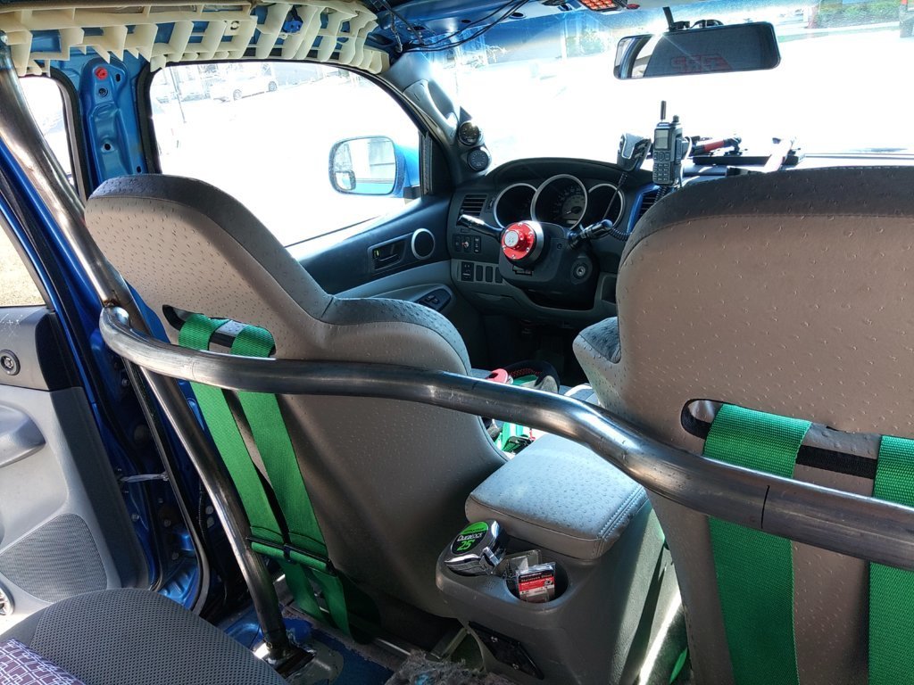

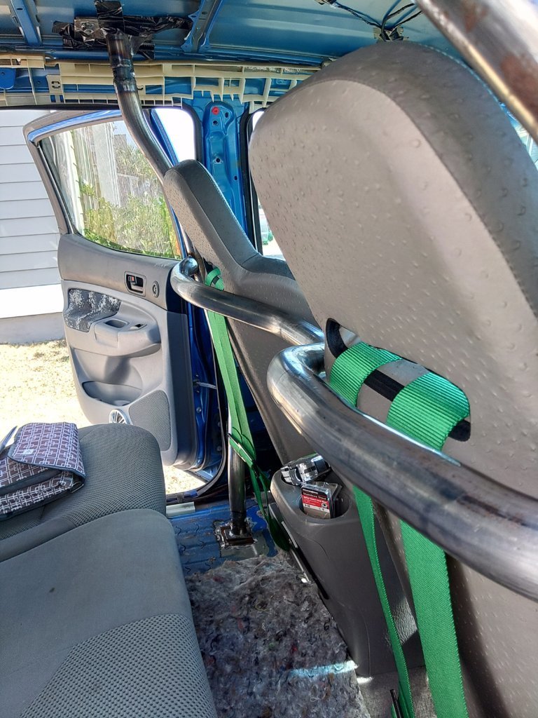

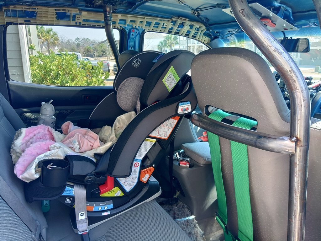

    The things we do for our kids
    8 bends in a 3.5' piece of tube.
    Just to be able to fit this.....

    mad respect dude

    Unfortunately most won’t understand the complexity of something like this. Nice work dude!

    I just know that took forever to measure/bend. Looks insane, good shit

    Nice work! Any deviation from getting them all on the same plane (IE floor wobble test)?

    The center section (4 bends) that protrude forward to clear the baby seat are 15 degrees off axis from the bends closest to there uprights, which are horizontal, so the floor wobble test couldn't be done on this one.
    Used to run welding crews on powerplants. Learned how to be very precise with these little guys. I actually prefer them to the digital angle finders when I'm setting tube up in the bender.
    https://pipefitter.com/store/tools/centering-tools/magnetic-small-center-finder.html

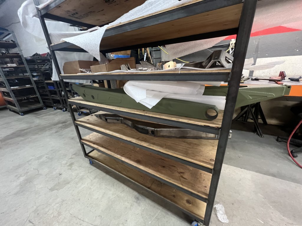

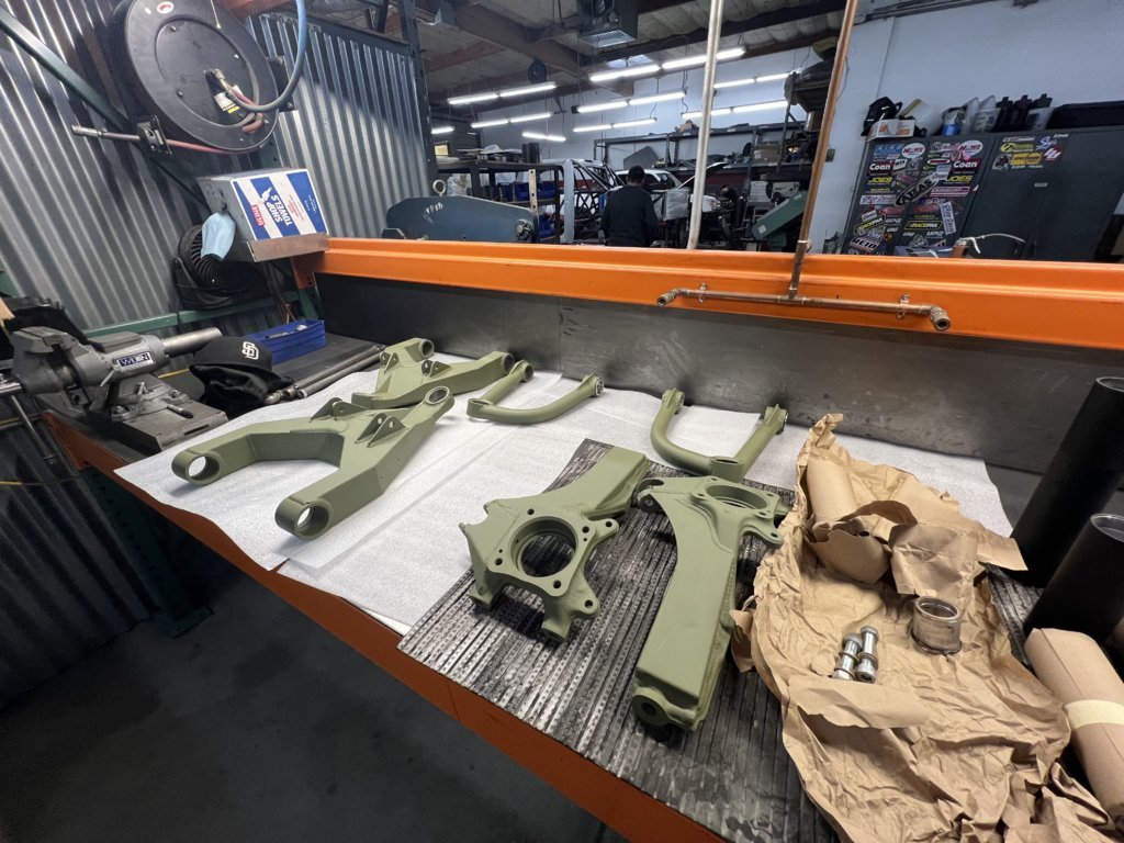

    Got some goodies back from cerakote today, really like how you can see the welds so much better vs pc

    HELL YEAH, good job dude!

    Yeah we will see how well the Cerakote on my solo kit held up here shortly
    Mines in “destroyer grey” and I agree
    Looked way smoother than PC

    Cerakote is some good shit. I believe I remember talking to you about it a while back.
    Higher chemical resistance
    Higher UV resistance
    Higher scratch resistance
    Higher chip resistance.
    Lots of perks to it.
    The one and only true downfall is the film thickness. While it is harder than powder a lower film thickness does mean it will be take to metal much faster with rock/dirt spray.
    But as someone who’s been coating for over a decade, I do personally believe it is superior.
