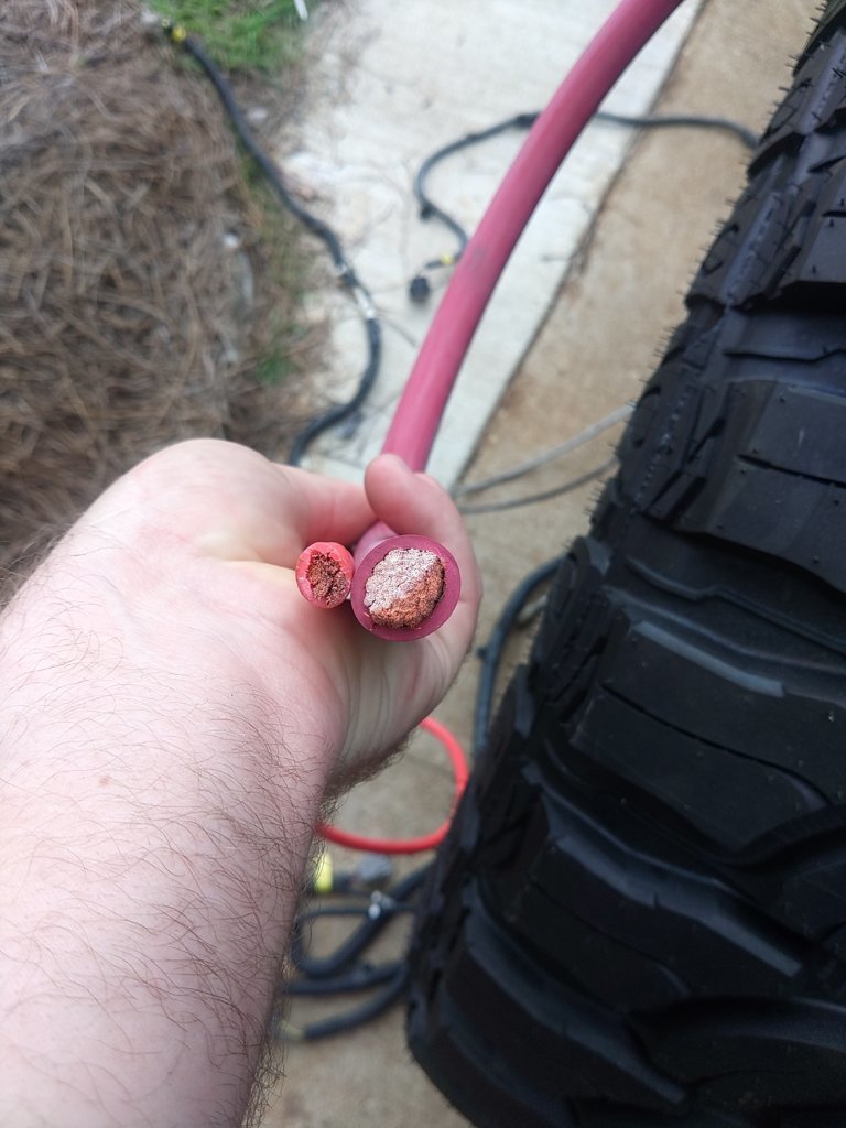

    dude what size/purpose is that wire(s)?

    4/0. Main run from 270 amp alt to battery. It was for when the truck had a winch.

    I’m behind my 3rd seat. It’s a 15’ run said and done. Which technically does call for 4/0 for 270 amps regardless.
    Even though it will likely never pull the full 270, the potential does exist.
    No matter what, power and ground cables should always be overkilled to some extent. You will even notice by doing a “big 3” upgrade that your truck starts and runs cleaner.

    So many people are running undersized electrical wiring. When you do the math and actually factor in distance from the alternator/battery, it's rare that a winch would ever run what's sent out by the manufacturer. I had to run 4/0 to my 13k rear winch. Heavy and expensive stuff, but worth it to not burn down your truck.
    Coiled up when I was sorting some out some routing
    It, next to what comes with most winches.

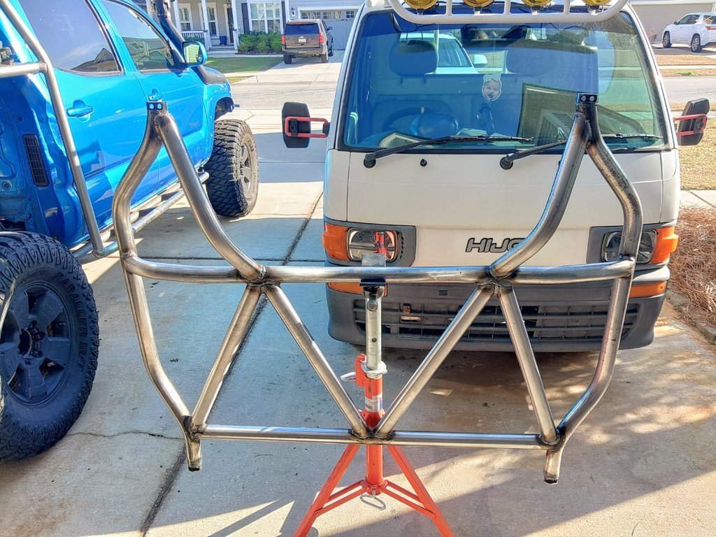

    Finished it this afternoon. Curving and keeping it tight to the seats took some doing to make sure rear passengers still have legroom without compromising strength. Putting it in tomorrow, and then onto the roof and a-pillar/windshield.
