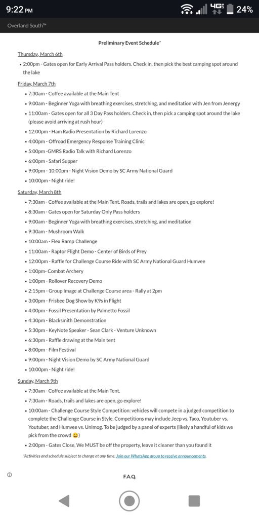

    Here's the schedule for next weekend. You can run the trails and use the challenge course throughout the weekend, but they have some fun and often educational demos throughout the weekend. And you can come and go as you please. I'll be setting up camp friday and hanging out for a bit, but heading home in the afternoon. Coming back for all day Saturday and camping Saturday. Hope to see you at one in the future!

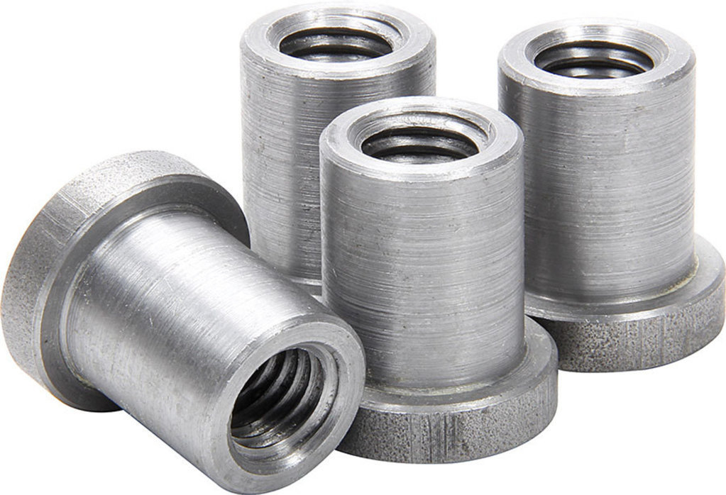

    How'd you ground to your cage? I've been thinking about welding a stainless lug to mine.

    3/8 weld in inserts from allstar performance.

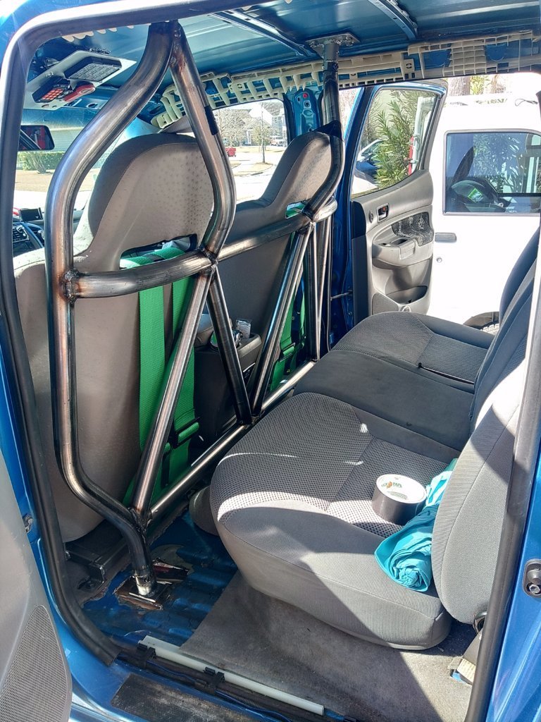

    This section and the window bars will be removable. TMR roll cage connectors.

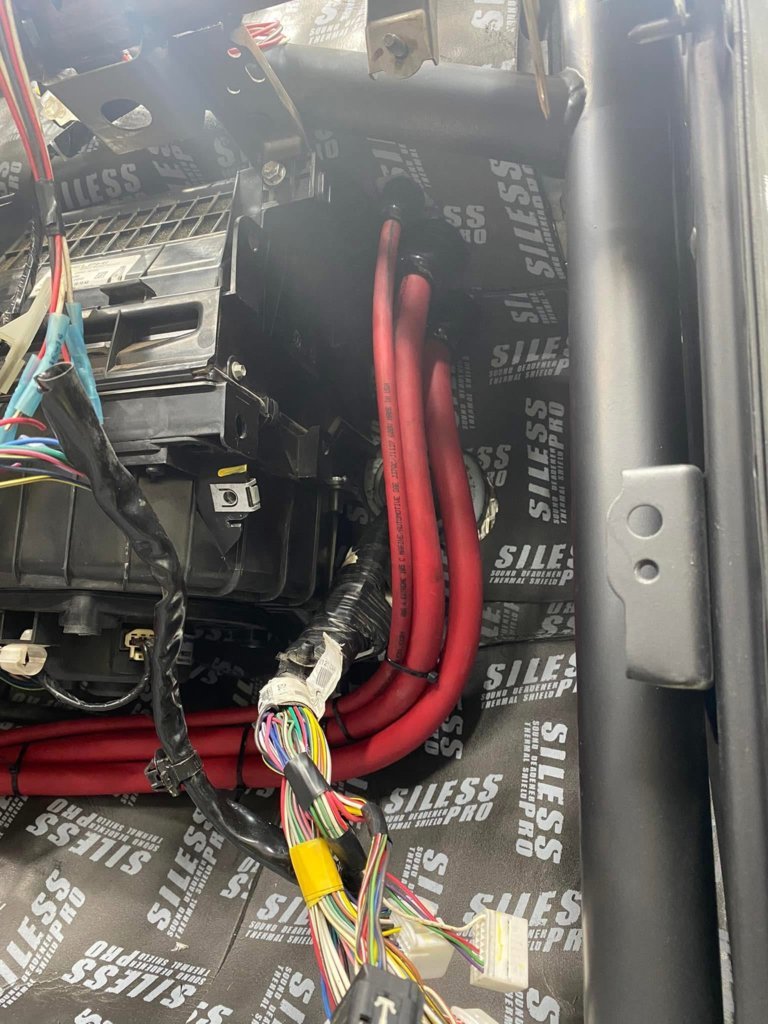

    But all of my cable and lugs came from battery cable USA. I went with the dual insulated “extreme” as it adds a secondary layer of protection against chafing.
    2 runs 4/0
    Run 1 was to the alternator
    Run 2 was to a bus bar
    Ground
    4/0 battery to cage
    4/0 cage to engine
    I used some pretty bad ass billet battery lugs from SDHQ
    Some nice blue sea 750 amp fuse blocks with ANL fuses to my needs
    All lugs are hydraulically crimped on as soldering brings oxygen into the insulation and will eventually cause corrosion.
    I also used a Pike Industries 400 amp bus bar where I terminated my 4/0 and picked up power for my winch and electric fan.

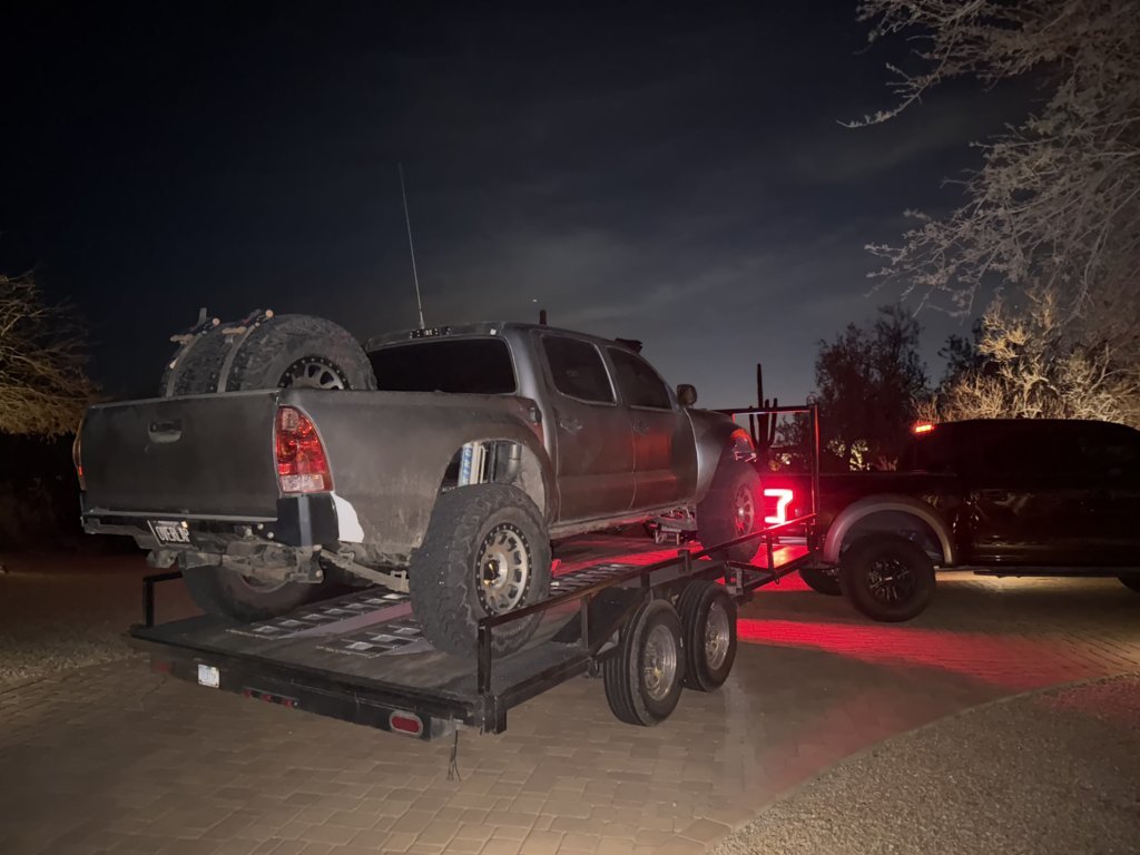

    Well she’s loaded up on the new trailer. That means this thing is officially a toy, and I will tow it to wherever I want to have fun with it.
