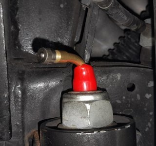

    Same problem with Locked Bump stops. So I put some high pressure valves (300 psi) in a cheap 90* extension. Not ideal, but it works.
    https://www.amazon.com/ILOVA-Extens...4989&sprefix=schrader+valve+90,aps,313&sr=8-3
    JTFisherman[QUOTED] likes this.
