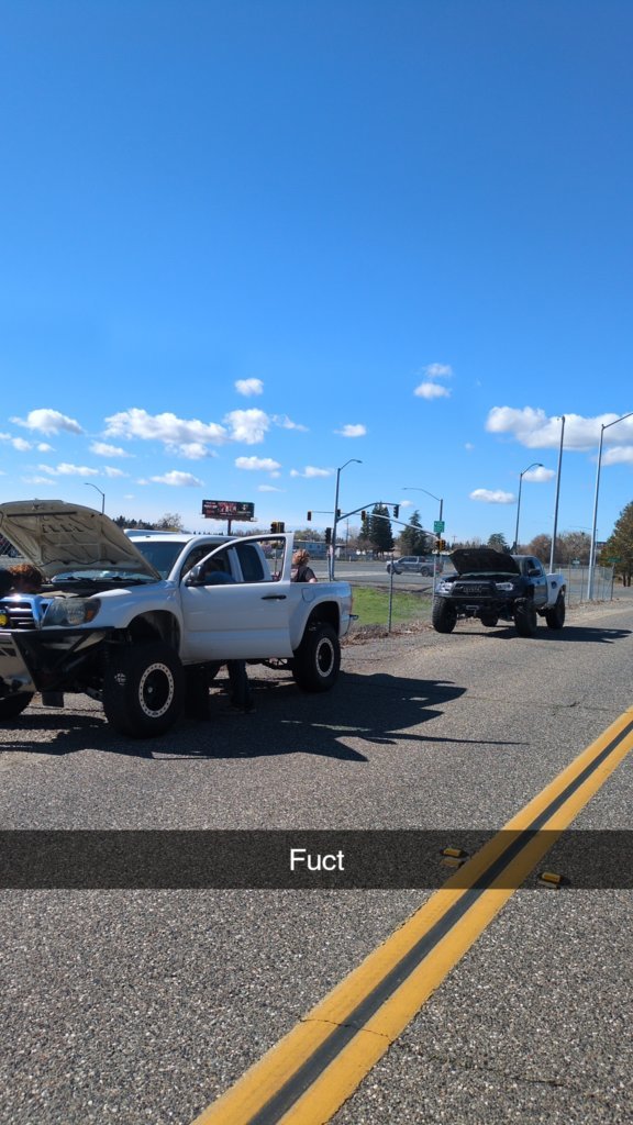

    Well made it 15 miles and another alternator shit itself and my brother's truck blew a radiator.
    I don't know why the fuck my new alternator shit the bed.

  10. Mar 3, 2025 at 2:34 PM
    tacotunner06
    tacotunner06 Well-Known Member
    Sep 2, 2017
    #228857
    2,278
    Edmonds, Washington
    2006 White Tacoma
    LS Swap with RSG Tranzilla, Custom hi clearance front bumper, Relentless: Slider's, bed rails, rear bumper, Prinsu with 40" BD s8. Dirt Designs 3.5 LT. Archive Garage rear towers/shackle flip/SUA. King Air bumps. King LT Coilovers in front. King 12x2.5 in rear. ARB rear air locker and twin compressor. SCS f5's with 33" Ridge Grapplers. 20" S8 mounted in bumper, squadron sport fog lights, squadron pro backup lights, LP6's bumper mounted.
    what brand? and unless its a manufacturer defect you've definitely got something screwey going on.
  11. Mar 3, 2025 at 2:37 PM
    SoonToBeOn39s
    SoonToBeOn39s Well-Known Member
    Mar 20, 2022
    #393038
    1,870
    I finally got bigger tires 2020 Long Travel Tacoma 1997 MAGNUM
    OEM alternator. It was off a totaled truck but i tested it before hand to make sure it works.
  12. Mar 3, 2025 at 2:58 PM
    tacotunner06
    Sep 2, 2017
    #228857
    2,278
    Edmonds, Washington
    2006 White Tacoma
    oh, would definitely say a wiring issue in your truck than.
  13. Mar 3, 2025 at 3:14 PM
    SoonToBeOn39s
    Mar 20, 2022
    #393038
    1,870
    I hate electrical shit. Still on the side of the road waiting for a trailer and taking it to a shop right after
  14. Mar 3, 2025 at 3:19 PM
    906taco
    906taco Well-Known Member
    Jun 22, 2021
    #369289
    3,963
    Cory
    08 Taco
    Be prepared to open that wallet. With the amount that’s been done, finding it is going to be a needle in a haystack.
