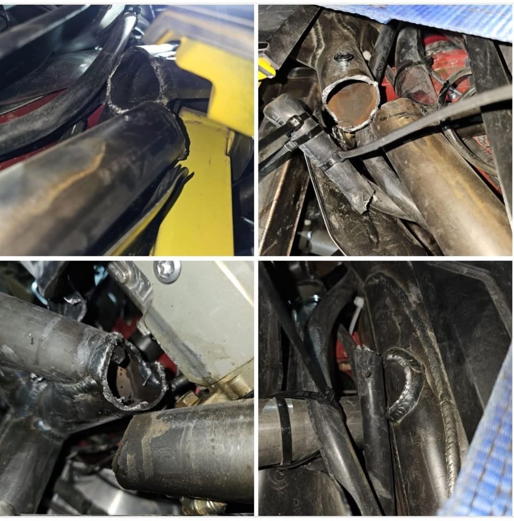

    Still has the mill finish on it too. So those welds, and thus, mostly the edge of the HAZ is contaminated by that. And if they didn't even clean that up i doubt they got anything right with preheat and post heat

    all of this seems to be more reason to wanna run docol r8...to bad it seems so hard to come by.

    Having worked with Docol and 4130, there really isn’t any upside to docol other than maybe a few seconds less prep. Docol cost is substantially higher for near identical performance. Although Docol is less rigid than 4130.
    IMO they both weld identically as well, Docol might be slightly more “butter” like. I don’t think you will see many jumping ship from 4130 any time soon.

    smashed this, broke that, covered it up with tape and paint
    No other comments for now, sorry.
