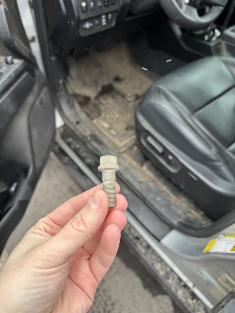

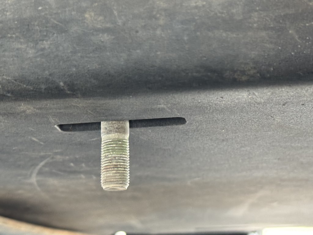

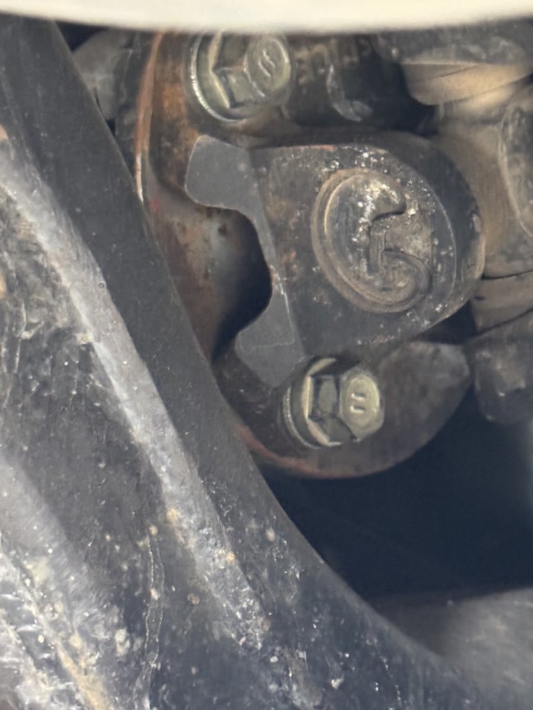

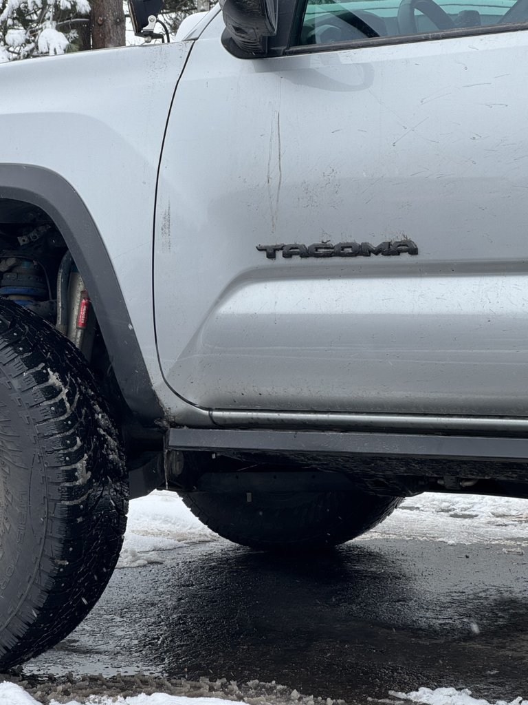

    Hopped in the truck at the grocery store and saw something dangling through a gap in my skid.. it’s a bolt off the drivetrain flange. HUH!?
    anyone know the torque spec offhand? :burnrubber:

    Damn how the hell did you see that?

    65ftlb

    happened to catch my eye as I was walking up to the truck. better question is of all of the places it could have been ejected, how did it end up in a hole cut in the skid to get at a bolt?
    going to go sacrifice some sockets to my engine bay preemptively as penance

    I always use blue loctite on my driveshaft bolts

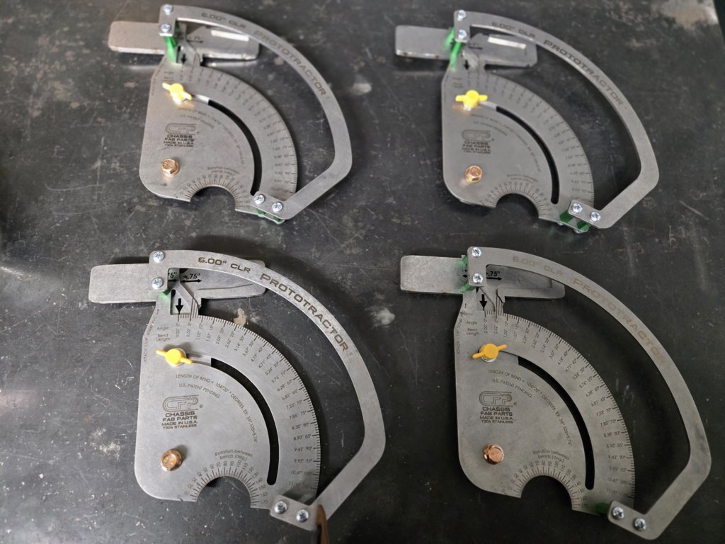

    Good advice. I'm fairly familiar with my bender. I've built bumpers, swing outs, shock hoops, and other assorted stuff. I have a pretty good basic understanding of it and the principles of it.
    The main things I'd be looking at with the program is:
    - To get an overall plan for the cage that can be looked at by tech, and critiqued. That way I know I have a good overall plan on where everything needs to lay out.
    - Be able to keep the measurements, so if I'd like to replicate it, I have the files.
    - The coping templates for some of the more intricate intersections may also be helpful.
    I also have tube tracers, etc, to get the copes and notches right.
    I also just recieved a set of 4 Prototractors...
    I'm really hoping they help ease the layout on the main hoops etc.
