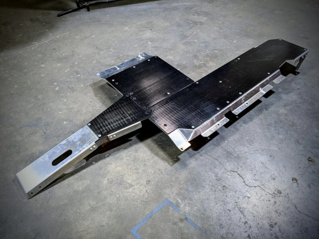

    What about just doing something like this? Aluminum base with sacrificial UHMW? Just the weight oriented side of me hating on steel skids more than anything.

  3. Mar 16, 2025 at 7:23 AM
    tacotunner06
    tacotunner06 Well-Known Member
    Sep 2, 2017
    #228857
    2,266
    Edmonds, Washington
    2006 White Tacoma
    LS Swap with RSG Tranzilla, Custom hi clearance front bumper, Relentless: Slider's, bed rails, rear bumper, Prinsu with 40" BD s8. Dirt Designs 3.5 LT. Archive Garage rear towers/shackle flip/SUA. King Air bumps. King LT Coilovers in front. King 12x2.5 in rear. ARB rear air locker and twin compressor. SCS f5's with 33" Ridge Grapplers. 20" S8 mounted in bumper, squadron sport fog lights, squadron pro backup lights, LP6's bumper mounted.
    would definitely slide better than just aluminum would thats for sure.
  4. Mar 16, 2025 at 7:39 AM
    906taco
    906taco Well-Known Member
    Jun 22, 2021
    #369289
    3,906
    Cory
    08 Taco
    I still say everyone is sleeping on 7075. But I won’t waste my time explaining that it’s actually harder than mild steel. It takes more to gouge 7075 than it does steel.
    You could do a .190 7075 base with .190 UHMW be lighter and stronger than a .188 mild steel skid. If friction is a concern at least.
  5. Mar 16, 2025 at 9:15 AM
    colinb17
    colinb17 If at first you don't succeed, don't try skydiving
    Jan 6, 2008
    #4127
    20,168
    Colin
    Charleston, SC
    '07 TRD Sport 4x4
    Build thread in sig... 4-link long travel
    It's an interesting conversation for sure, and I'm all about nerding out over some materials science.
    The 7075 ha a slightly higher hardness and tensile rating than A36 steel (Rockwell and brinell). However the shear modulus of A36 is more than double the 7075. Sliding over a sharp rock, hardness determines how deep the gouge is, but the shear modulus determines how much material (if any) is torn out as you continue to slide across the rock. Of course there's a lot more to look at to, including elastic limits and yield strengths, etc, but the discussion seemed to be more about gouge resistance than anything. I think 7075 is wonderful, but likely underutilized in offroading because of 3 things:
    -the price
    -the fact that the majority of home builders don't have the tools to easily cut and tig weld aluminum
    -general lack of understanding of the various grades and applications. Only considering steel for skids is like the "there's no replacement for displacement" engine mindset.
    To reiterate for the next bit, I know UHMW brings up a lot of lot of opinions. I know it's a viable option for what I want to accomplish when designed right. I have plenty of firsthand experience using it, I just haven't had the pleasure of designing it yet, which is why I asked about design parameters.
    I found the information I needed, and finished up the math last night. Like most materials, there's a sweet spot, and for my application, It lands on 3/4". There's a minimum tubing structure I'd need for any of the materials. Essentially two more tube crossmembers with a couple of longitudinal braces. With 3/4" UHMW, I don't need any additional support, just bolting points. Total UHMW weight for the entire underside is ~65lbs, which is pretty great. 7075 would be about 20 lbs lighter. So there's a weight difference, but nothing crazy, and both are SUBSTANTIALLY lighter than steel or any type. The 3/4" will take impacts like the steel. Very different than what you see under UTVs.
    Like aluminum however, this will be a more expensive material than steel. However total cost should be similar to if not less than buying off the shelf skids for a factory layout Tacoma from any of the respected aftermarket companies.
    Cory, I kind of view this similar to your commentary on potentially engine swapping your Tacoma with another Toyota/Lexus engine vs a "easier" LS.
    May take a bit more work, but ultimately it's a bit more personally fulfilling, and when done right, is absolutely as effective, potentially even better when you factor in your more niche goals.

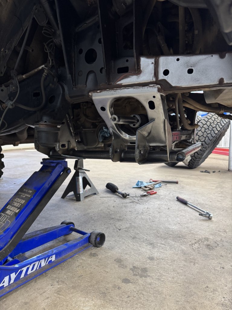

    In the process of helping my wife build a pretty nice mid travel truck on 37’s.
    I will never find enjoyment in doing these pivots though. Between the grinding and a ton of fitment, it just sucks.
    But pushing the tire forward sure saves a bunch of work on the firewall.

    I finally got bigger tires 2020 Long Travel Tacoma 1997 MAGNUM
    How much does that pivot kit move the tires forward?
  13. Mar 16, 2025 at 12:21 PM
    906taco
    Jun 22, 2021
    #369289
    3,906
    Cory
    08 Taco
    1/4”-1”
    SoonToBeOn39s[QUOTED] likes this.
