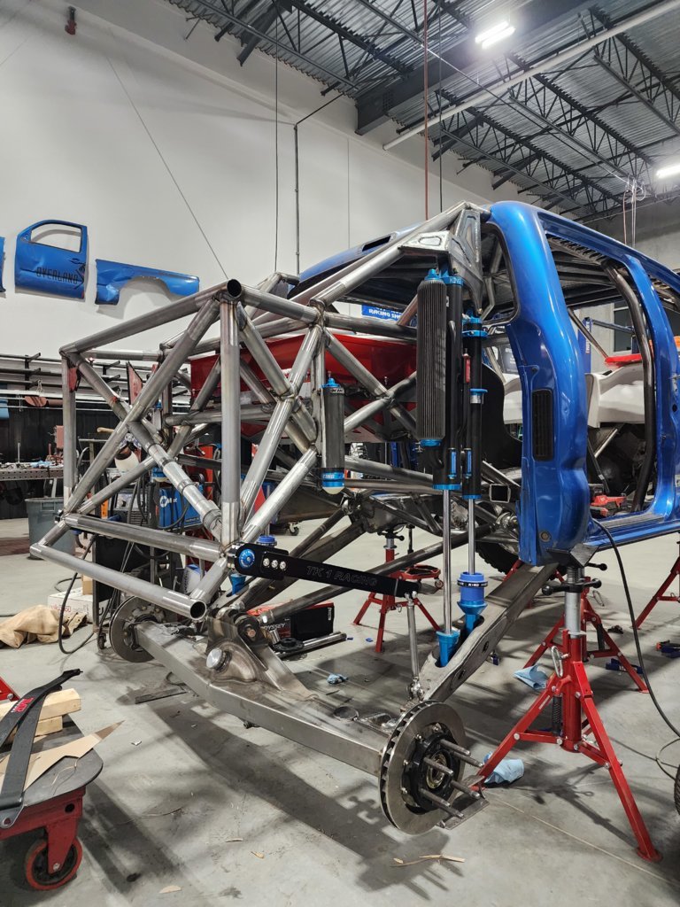

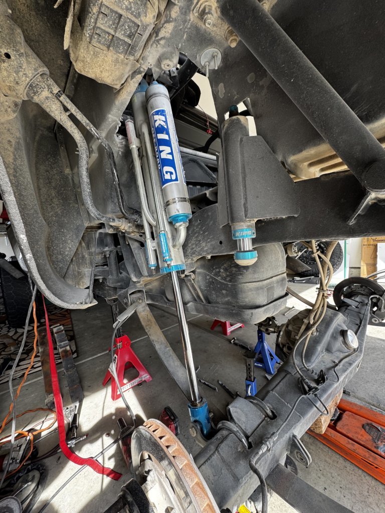

    Got the 3.0’s in and cycled. Just gotta fully weld the shock mounts and put the leaf packs back together.

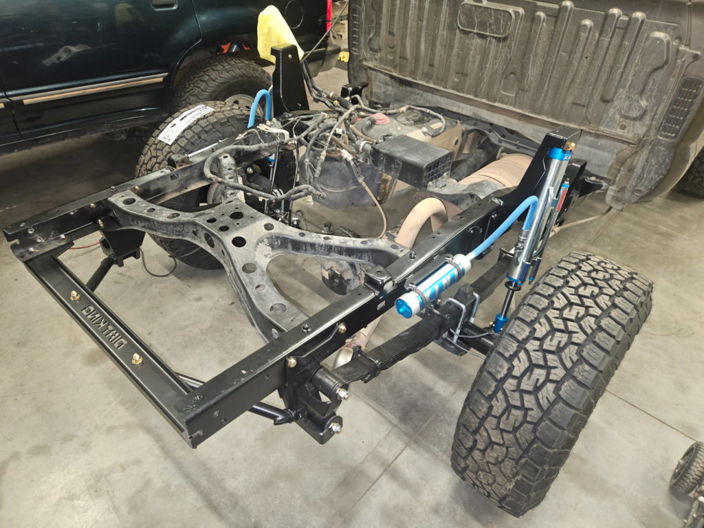

    1" forward is a 2" bigger tire at the firewall. Helps a lot. No tubbing for 35s on a reasonable offset. But one of the biggest differences is around 2" more clearance underneath compared to almost any typical bolt on skid.
    I'd say one of the biggest reasons to go with the LS is just how small they are for the power, plus the rest, limitless aftermarket support and super easy to work on.
    Just look at this thing tucked in there...
    Plus a rear suspension shot to keep it long travel

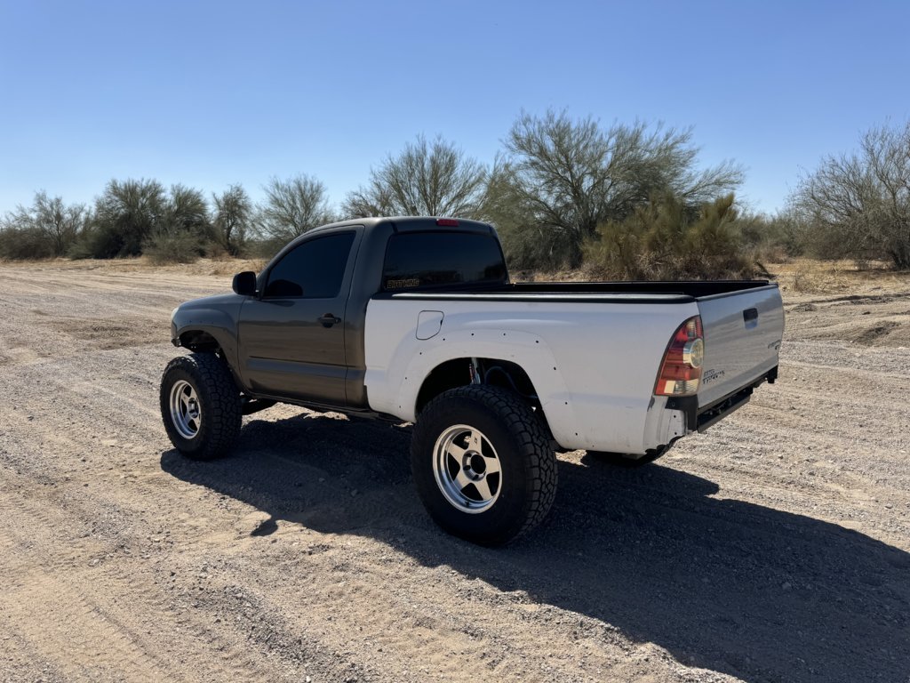

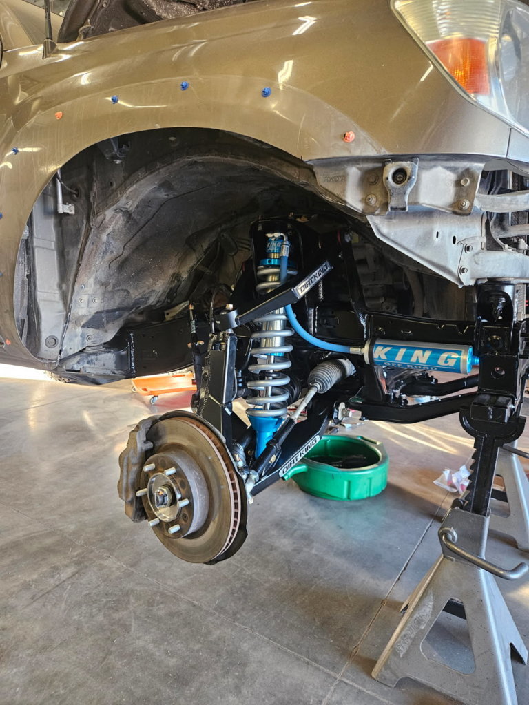

    I finally got bigger tires 2020 Long Travel Tacoma 1997 MAGNUM
    I think the pivot kit is my next big buy.
    Wicked creations claims that their LT kit pushes 2" forward, but I will definitely say it does not. Even though I already tubbed for 38s I want to push my front wheels forward

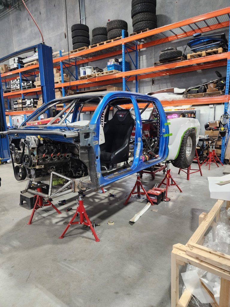

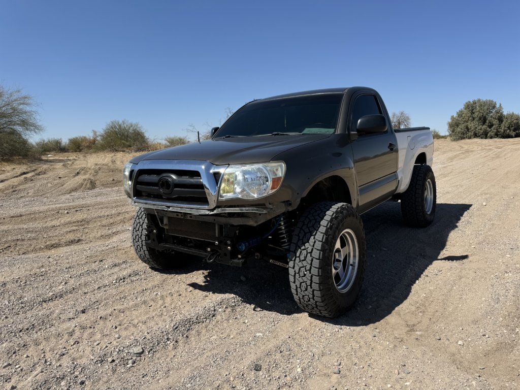

    Figured id show off a little build i been working on for a while 4wd 5speed. Just need to revalve the shocks/tune and i think it’ll be fun . upload_2025-3-17_0-19-14.jpg

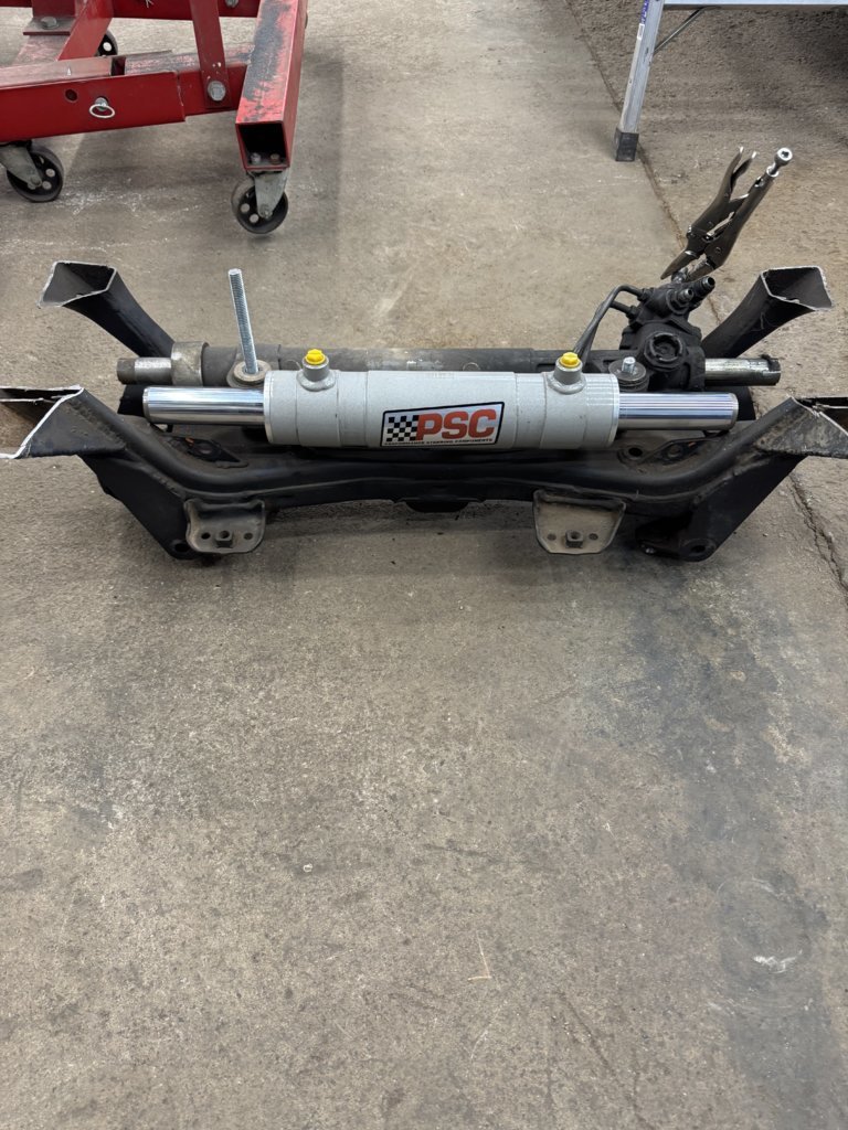

    depowering the factory rack. But keeping the orbital valve alive to power a ram.
    Think slide rack. But way cooler.
    This isn’t the ram I will be using, just stole it off a project I have in the shop to visualize things a bit.

    Swingset is baller as fuck if you want fast/powerful steering for a prerunner. Downside is, it’s expensive as hell to build. And extremely labor intensive.
    This is more of an experiment my wife approved of last night for her truck. There’s about a 0% chance of it not working. And we will be into it entirely for under a grand. Not including labor, of course.
    So power of full hydro, no seals to fail in the factory rack and retained mechanical link.
