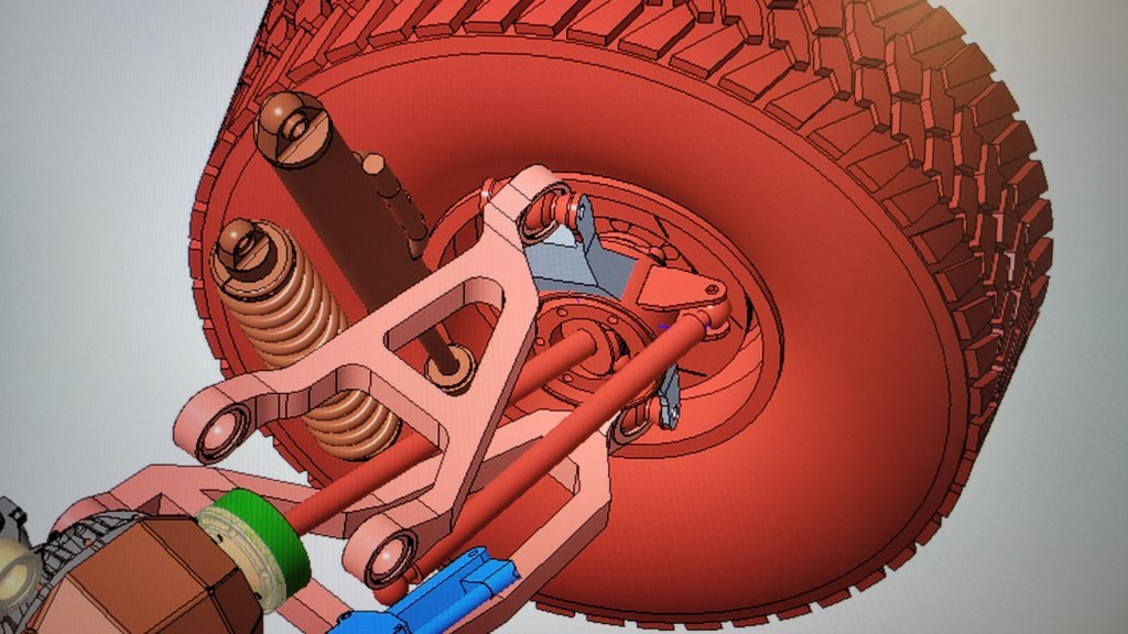

  9. Mar 17, 2025 at 11:44 PM
    WormSquirts
    WormSquirts Armageddon
    Dec 18, 2015
    #172583
    2,897
    Braeden
    BC
    The modeling for the space constraints and geometry is pretty much done. Then just have to design the actual parts in cad so I can build the arms, knuckles, bulkhead etc. looks like it will do a touch over 19" of 4wd travel with around .25" of bump steer from bump to droop, with roughly the same over all width as a +3.5" Lt kit

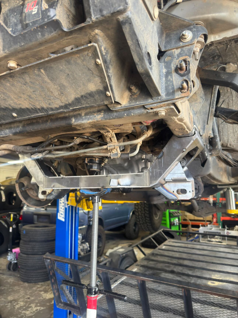

  12. Mar 18, 2025 at 4:10 AM
    drtfabrication
    drtfabrication Well-Known Member
    May 23, 2021
    #366527
    349
    Derik
    only have a front crossmember drawn up. Had a buddy twist his up pretty good and ended up needing replacing. AB607833-ECC6-4FEC-973C-8A59E5579C06.jpg

  13. Mar 18, 2025 at 4:14 AM
    906taco
    906taco Well-Known Member
    Jun 22, 2021
    #369289
    3,894
    Cory
    08 Taco
    Looks great! However I will say I see this not working for a few things on the market that I feel are great products. One of them being the JD pivots.
    Personally when I did mine, I made it so the diff mounts were no longer the low point. Those I have seen get tore off. Also, doing it this way allowed for more room for steering activities.
  14. Mar 18, 2025 at 4:16 AM
    drtfabrication
    May 23, 2021
    #366527
    349
    Derik
    Yea this was purely just a replacement crossmember for him. Not really something I’m offering. Was kinda just touching on the mention of this by someone else in the thread.
    906taco likes this.

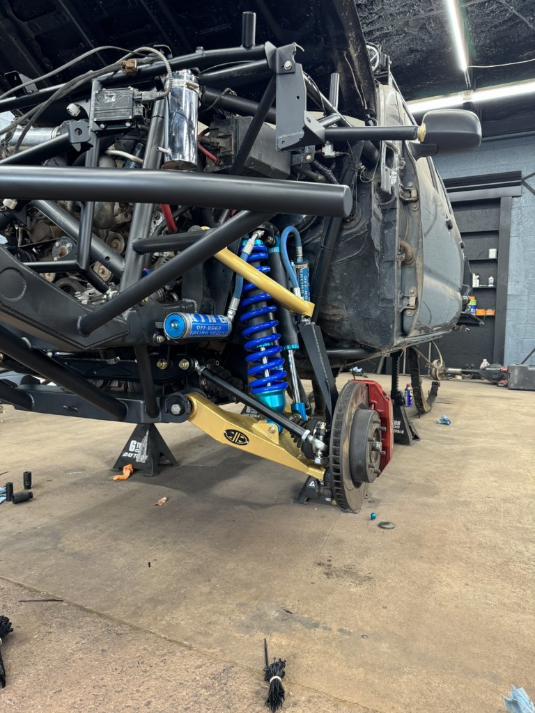

  16. Mar 18, 2025 at 7:01 AM
    906taco
    Jun 22, 2021
    #369289
    3,894
    Cory
    08 Taco
    It makes me want to puke knowing this truck pulls about 2” less travel than my +4.
    Man, buyers remorse sure sucks sometimes.
    SoonToBeOn39s likes this.

    What's your truck at? 12?
  18. Mar 18, 2025 at 7:21 AM
    906taco
    Jun 22, 2021
    #369289
    3,894
    Cory
    08 Taco
    A little under actually. And that’s putting everything on the line of questionable if it weren’t caged. Strapped up 1” and bumped about 3/8” from metal to metal.
    IvanhoeTaco[QUOTED] likes this.

  20. Mar 18, 2025 at 7:29 AM
    906taco
    Jun 22, 2021
    #369289
    3,894
    Cory
    08 Taco
    The one and only upside to the kit is the moved the travel range a little. But it sacrifices uptravel. Which I guess in the grand scheme makes fitting tires easier. But yeah.
    I setup another truck last year with a 2.25”, and basically ended at identical numbers to the +4.
    Is what it is I guess. Only room to improve, right?
