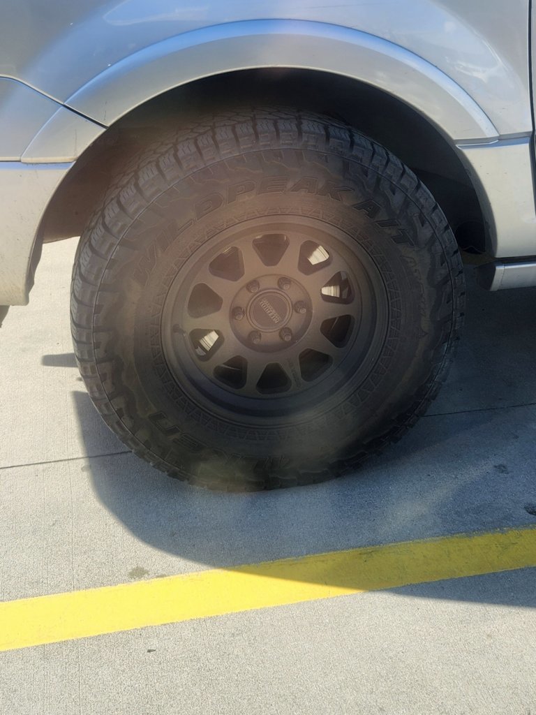

    look like method 316’s

    They are 10 spokes that all i know, looks like the 703 and 704 are 12 spoke

    Yeah but these have identical embossed “Method” text to the 316s and same center cap.

    reverse image search confirms it's an MR316.

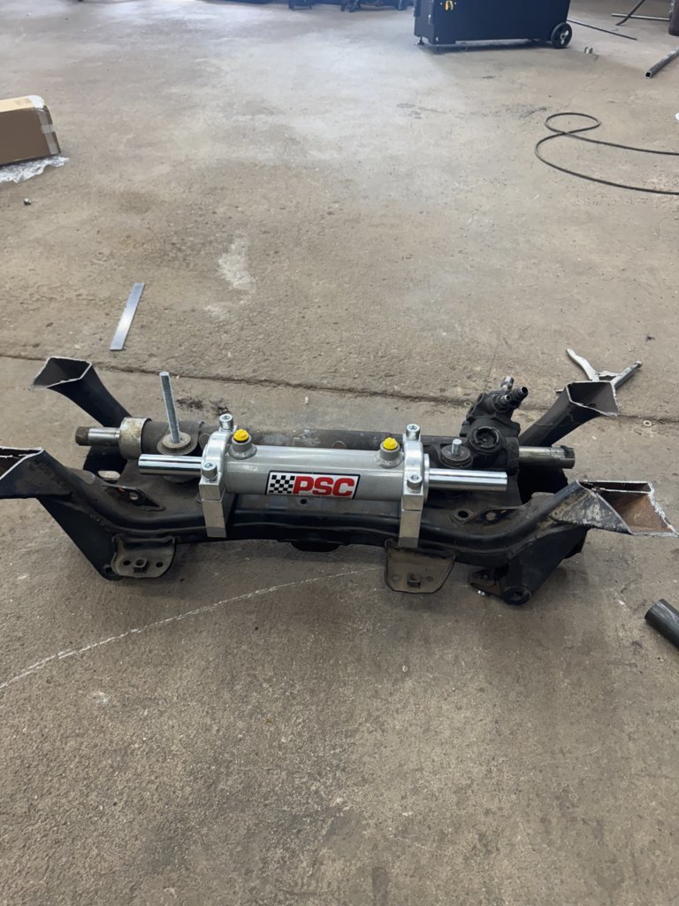

    Passing the next step off to my machinist once all of the chromoly and aluminum shows up. But, I really think this is gonna work. And on the relatively cheap side too. (Half the cost of a tundra rack)
    I will have a few sets of solid (aluminum) rack bushings available soon if anybody wants a set for themselves. Just let me know!

    Haven't messed with hydraulic steering before, so this may not even be a thing, but how do you adjust the proportioning between the two (if that's the right word) so that they aren't constantly fighting each other? Kind of like if you had different gear ratios in the front and rear diffs... They're both going in the same direction, but one wants to get there faster.

    Think he said the stock rack will not be hydrauliclly powered....it will just be a follower similar to the JD fab slide rack. But will maintain the mechanical connection so you will be able to steer if the hydraulic rack fails....albeit it will be steeering with no power assist.

    Right, so with a hard link to the stock rack that takes X amount of turns to go from lock to lock, haw do you get the hydraulic ram to match that and not go faster or slower

    Now you are out of my league...so I'm just gonna go with Magic at this point.

    The thing you’ve gotta understand is fluid only flows as fast as you turn the wheel. Depending on how the factory servo handles things it’s either going to be effortless steering if it flows enough. Or tighter if it doesn’t.
    All this is doing is taking power from the rack and putting it to a ram. Similarly to how my assist ram feeds from my box. Only my truck the box is also powered.
    From all of the port measurements I have done and comparing factory bore size etc. I feel we are going to be in really solid shape utilizing the factory rack servo. Especially with the monster CBR pump we are running.
    Absolute worst case scenario, we ditch any fluid going to the factory rack and utilize an inline servo on the intermediate shaft.

    No idea if I asked the question right, but that was the info I was looking for :thumbsup:
