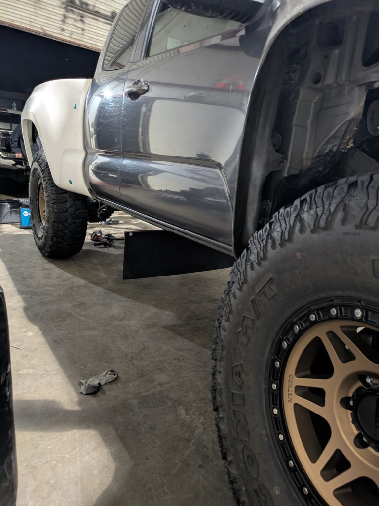

    I've always wanted underbody mudflaps so I made some tonight. Not sure what purpose they serve but I like the way they look sooo
  4. Mar 24, 2025 at 10:33 PM
    betterbuckleup
    betterbuckleup Well-Known Member
    Jun 26, 2017
    #222483
    4,791
    Ian
    Concord, CA
    2000 Tacoma SC 2.7 4x4 5spd
    Nice. They're on desert trucks to help prevent the whole rear end from getting sand blasted from the front

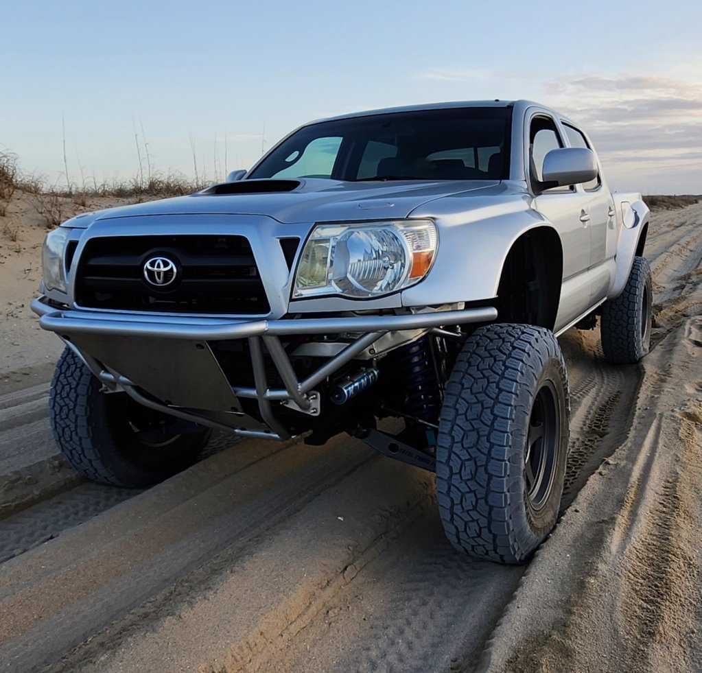

    I have some pretty good bro lean. Maxtrac spindle in the front with DK LT, LT spec kings lowest possible collar setting on a 550lb spring. 1" eye. DMZ in the back, JD towers with 14" bypass any suggestions to correct the bro lean? I know the maxtrac spindle is probably the issue, but there's gotta be a way to raise the rear a bit.

  7. Mar 25, 2025 at 2:46 PM
    906taco
    906taco Well-Known Member
    Jun 22, 2021
    #369289
    3,903
    Cory
    08 Taco
    Lower the front.

    Do you have pictures of how your truck sits?

    Jk. Please don't hurt me. As far as the spindles go, where do they have you in the travel range with your shock collars spun all the way up? Out of curiosity. Wonder where you'll be if you ditch the spindles

    2"x2" bumps? Yeah definitely cycle that thing once the hydros are in. Perhaps consider shortening the bumps to 1" stroke from the get-go because if you're already all the way up on the shock collar, that's going to put you into your bump zone very quickly.
