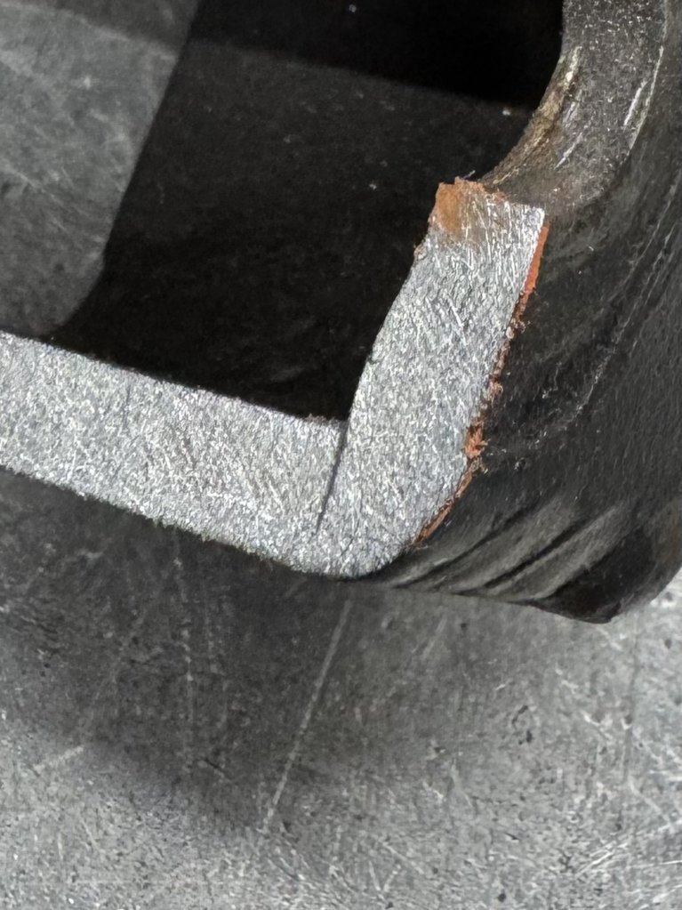

    I feel like such an ass doing this. It took me all day to say I’m gonna do it.
    It’s not the money. It’s the fact that the most loved person in my life was with me, all the time in this thing. I drove it at 65mph on the highway, we drove it hard in the woods. So many things piss me off in this situation. Honestly having a hard time wrapping my head around any of it.
    Just an upsetting place to be.

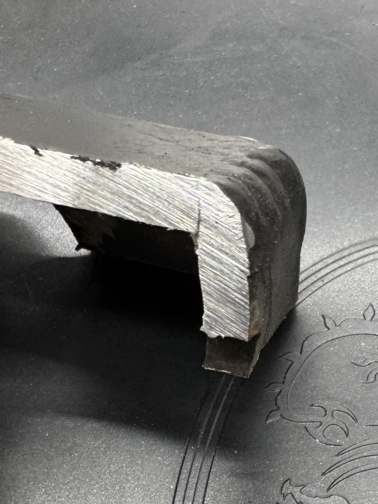

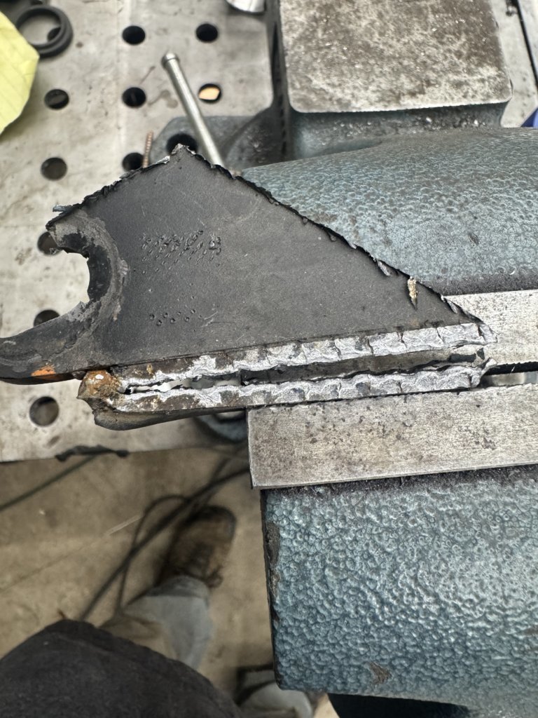

    Jesse absolutely knew I had a steering failure.
    Harry was the face of JD fabrication to all of us on TW. He was the guy we talked to when we had questions concerns etc. Jesse knew he was that guy. Clearly, it was a poor decision.
    These parts are ALL welded in the Tack and go style, which under no circumstances is considered kosher in the world of welding. You’re going to tell me Jesse or Dave had no idea this was going on when a MiG gun is pulsing 100x a minute? Bullshit.
    They knew this was happening, they knew this was going out the door, they knew Harry was the face of their business to us Tacoma world guys. That ALL falls on JD fabrication. Period. End of discussion.

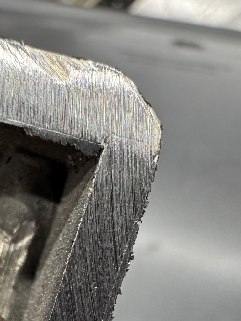

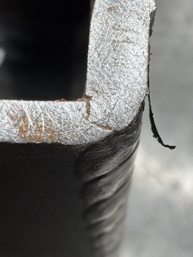

    I suggest taking a closer look at this part. You can see this weld was nothing more than a series of tack welds. The breaks can be seen the entire length of the part.
    My control arms, shackles, shackle hangers, slide rack and more were all done with their signature stack of dimes weld style.
    Another JD LT truck I worked on, same thing.
    I am going to reiterate this. It’s not kosher, literally ever.
    There is a 0% chance the owners didn’t know this was going on. Absolutely zero. Unless they had virtually no presence. Or know nothing about welding.
    Scary part, it’s super highly unlikely that my parts are isolated. I’m just the first one to cut shit apart to check the workmanship.
    Shitty welds can seem strong for a long time. Until they are fatigued enough and the part splits at every seam.
