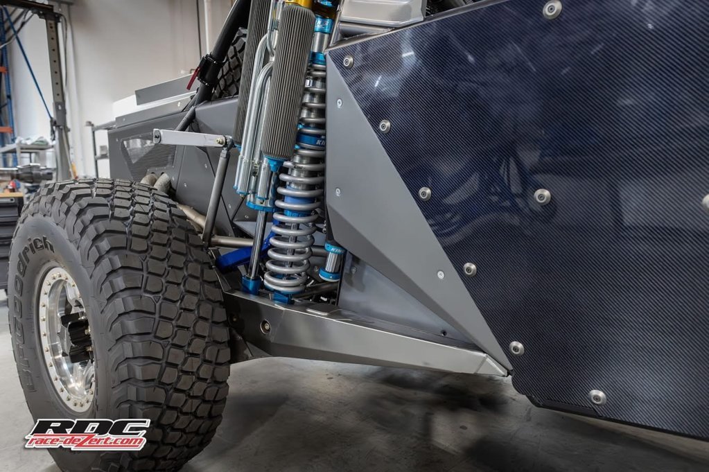

    on a 5-link too.

    He does some wicked cool stuff.

    there are too many pivots in too many planes for my little noodle to understand this

    Pretty well cooks my brain a little too. Reminds me of when I owned a BMW…..

    Wonder what kind of oil weight and pressure he's got with that much multiplier

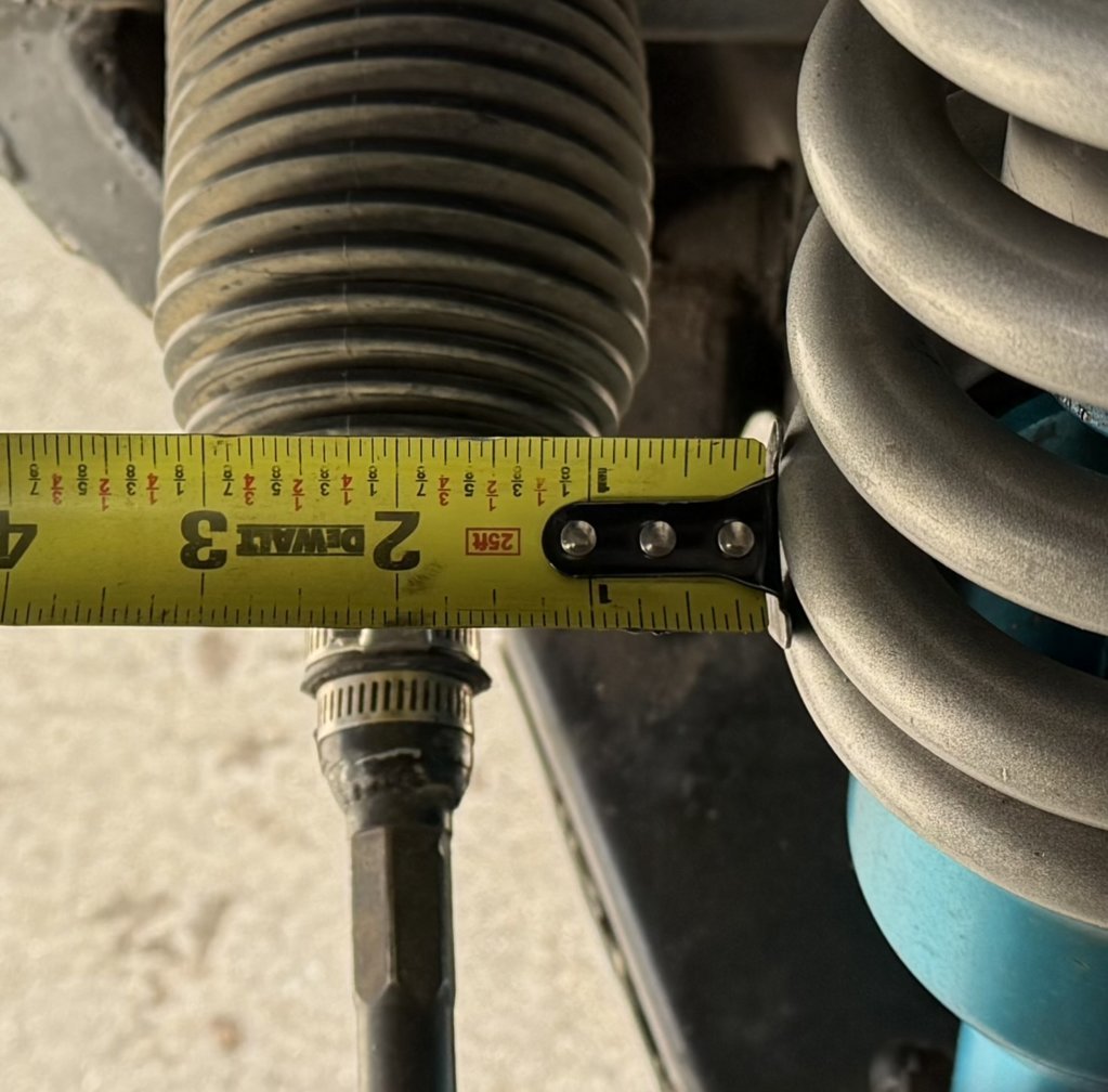

    I have lots of room, if you have the JD pivots they would be closer, but I have around 3" clearance.

    Most issues come into play with heim steering because they are usually 1.25 or 1.125 diameter.

    And shorter coilover rod ends, no? My coilovers go down a lot further and I get some coil-to-TRE kisses when I had the wheel cranked and a poor alignment.

    Good points, I’m 1.75 from coil to edge of tie rod.
