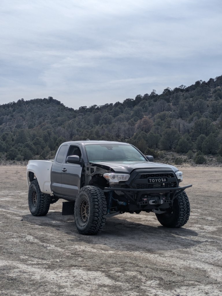

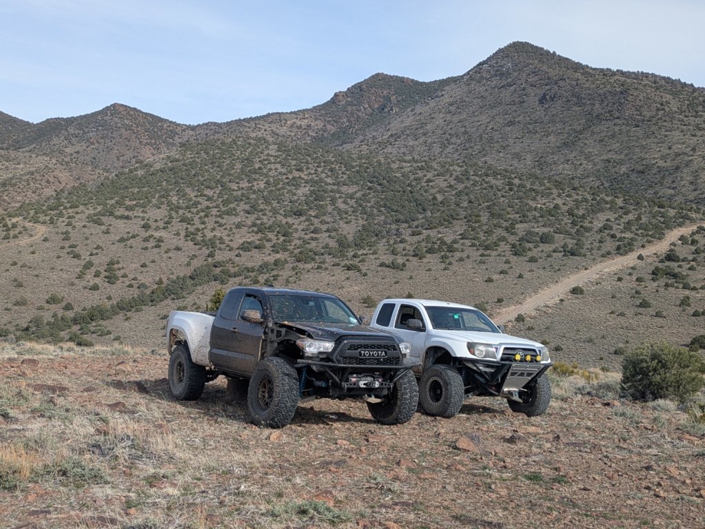

    Ran some of the Vegas to Reno course backwards today. Only about 60 mile round trip but it was fun

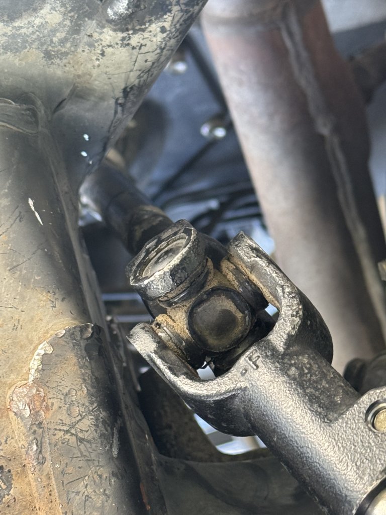

    Just finished up on the Solo Motorsports Tundra Steering rack on my gen 2. overall hardness rating was a 7/10. It was definitely a time consuming job. As many had told me before, it was a process. I was able to easily fit the rack in the correct spot on the crossmember after grinding down the barrels the OEM rack sits on. My truck is a 2wd 4.0 V6 as well that helped with that. Only issue I ran into was with the steering shaft and the frame. After shortening it, it WILL rub and the only ways to fix it is to either notch your frame to fit the shaft.. or to remove the ribbed, crumple zone and re-weld in suitable stock. I opted for the second choice as notching my frame was not something i wanted to do. Overall again, not too bad of an install. If you have prior experience with r&r of a tacoma steering rack it will not be that bad. Just take it slow and catch yourself from making small, detrimental mistakes.

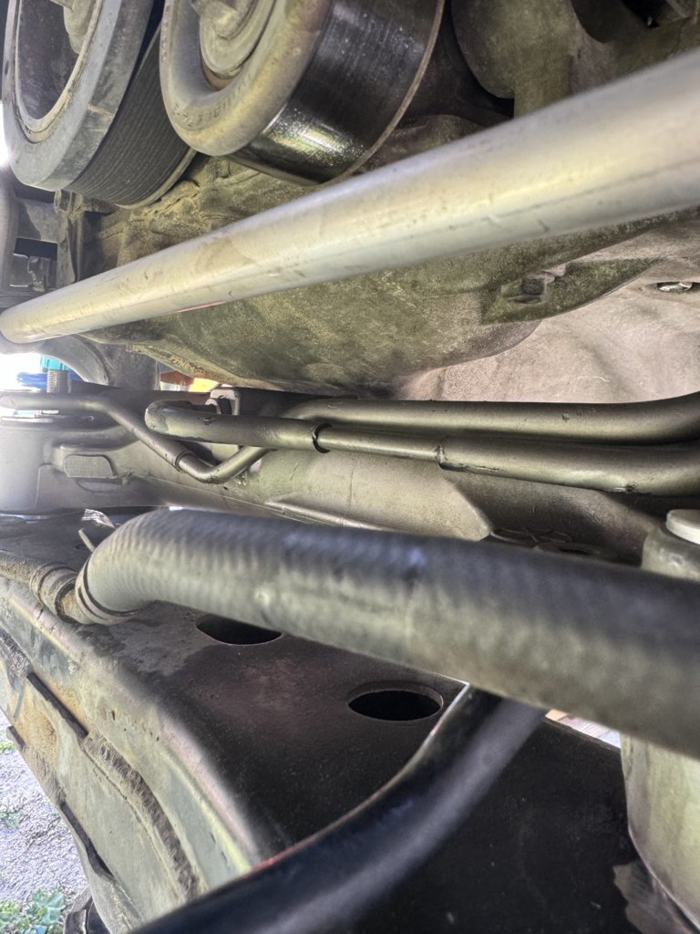

    You can see my motor clearance and steering shaft clearance here
