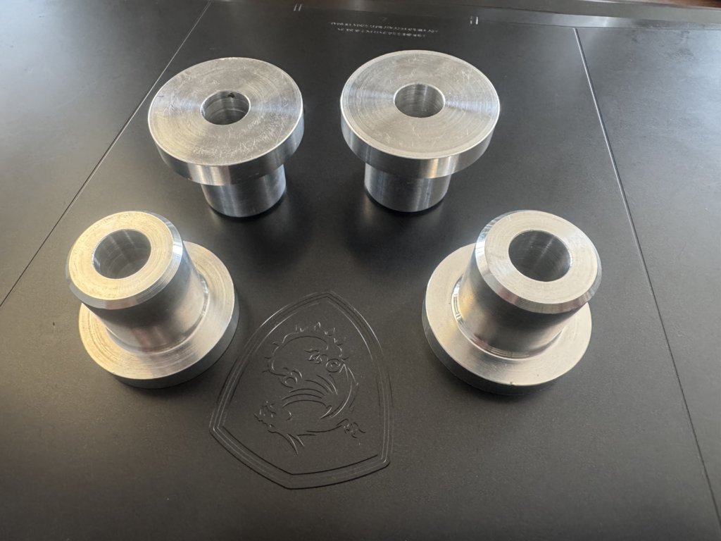

    Going to be having a full batch of these billet 6061 steering rack bushings made. Sized for 1/2” hardware. If you’re interested, feel free to DM me.
    We also have some other things being machined that will add substantial support to the factory racks. This won’t be an end all solution. But it will certainly aid for many.

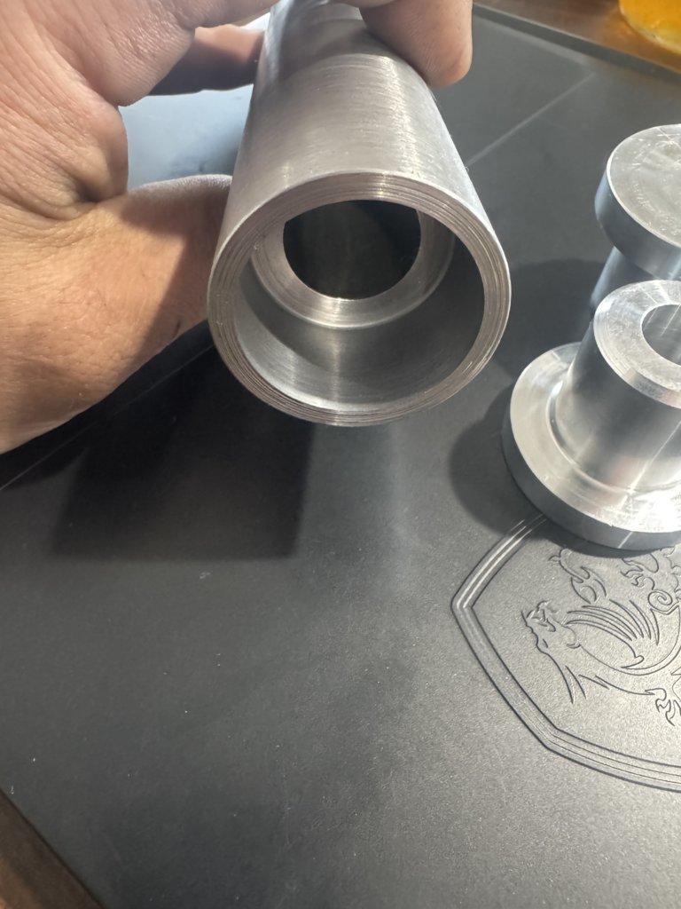

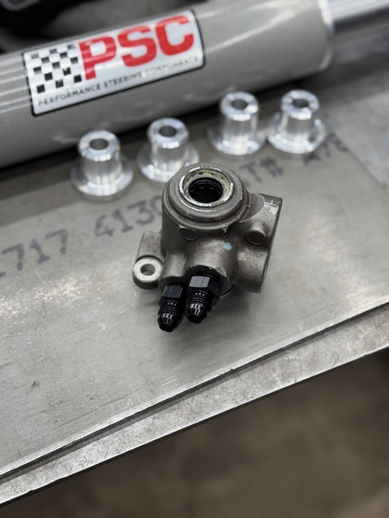

    Got my 4130 ram extensions back yesterday, he nailed the sizing with these and we are dead on with the factory rack width now.
    Also managed to find off the shelf -6 to metric fittings for the servo feed ports.
    Everything is a go on trying something kinda new.

    I always wanted to try and add a ram to the stock rack, but just never had time to dig into it. I assume that's what you're going for?

    Depowering the factory and utilizing the factory servo to power the ram.
