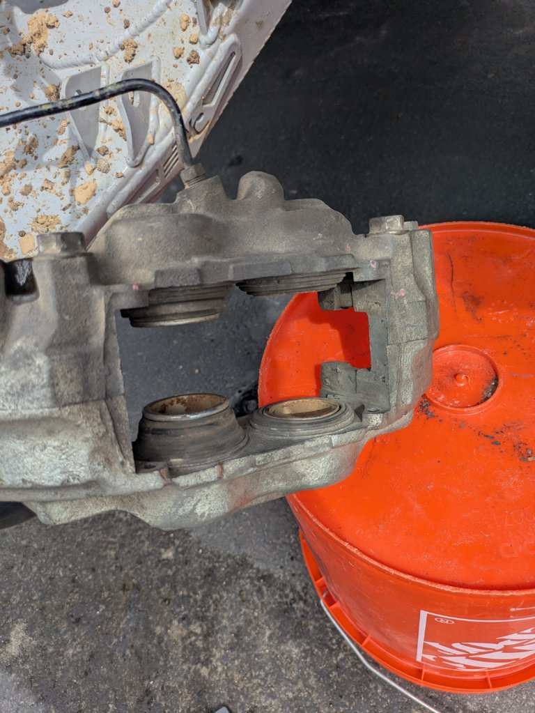

    I would've gone that route but I just went to napa and got a caliper. Thank you though

    third on the bigger oem brake upgrade.
    It’s not crazy, but before I couldn’t lock up the 35”s and now I can.
    One place I’d never skimp is the rotors, high quality rotors with decent pads + the 4Runner/lexus calipers are a good upgrade for like $~500 or so

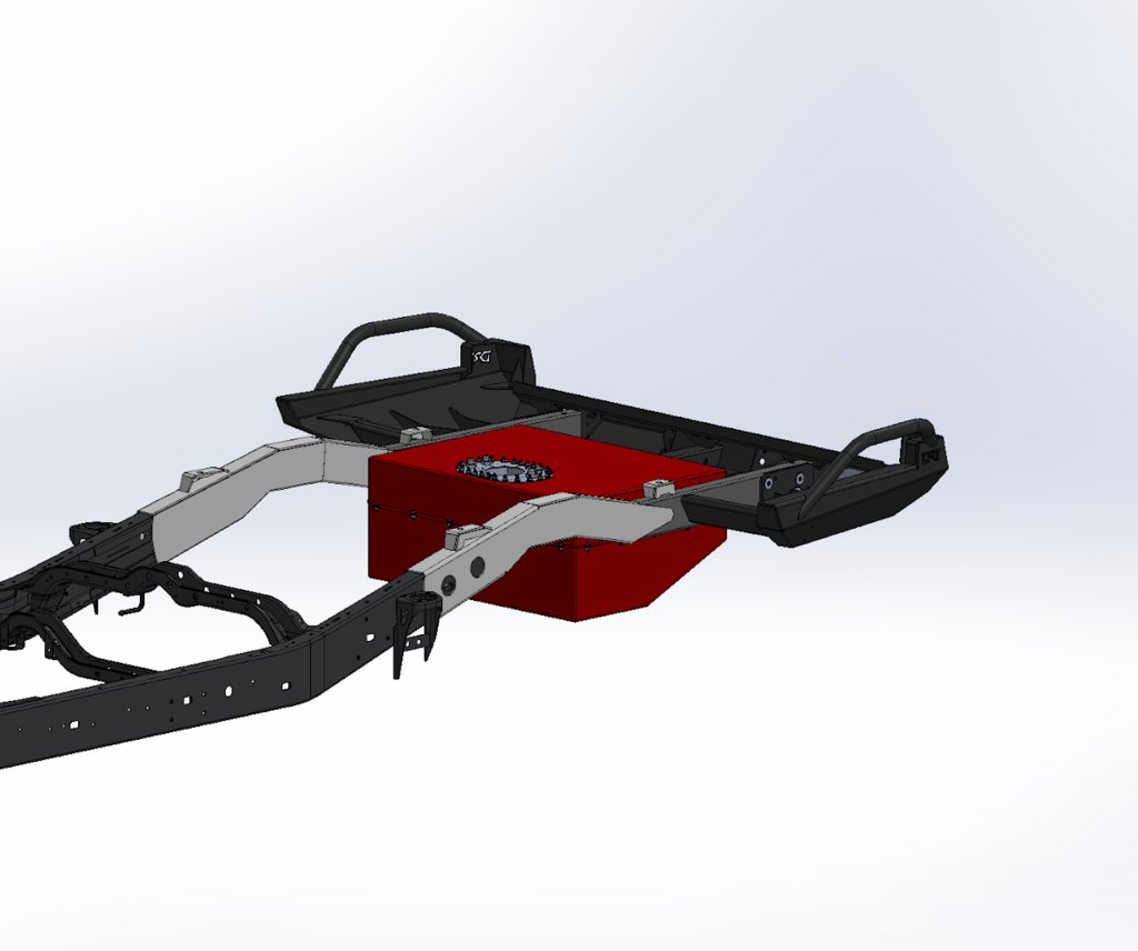

    Can you make this installable without removing the bed :rofl:

    If it failed I have a set off my truck with 50K miles on them you can have, along with the rotors. I upgraded to the 4Runner front calipers and discs.

    I mean the bed will bolt back into place.. close enough

    I want a fuel cell so bad, but I am never taking the bed off my truck again. Coolant bulkheads, ATF bulkheads, AC refrigerant bulkheads, plus the shocks, bed cage, tire cage, way too much bullshit to even think about taking the bed off

    Just take the bed out haha and leave it out.
