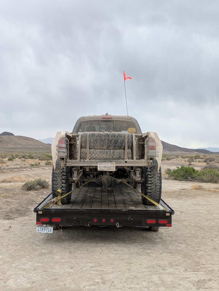

    Whenever I fix my inner fenders. After this trip my core support has decided to split off the rest of the truck.
    I see an engine cage in my future

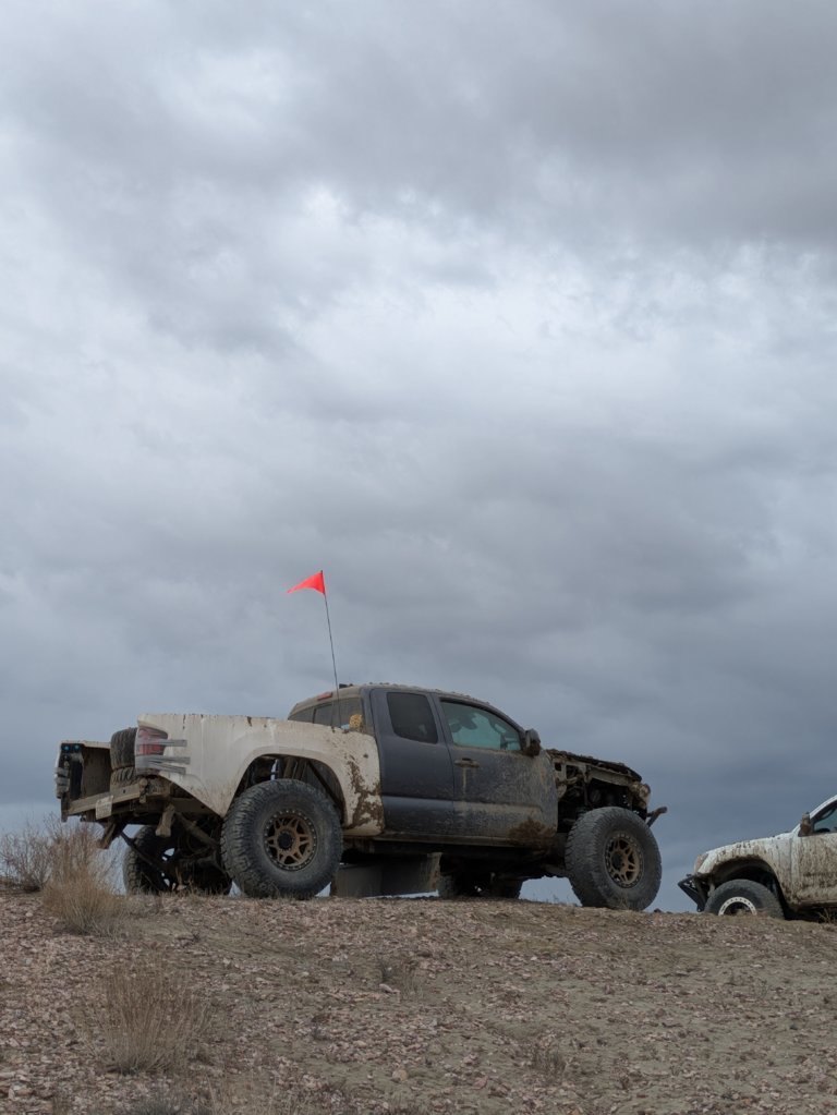

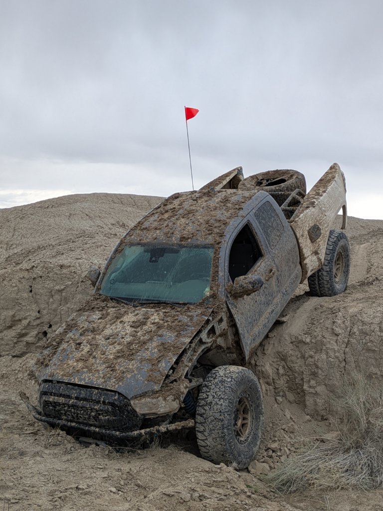

    Solid desert trip

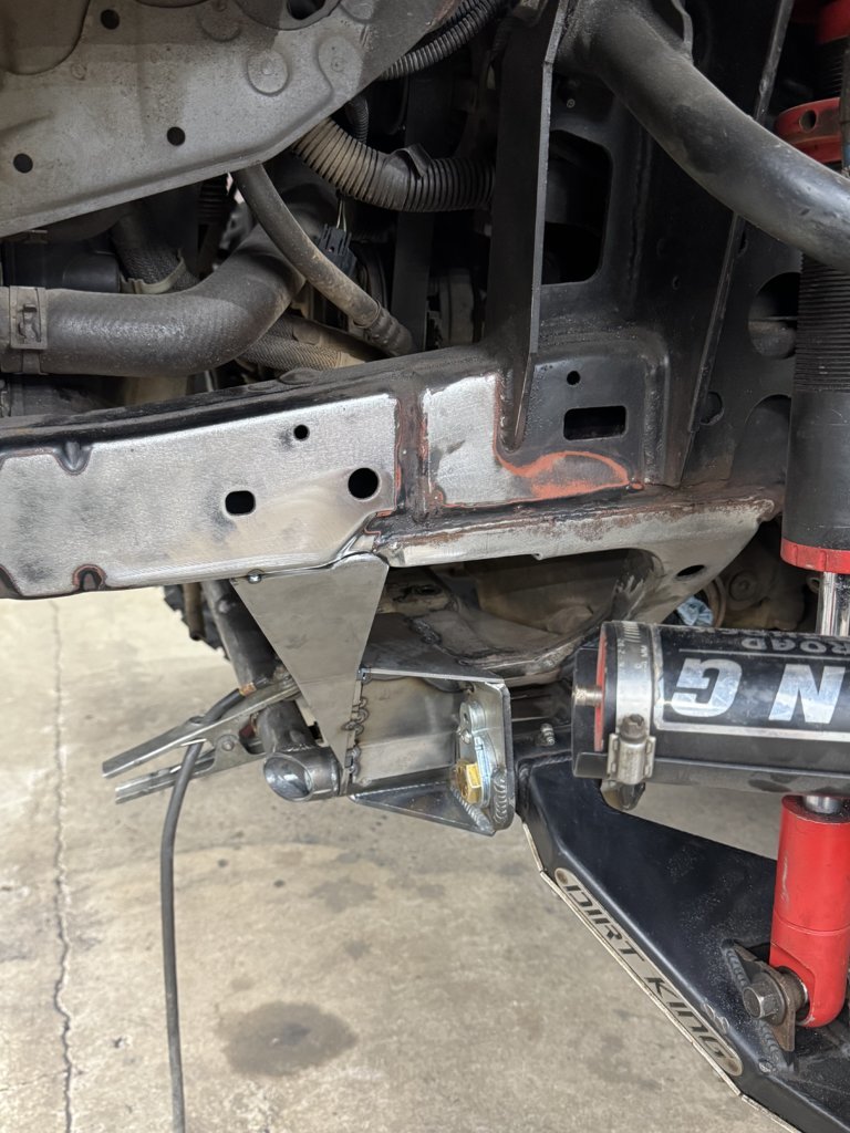

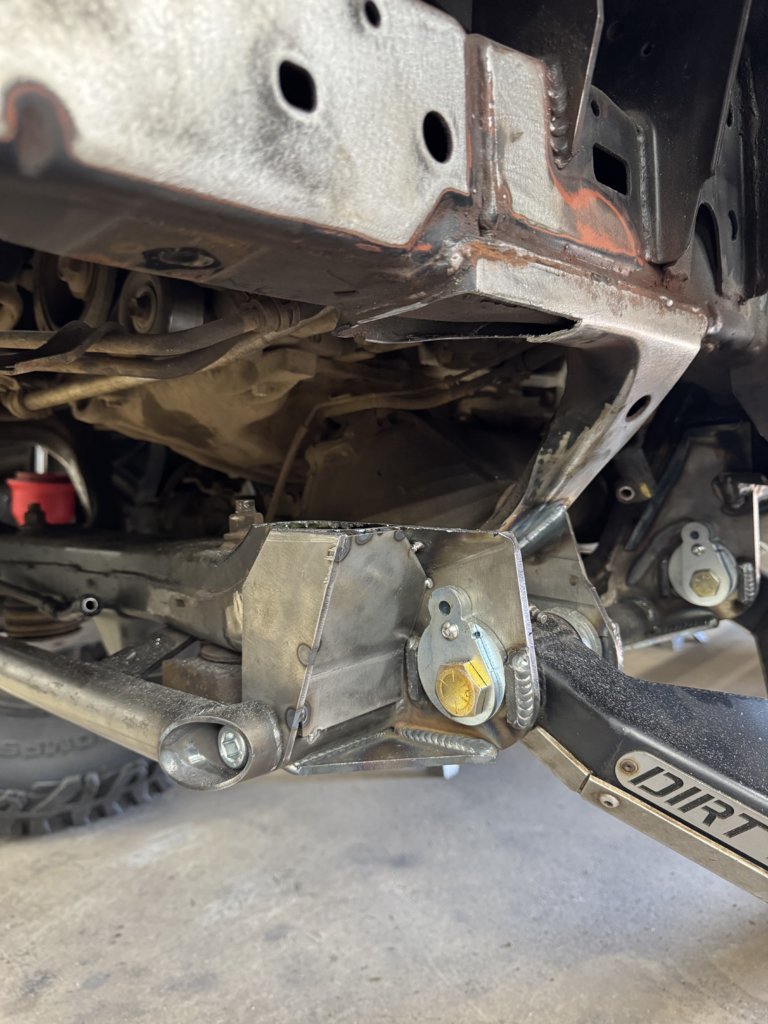

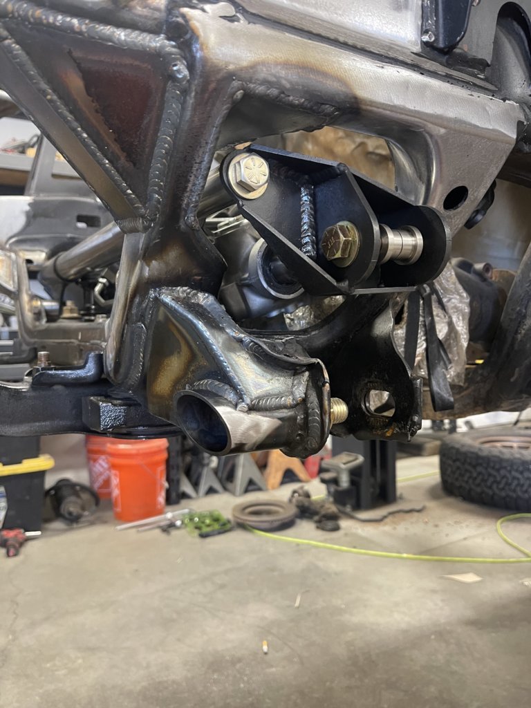

    Still pretty crude. But I’m sure you get the idea.

    Kinda looks similar to what I got going on

    The pivot gusseting is sexy AF!

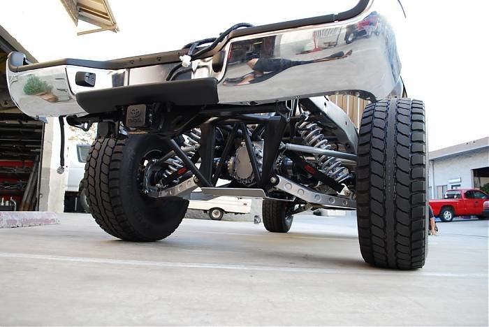

    Other than costing a lot, how bad of an idea would IRS be? Thoughts?

    I think about this a lot. IRS or a dedion setup is in my 5 yr plan for my truck.
    The major hurdles are: yes, costing a lot, and getting the truck balanced and light enough that your spring rates aren't ridiculous, shocks are actually tunable, payload doesn't go to shit. Packaging the shocks is a little tough as well. Other than that it'd be a relatively easy job for a decent fabricator since there's so much room. The way Toyota did theirs (posted above me) looks like it would work really well and is fairly simple
    Easiest way i've thought of so far is Sequoia or Tundra front end; like diff, spindles, axles, then flip the diff upside down and fab up the rest. You could probably even get away with buying an off the shelf Tundra LT kit and just fab up the mounts. Very surprised nobody has tried that yet
