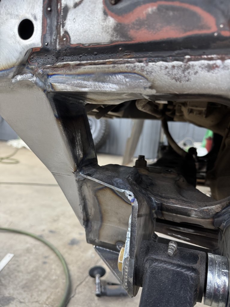

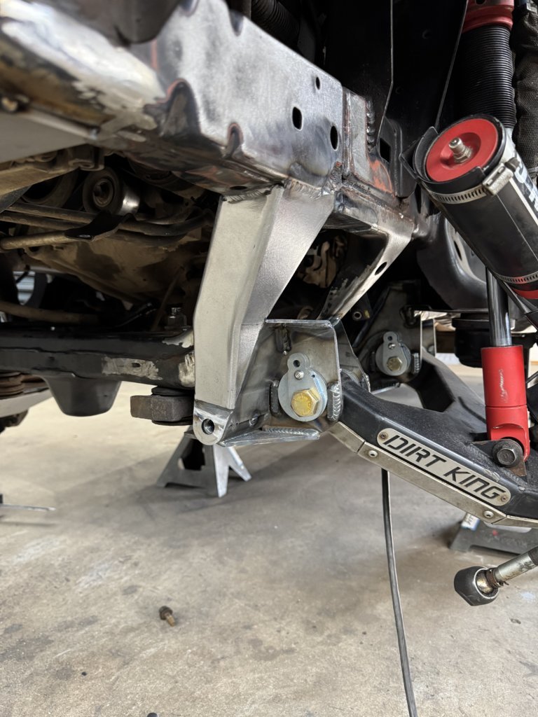

    Making room for the new steering setup going in this truck.

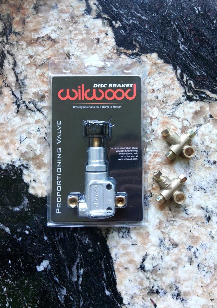

    I got my Tundra booster and cylinder swapped and the abs module eliminated. I just added two 'T''s like you said. On initial test drive the front tires locked up on the pavement. yay! In the dirt I could mash the brakes and finally get the rear to lock up. So my thought is I need more rear brake. A proportioning valve will allow you to reduce pressure to the axle it's installed on. So I'm thinking I want it on the front to back it off a hair to give the rear a bit more braking. I'm open to discussion on why this wouldn't work.
    I never thought of that. I 100% should have done that. This would also only have 1 flex line to the axle. Next go around I'm changing my set up.
