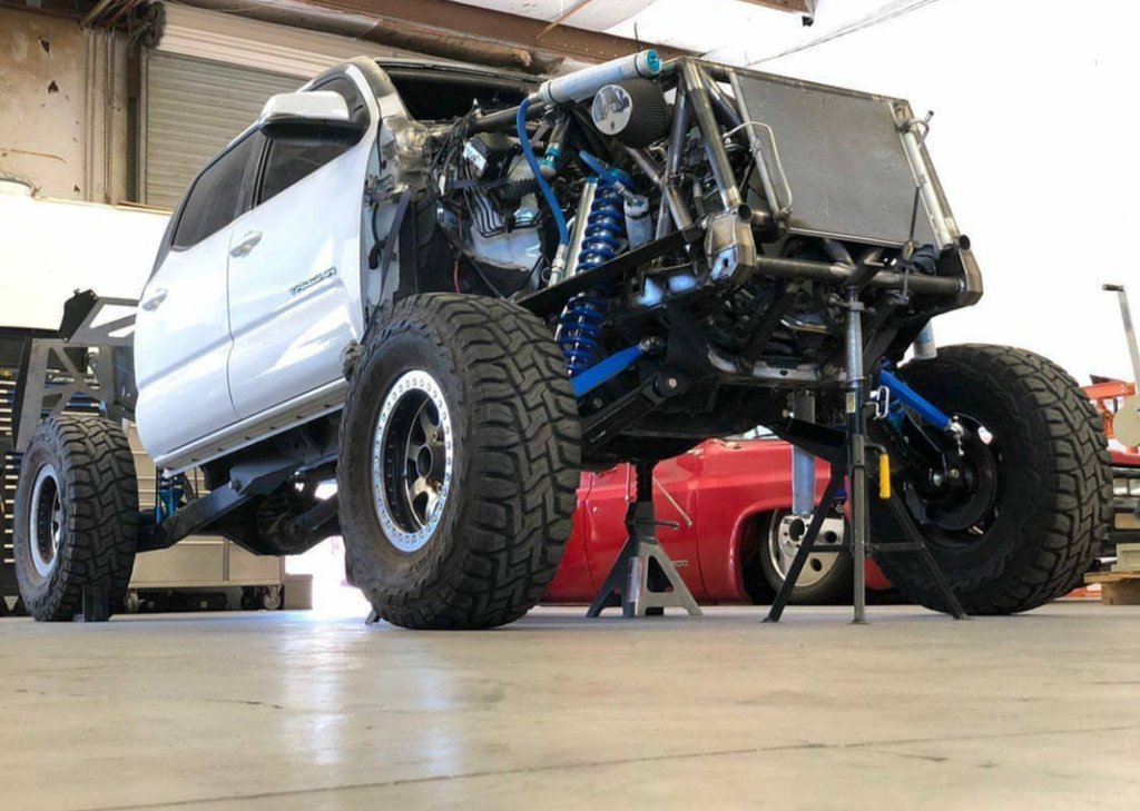

    I'm looking at this old build that Lsk and Est fab did. That engine cage looks solid.
    I'm at the point where I just wanna build something where I don't have to worry about the weak core support/inner fenders breaking

    My next core/radiator support will look something like this. But as @Naveronski said above it's taken 15 years for me to shred my 2nd support.
