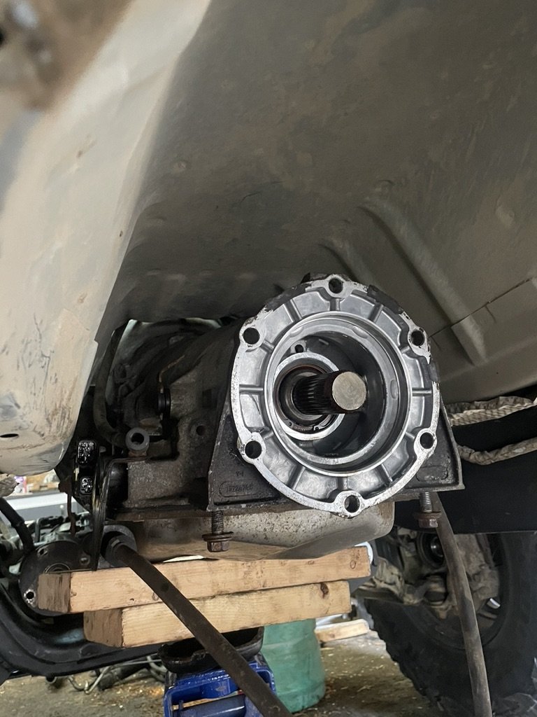

    The 4L80e bell housing is the biggest issue for space in the tunnel. I massaged the fire wall / trans tunnel in order to get the engine + trans as far back and down as I could.
    I think that with more time and willingness to cut some material from the tunnel, you could get close to a flat belly.
    When you compare the A750F ( what I had) and the 4L80e beside each other, it's quite a size difference. I cut the OEM transmission cross-member out but @Pittsy I think used his OEM and added a spacer to the top of it.
    Should you go down this route I can give you more specific info should you need it. I kept notes for most of the build and resource pages, just haven't had time to put all down in one place.
    This isn't where it ended going but might help you understand what I am saying.
