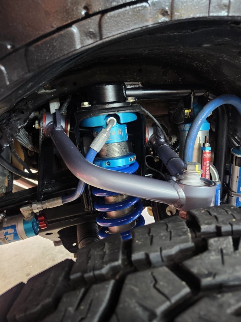

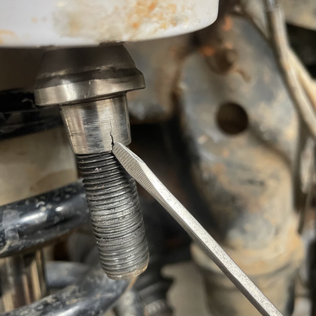

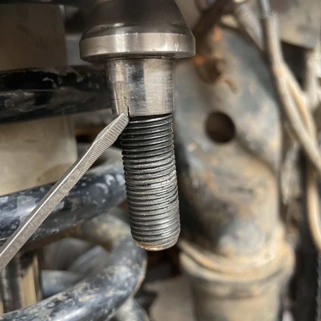

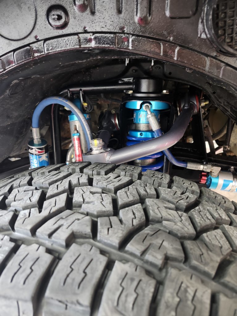

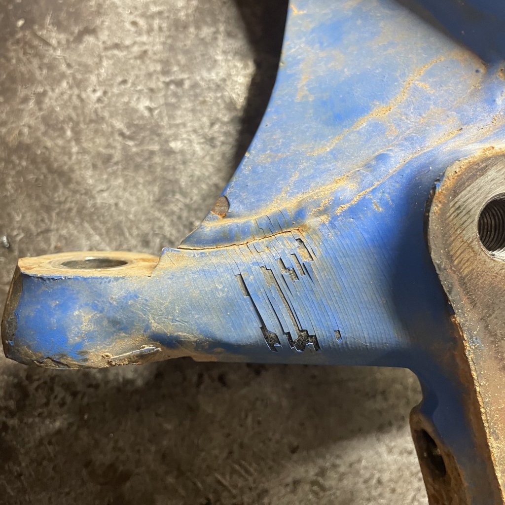

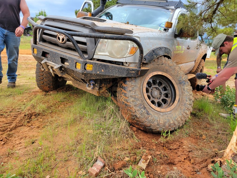

    DJ would probably perform fine in the upper control arm, but as you saw from Jambo, the lowers need to be as strong as possible. Here’s some pics of my upper on the side that took a hit. If you look closely, you can see the bolt is bent. Also the gusseted spindle, you can see where to tie rod arm bent.

    brutal. what was the actual failure mode here?

    but what actually broke?

    The LCA Uniball bolt sheared. That’s what ripped the wheel out of place. Which in turn pulled the CV out of the inner cup. Also upon impact, the spindle bent at the tie rod arm. Also the pictures above show the UCA uniball bolt is bent and the spacer is cracked. Other than that, front bumper bent some, but did its job protecting the body.

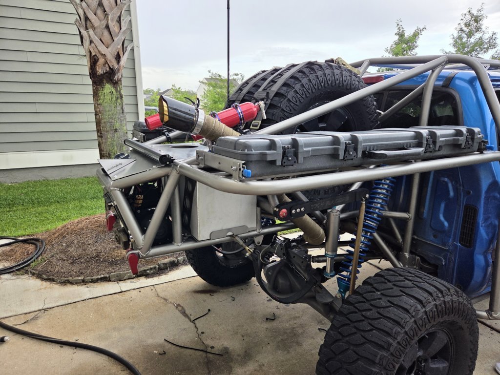

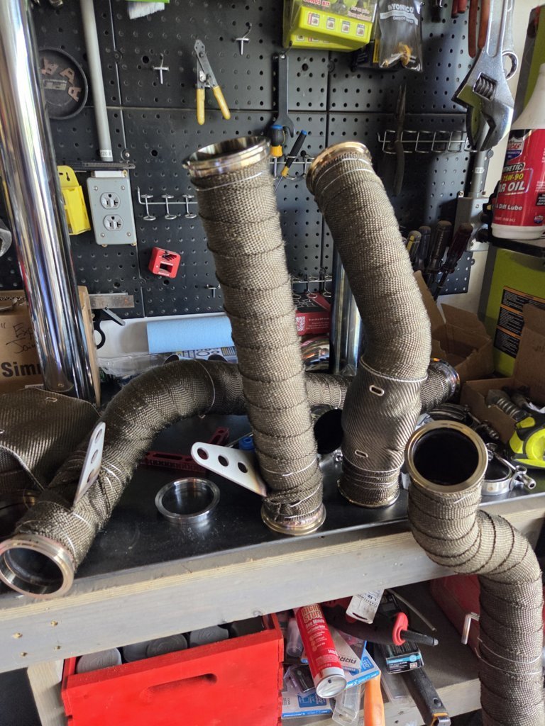

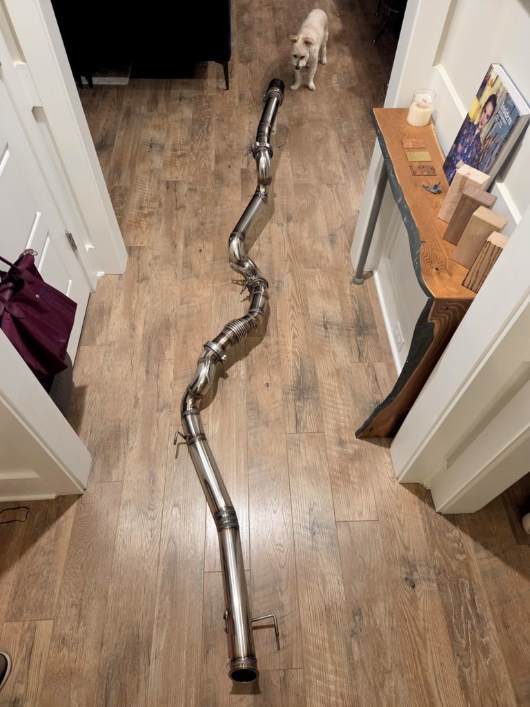

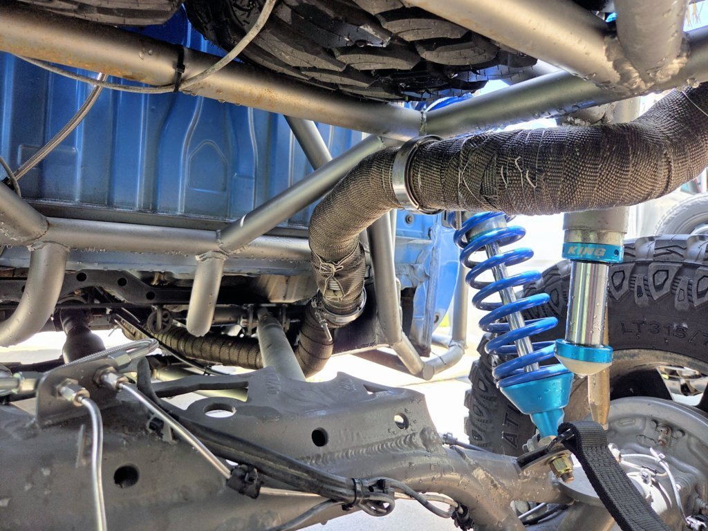

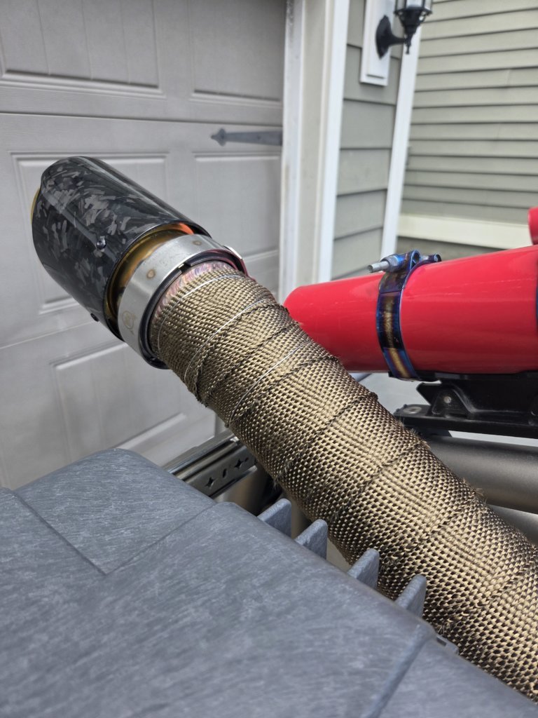

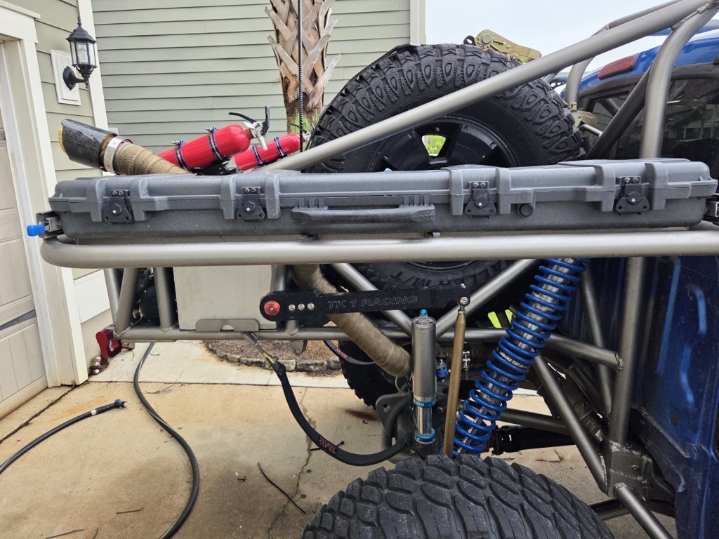

    A cautionary tale. Links can make exhaust hard. When I designed the link geometry and back half, I prioritized functionality (which you should), but I told myself "I'll figure out the exhaust later." I urge you to think about the exhaust when you are designing the rest of the truck...at least a little bit. I built myself into a situation where exhaust routing got very complicated. 20 changes in direction from the collector to the exhaust tip, and extremely tight clearances in a number of places. Also had to build it in four sections to even be able to install it.

    But why though? Why not just have it dump behind the cab (second pic quoted) and leave off the whole "rainwater collector" you have going up toward the rear?

    Good question. I had it dumped like that for a while. Few reasons for the changeup.
    Its a lot quieter in the cab than when it was dumped. Noise wasn't a huge driver, but my wife says it's a lot more enjoyable now which is always a plus.
    So much exhaust soot on the axle and suspension with it dumped. So less cleaning now, and with how salty it is around here, removing corrosive exhaust gasses from the equation will only help make cleaning and rust prevention easier.
    The tip has about a 10 degree overhang, so it will collect the same rain water as a bedside exit exhaust. The little bit of wind-blown rain that does get in won't make it past the bellows that sits behind the cab.
