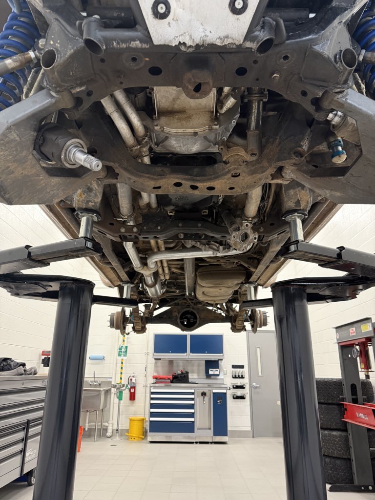

    does anyone here have a good thread they used for pulling and reinstalling their front diff? I’ve got the idea on how to do it, I just want something I can reference while I’m doing it. I’ve got a couple obstacles in my way that a normal Tacoma doesn’t have, so while I’m buried trying to work around that stuff I’d like something to reference so I don’t miss something stupid.
    and those of you that have done it, is removing the two LBJ adapted bolts out of the spindle enough to let you pop the axles out of the diff? Or did you have to take the axle nut off and the axle out of the hub too?

    I always pull the axles all the way out. Never tried leaving them in the hub, but that sounds like a nightmare of a time.
    Pulling the diff is pretty straightforward, I can do it by myself in about 45 minutes.

    hopefully you can get your rear mount out without having to lift the engine, with the ls that’s been my only way to get it down. Remove the rear mount entirely than just lower it down with a jack.

    I’ll just do that then
    i mounted the LS above my steering rack and slide rack, so I should have plenty of room to snake it out hopefully

    You guys were right. I was way over stressing this. 3 hours to pull both for the very first time ever.
    new thirds come tomorrow and should be gtg
