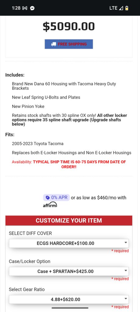

    I finally got bigger tires 2020 Long Travel Tacoma 1997 MAGNUM
    Nah that's the price is shows with my options
    Sorry not tru trac, meant spartan
