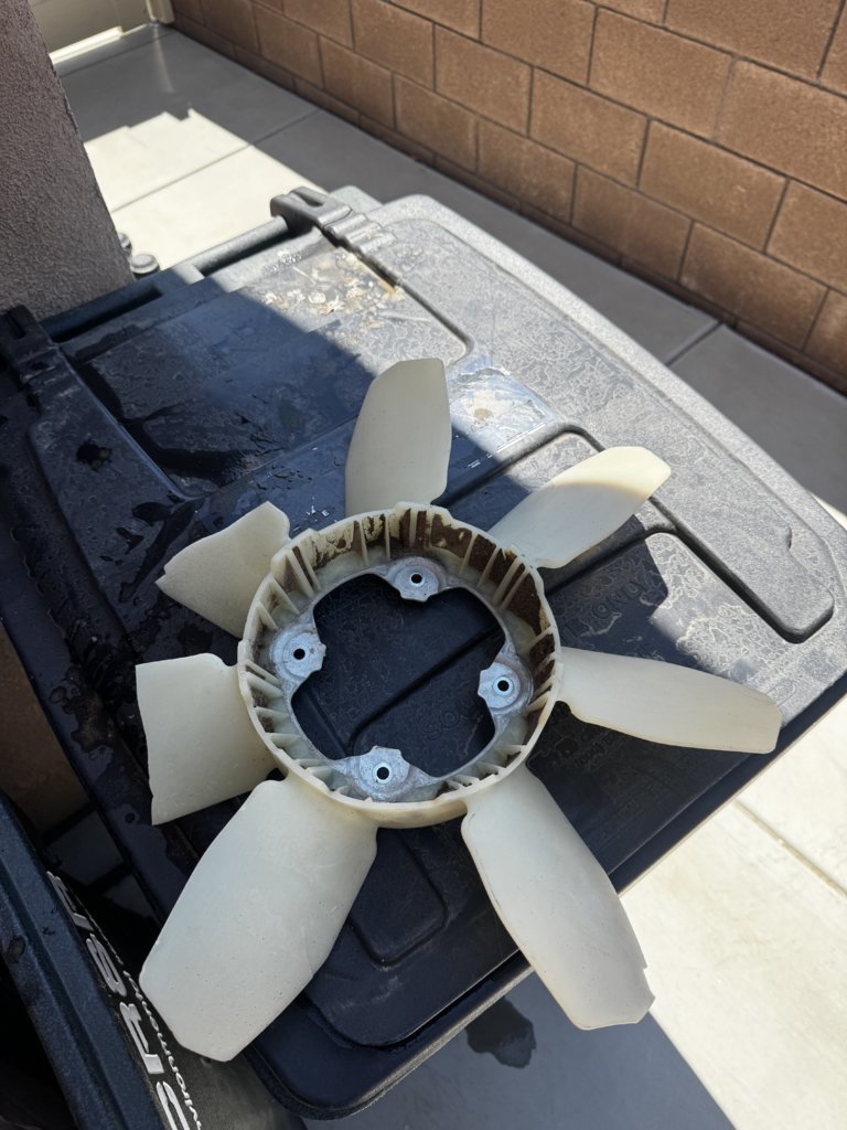

    Been chasing a weird vibration for over a month….last night my radiator sprung a leak. Swapping out the radiator I found this.
    Miraculously the vibes have disappeared.

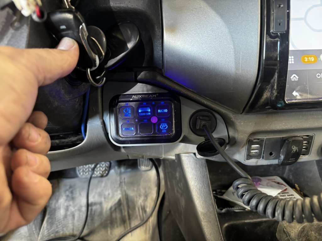

    mine are run by a ecumasters pdm that’s mounted under the dash.

    Bought this little panel off facebook for 30 bucks. Perfect fit for the Auxbeam panel and also has a plug for my radio mic.....comes with cord that extend it to your radio. Pretty good deal IMO. All 3d printed and well thought out as far as how it attaches. Metal backing plate tapped for bolts and countersunk screws holding the panel portion with nubs that drop into existing holes the OEM panel used.

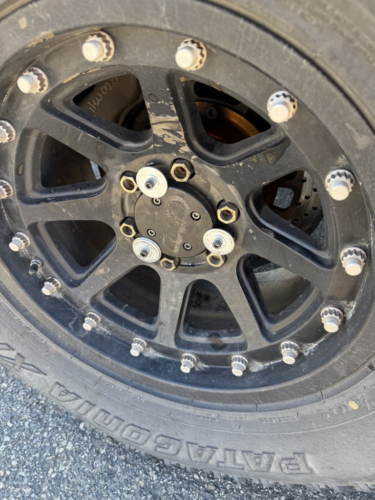

    Are those Patagonias 37x12.5? They look skinnier than that

    Yep.

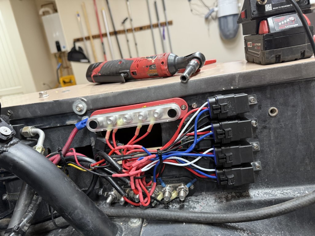

    Messaged the same on the gram but for anyone else interested, I’ve been using these for a bit, they custom code it to how you want to use it.
    For me it was just a simple 2 channel input/output relay. solid state, fully potted, sealed moles connector.
    everything you want, except for the mounting holes are tiny, and no one seems to know this brand, and they aren’t exactly off the shelf as they program to order, which is good and bad.

    yeah but can they take the inrush current to run big fans? My spal fans on my Ron Davis radiator have like 75 amps of inrush current, when I was on fuses I had to run 35 amp fuses or they would blow during startup of the fans.

    Dont quote me on this but I think you can have them pwm the startup to however you want to soften it up too.
    The two channels can be tied together in parallel as well, with different options for input triggers for example if you’d prefer a ground signal instead.
