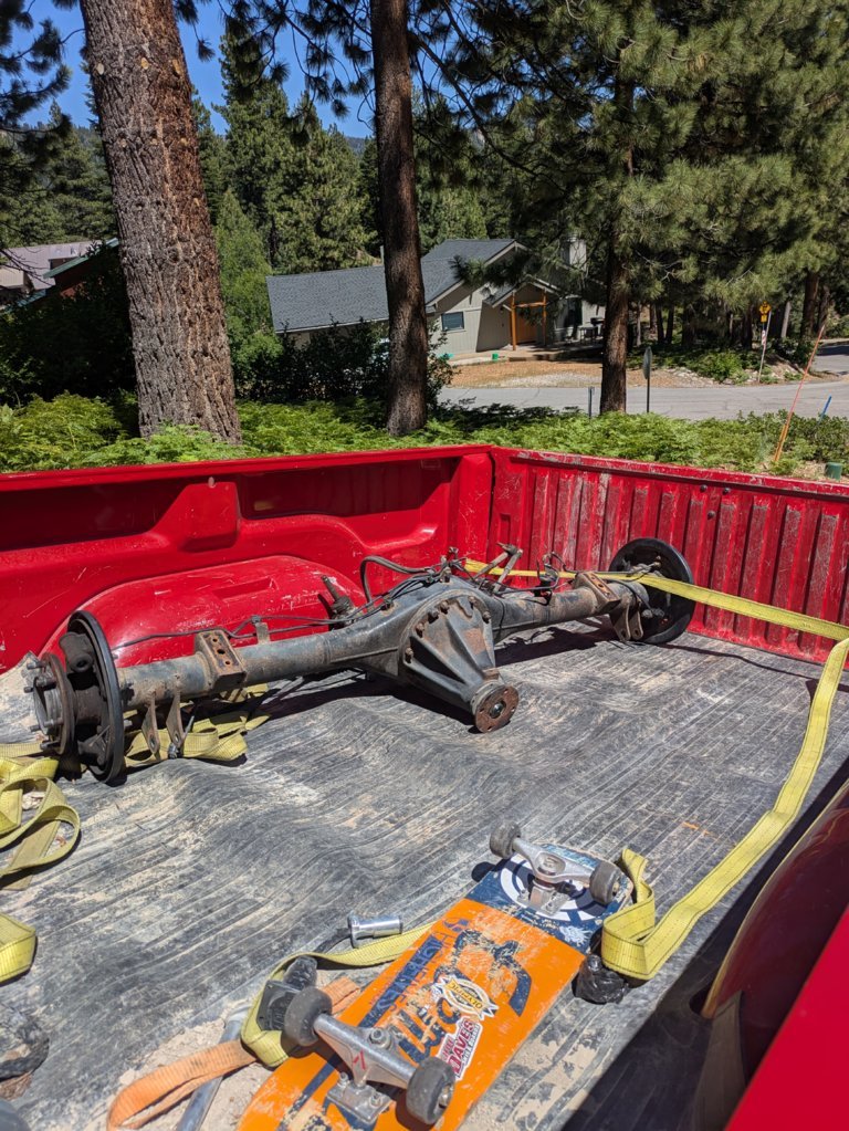

    I picked up this 2nd gen tacoma 8" axle for $125. What's the chance a 2nd gen 8" 3rd member will bolt onto a 3rd gen 8" housing?

    That's the 8" E-locker 29 spline? Might be the same if your original 3rd gen diff was the e-locker. Don't know if they changed the e-locking diff between generations. The open diff that came on other 2nd gen Tacomas is 8.4", which is a little stronger/more common.

    No e locker. So I guess it's an 8.4?

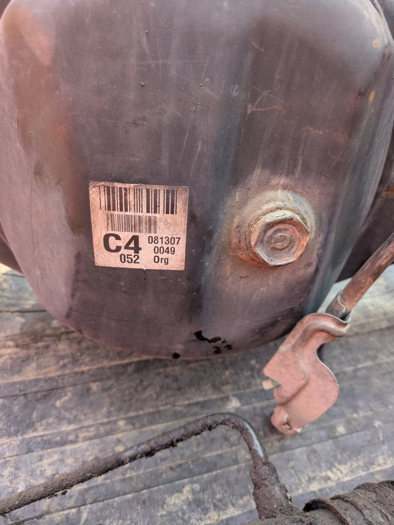

    This is the code

    3rd gen e-lockers are 8.75 I believe, everything else was the 8.4. It might fit if you're a non-OR/pro, but probably not?

    3rd gen sports with the manual transmission had an open diff in the 8.75

    after further research I believe it's an open 8.4. if someone knows more please correct me haha

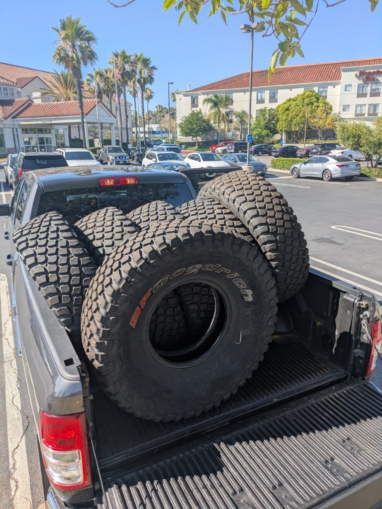

    40s are gonna be fun

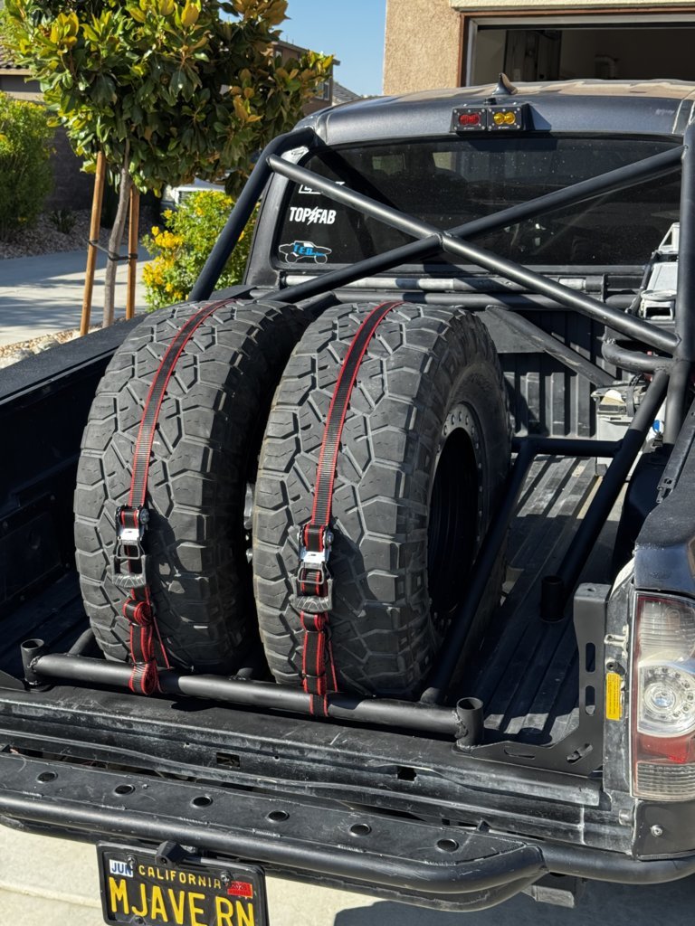

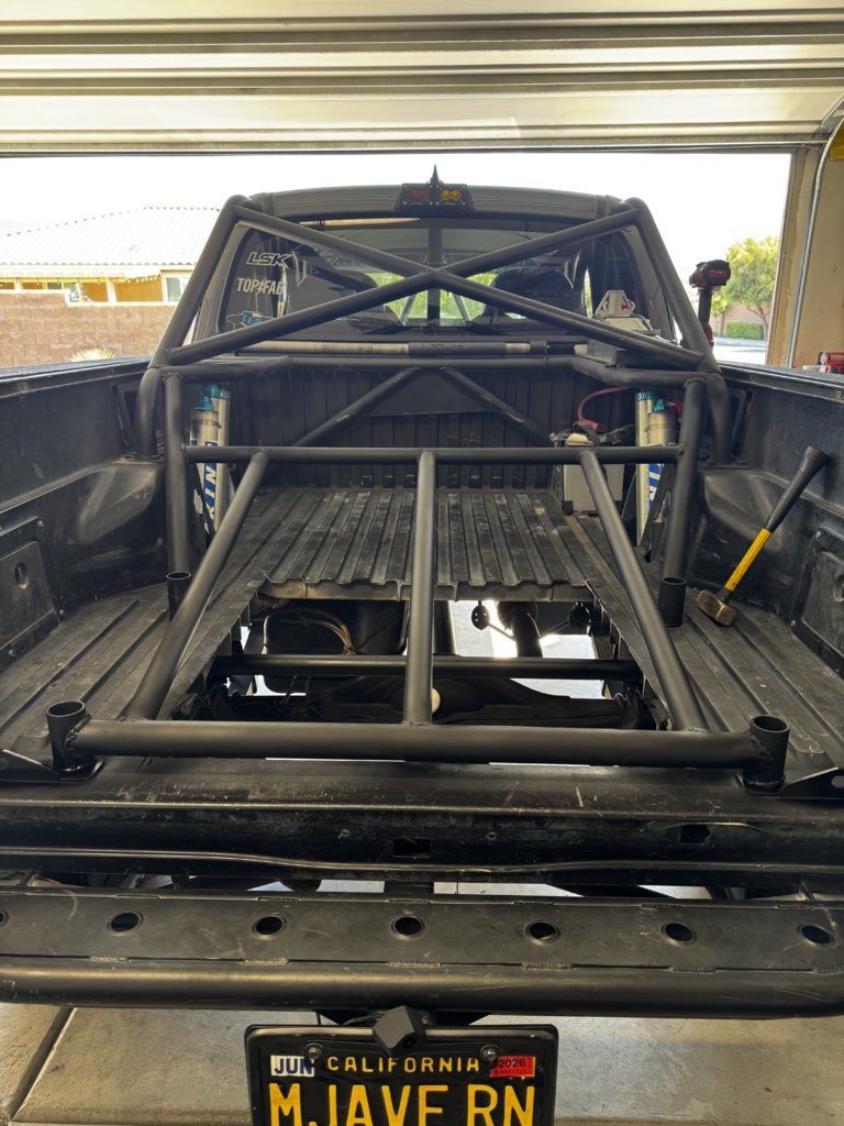

    Did some cutting, tube work and welding today. Made a tire rack. Pretty happy with how it turned out. Just gotta buy better straps. Ones I want are $150 each :eek:

    Saw your IG posts. I wonder if I could do an install of a fuel cell in the same manner. More fuel and weight in the back would be nice.

    yeah I did my cell in about the same spot, but I didn’t cut a top access yet, I probably will eventually so I can actually access or remove the tank if I need to.

    Might be the ones you're already looking at based on the price, but I love the Mac's straps. I have two vertical spares and they have never move or shaken at all.

    Just a couple hours ago I submitted for a quote on the Mac websit for 2 of those types of straps custom made for my setup. Thxs for the heads up

    Look at that sexy beast!
