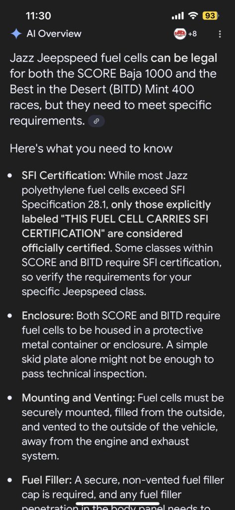

    no AI here. Straight from the Score website rule book
    CR 21 FUEL TANKS Safety fuel cells are required for all fuel tanks in all classes except Sportsman UTVs, Moto and Quads.
    Auxiliary fuel tanks may be added to a vehicle in all classes except Class 11. Auxiliary fuel tanks must also be safety fuel cells. All fuel cells must be securely mounted, filled from and vented to the outside of the vehicle, and have a substantial cross-member between the fuel tank and driver in vehicles with rear mounted tanks.
    Must provide fuel cell manufacturers certification to tech at time of chassis inspection.
    No other fuel containers will be allowed in/on any vehicle during a race.
    Safety fuel cells shall consist of a bladder enclosed in a metal (minimum of .060 thickness) container as described as follows:
    Bladders shall be constructed of nylon or Dacron woven fabric impregnated and coated with a fuel resistant elastomer.
    Rotary molded polymer fuel cells must be SFI and FIA approved. Maximum capacity for rotary molded polymer fuel cells is 32 gals.
    The minimum standards acceptable for physical properties are: Test Type Minimum Standard Test Specification Tensile Strength 450 lbs. Spec. CCC-T-1916 Method 5102 Tear Strength 50 lbs. Spec. CC-T-1916 Method 5134 Puncture Test 175 lbs. Spec. Mil-T-6396 Article 4.5.17 These physical properties must be maintained throughout all areas of the finished bladder including seams, joints and fittings. Fittings and Connections All fittings shall be built into the skin and bonded as an integral part of the tank or mechanically bound to the skin by a system of ring and counter ring with sealing by either a flat joint or with an "O" ring.
    Container The bladder shall be fully surrounded in a smooth skinned casing. The container shall be made of .060" Aluminum or steel. Other materials may be approved by SCORE Tech Director on request. Use of magnesium is prohibited. The container must be securely fastened to the frame or floor with bolts and/or steel straps.
    Foam - Internal baffling is required in all fuel cells.
    Caboose117 and BEAR_KNIFE_FIGHT like this.

    2016 TRD OR 4X4 DCSB Slowsand, 2017 WRX WRB
    no offense but ai slop = immediate disregard. just look up the rulebook if you're gonna screenshot something

    Why?
    It literally confirmed exactly what he just copied and pasted
    Although all JAZ Products polyethylene fuel cells exceed SFI Spec. 28.1, only fuel cells labeled “THIS FUEL CELL CARRIES SFI CERTIFICATION” are actually certified. Only the fuel cells that are specifically designed for classes that require SFI certification receive a serial number and SFI label. If the fuel cell you require does not come standard with certification, JAZ Products can SFI certify any cell (with foam) in this catalog for a nominal fee of $100.00. If you have any questions regarding the SFI certification, or which fuel cell will fit your needs best, call our technical pros, and they can help you make the right decision regarding your application

    It does not.

    I just quoted it direct off their website above this
    should I underline and bold more for clarity?

    To me, looks like ai nailed it
    It can be a legal cell
    But it’s not
    It exceeds specs but without it directly being ordered to meet specs with a serial number included
    It is NOT a legal cell
    It needs the additional foam and baffles as indicated for their “nominal fee”

    Score or any off-road does not require fuel cells to be SFI certified unless rotary molded polymer which have a 32-gallon limit.

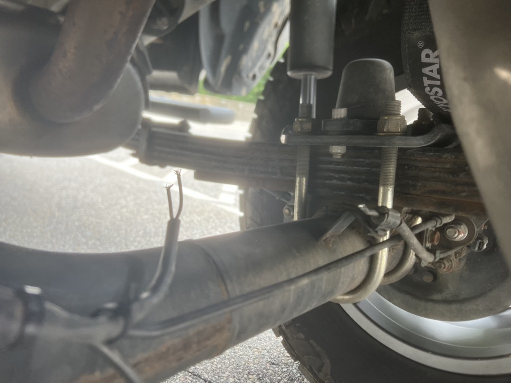

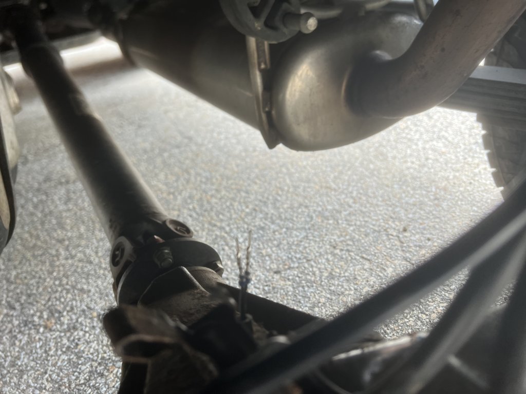

    Awesome thread! Been looking at it a while and finally went LT. loving it so far except…..
    Hit some trails last weekend and my rear ABS wires somehow got ripped out. Like in an odd way can’t find or point to any obstacle or branch. Just the dash lighting up.
    inspected to find wires ripped out at oem connection at bed, snapped about 12 in down the wire and ripped out by sensor on passenger rear tire. Nuts.
    Thinking they may have flexed out or something. Still odd to me.
    That said I had a really great shop set me up with the archive garage ultimate rear and I know there was thought put into re routing the wires a bit.
    Shop is being awesome about fixing this too and standing behind their work, etc. but i am just trying to get as much info here that my help and very much appreciate any thoughts and ideas.
    been reading here for the issue and don’t see too much of it and don’t see a lot on extending them.
    saw one person able to use good solder etc but also reading a lot about the voltage and resistance being pretty temperamental when trying to splice etc.
    Again would appreciate thoughts and ideas.
    how are folks re running oem wires? Should this not be an issue?
    2017 3rd gen. I am running 12 in of travel on 35s. (I also know that may not be super long travel for this crew / thread but for me it’s my daily and long to me. Hahah. )
    really appreciate it.
    some pics post zip tie on trail
    Thank you !

    I cut all of my wiring harnesses from the cab back when I chopped the bed off. Re-ran the rear ABS wires without a care in the world for how short or long they were. Put a new plug at the cut, no solder, which introduces more resistance to the circuit than a solder joint...No issues.
