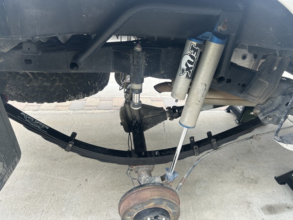

    If I’d like to pull a single leaf from my rear springs, should I go with the largest/longest just below the main leaf, or start with the bottom/shortest?
    my goal is a little less ride height if I can, but mainly I think the spring rate is ramping up when I get close to bottoming the suspension. Rear bumps almost never get fully compressed, and I know they should — as I had full bump travel with some other springs in the past, with all the same components and setup.
    My thought is the bottom small leaf, as this is the one that’s used when the pack is compressed. It probably won’t lower ride height any however.
    8 leaves total.

    I think your leaves are on the wrong side of the axle

    They are. But that’s another money problem.
    SOA leaves still.

    Hahaha I know I’m just messing around.
    just remove the third leaf from the top and see how it sits. Good news is you can always go back to what you had before.

    If you remove a long leaf you will make it very soft and drop it alot. Did it with my icon rxts. Removed the very bottom leaf for height, wasn't enough so I removed a long leaf near the top. Constantly on the bumps then.

    Longer leaf will drip more ride height but be softer, shorter leaves aren’t as in play until bottomed out.
    all good haha, but you aren’t wrong !
    Housing required 110% of my funds recently, so I won’t have the cash to go SUA or preferably cage and links for a bit.
