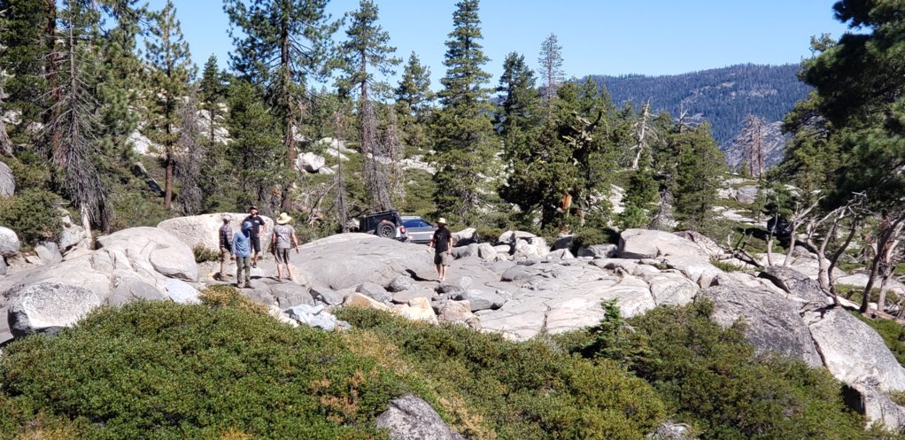

    We have plenty of footage that will be posted just because the driver was kinda douchy.
    The Jeep winching it out when it was Turtled..
