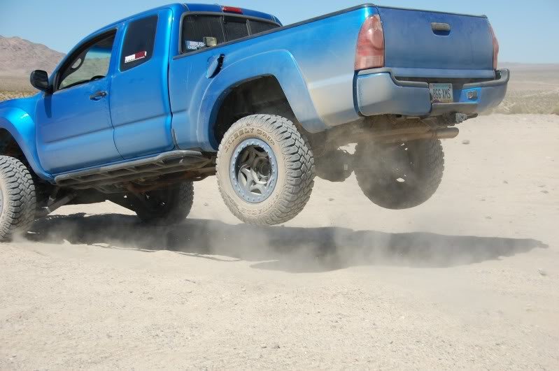

    With those springs in the second pic if he had a soa set up the wheels would be on the ground planted...
    This isn't a good way to explain soa vs sua. Because one is stock springs and one is a 50t pack.
    Sua helps keep the center of gravity low because lt springs has so much of an arch in them. If you went soa with lt springs your ass end would be sky high and c.o.g would be high. Also sua helps control axle wrap. Plus it reduces the angle on your driveshaft u joint when you catch air.

    How about this approach?
    Given the same ride height...
    . the spring over axle has around 4" of compression before hitting the bumpstops
    . the spring under axle has 8"-10" of compression before hitting the bumpstops
    The reason for this is two-fold. The SUA uses a longer leaf pack with much more arch, which allows for more travel. In addition to this, by moving the leaf pack under the axle, the space previously occupied by the leaf pack is now free to be used for compression travel.
    It's possible to get the same travel from a spring over axle configuration but the truck will be lifted to the sky to compensate for the space taken up by the leaf pack.
