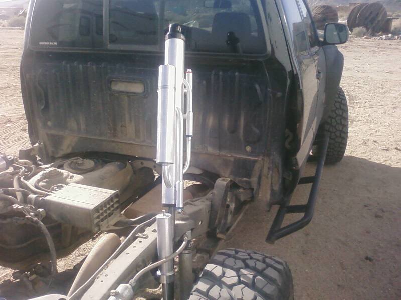

    Your rear shocks are mounted between the frame rails, right? I'm running 3" 4-tube bypasses outside the frame and clearance is a nightmare. My current wheel spacers are stupidly wide and the new axle I have on order has a WMS-to-WMS distance of 73" to clear everything.

    3" spacers and I still rub when the suspension articulates. I'm running pretty wide tires, but still. Makes it look like my truck was designed by Harry's House of Can't Measure.

    It clears the frame fine. The tire rubs when things get really flexy.
    To bring things in I'd basically have to have the shocks run through the center of the frame. Those shocks are just massive.
    Here's a pic of a mangled 2" WE coilover, 2.5" 8" travel bypass, and the 3.0" 18" travel bypass.
